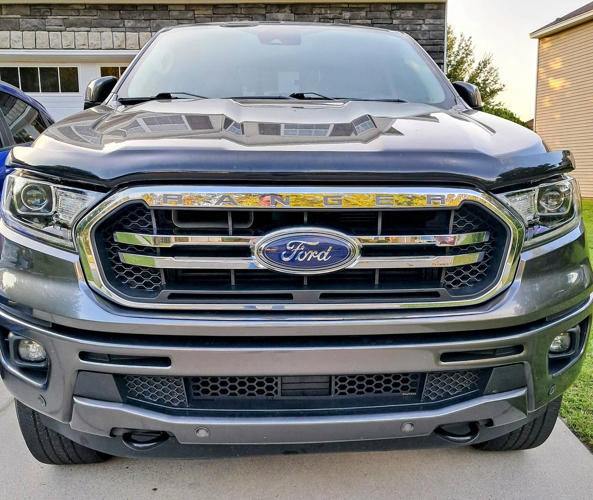

While it doesn't seem to provide a significant performance boost by itself I will say this is a handsome upgrade. (Bumping for thread visibility) - I appreciate the lack of logo in these pics. I think that clutters the look (Mishimoto comes to mind) if it's potentially a couple hundred bucks lower it's a winner!
