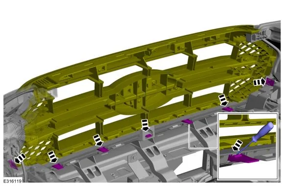

I've been told there is a good chance I'll break the tabs on the headlights while removing the screws from the stock intercooler. Are the screws that tight? Anything I can do to avoid this?
What are my options if the tabs do break?
(?) The headlamp assemblies are not even touched
I believe you are referring to these tabs - very brittle and easy to break
I suggest watching one of the Headlamp (swap) videos they cover how to remove the parts needed for access, just use it as a reference to gain access to the inner cooler.
Theses tabs are integrated with the grille.
According to the Mountune instructions you take off the driver side headlight.
Step 3 says to remove the two bolts holding the top of the grill to the headlights.
The attached file is directly from their website.
Shouldn't be any need to remove it, i mean you're welcome to but i don't think it benefits you at all. Other kits don't call for that.
