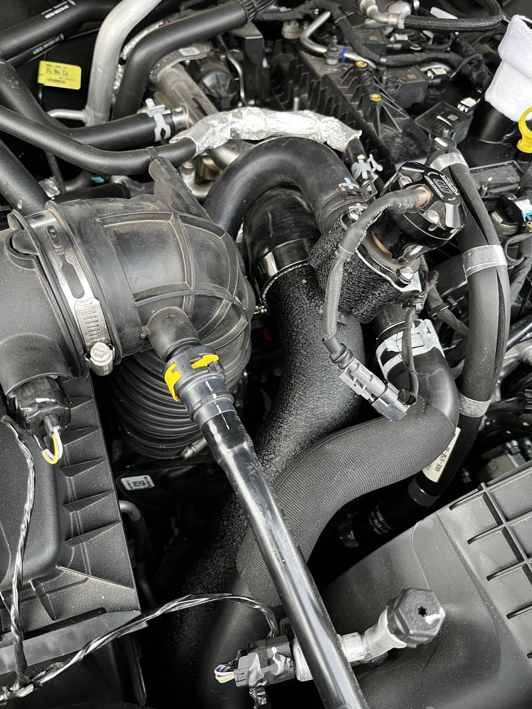

CVF Aluminum Intercooler Hot-side + Cold-side Piping Kit Installed

Well after a few days of driving, this may be my favorite mod so far. Truck seems to respond better at low speed and you get a nice whistle and hiss at high rpm with the BOV. 10/10 recommend.

quick trip to the store with the wife. Only got up to 40mph so no BOV noise. Idk if its a placebo but the truck felt better at low speed and high gear. Not as luggy?

That came with the kit, more specifically for the cool side. I am not sure if the others that installed had the same issue with that aluminum piece needing to be sanded a little. I took a little off at a time until it took a little force to push in. It could have been my inexperience with things though. I have had zero issue with things so far.

IMO you shouldn't need to loosen the intercooler. With the couplers in place first it gives you that give you need to slide things in. One thing I did not mention is that I used a tiny bit of olive oil on the rubber gaskets that go inside of each pipe that seal around the intercooler. I was worried those might rip or stretch if I put a weird angle of pressure on them. Probably might of not been needed but worked for me.

I did not need to sand that aluminum plug. Mine fit right out of the box.
