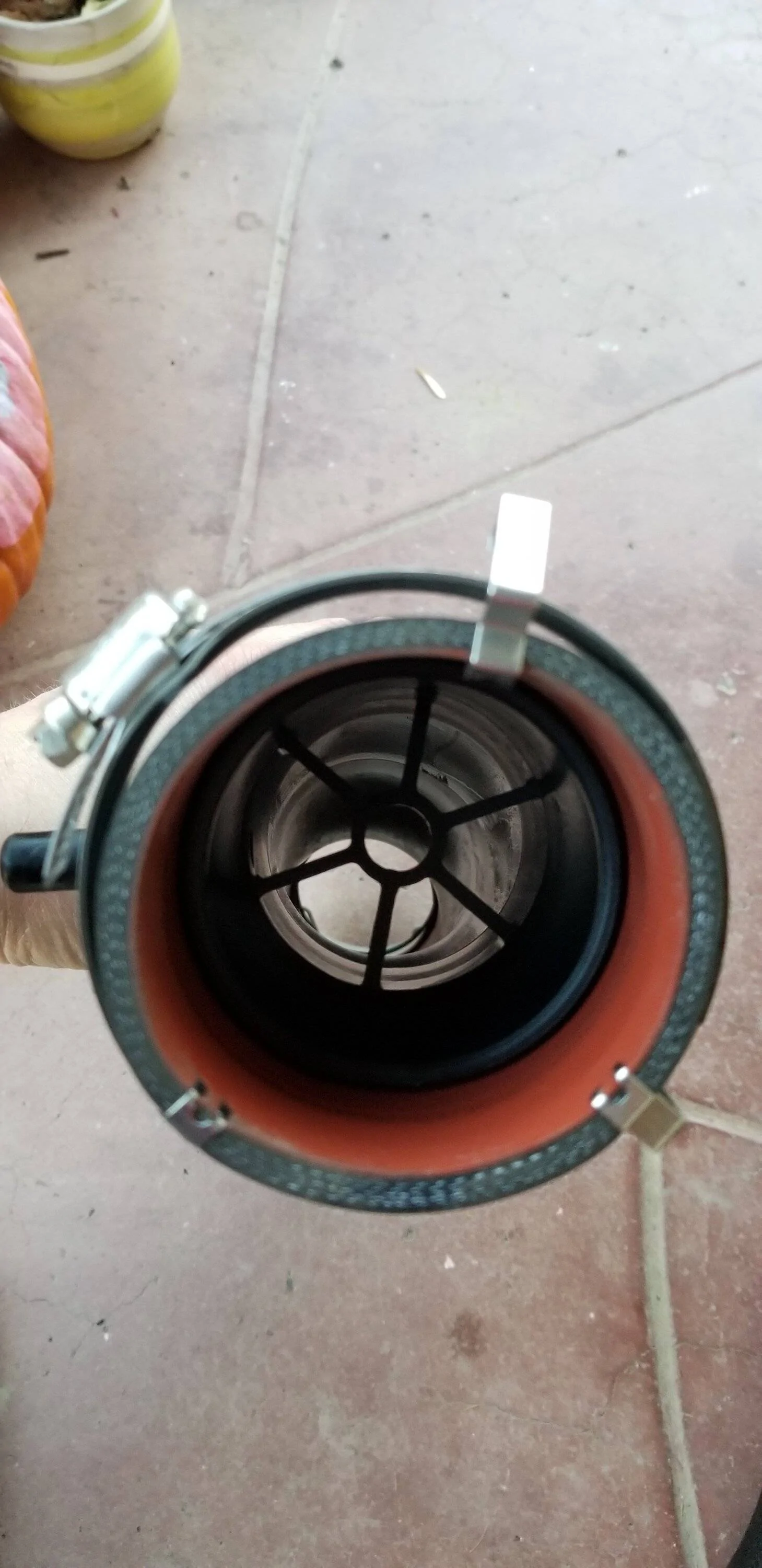

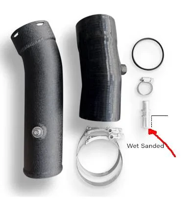

Got my kit, looked at your pics. The 2 real thin large O rings, where do these go?

Sorry for the late response. Those go inside the hot/cold pipes that connect to your intercooler. Be careful not to rip those when putting them on. I used a super tiny bit of olive oil to help things slide around a little. Probably wasnt needed but worked for me.

Thanks I kind of thought that’s where they go.

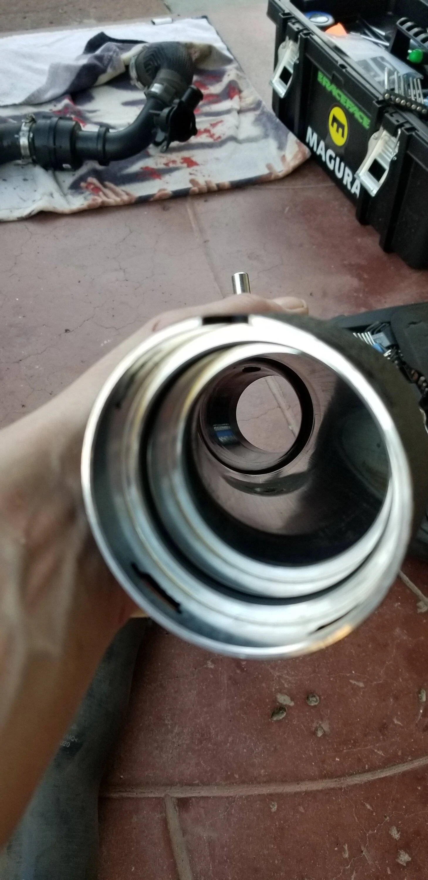

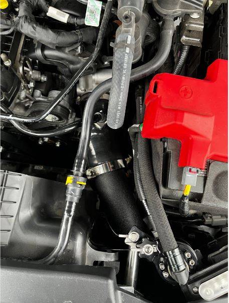

Any chance anyone could take a pic of the CVF hot side pipe at the IC? it has to be a stock IC.
I got the hot and cold kit, I did a initial fit up of the pipe without the couplers on it and it's a odd fit, almost like it may have been a little off when it was welded up.
I know it's buried and hard to see, much less get a pic of, I'm just trying to see how far it is from the seam in the pipe to the coupler or the adapter.
Anyways, thanks if anyone has the time!
Sorry for the late response, I just saw your photos and mine was not that close. I dont have the truck with me right now (at work) but I will try to get a photo if I can.
