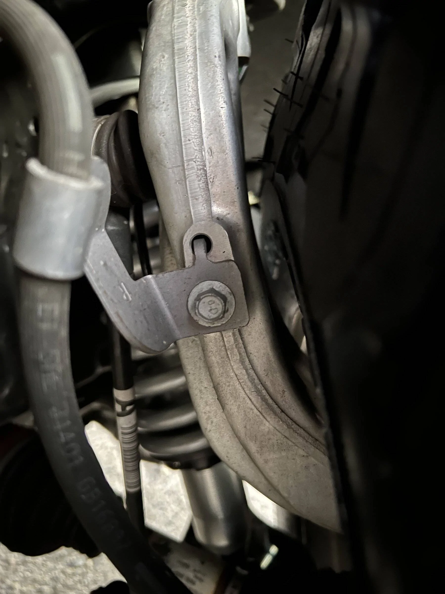

Well they are on now. It’s true there is about the tip of my finger distance between the tire and the uca. I don’t think they’ll flex much freeway but when going off-road and dropping the psi we’ll see what happens.

I’ve been following all the threads here and came to the conclusion with everyone else that 265/70 tires would fit fine and won’t rub even with stock suspension. I came to Costco last week to have them installed and they wouldn’t but said I should get my fox suspension and level done first and then they would do them. Came back today and they said no there’s no way we can fit them on there they’re going to rub against the upper control arms. And I do agree there is very little space between the control arm and the tire now. My Sport came with 255/65 17s.
I’m not sure what to do.
