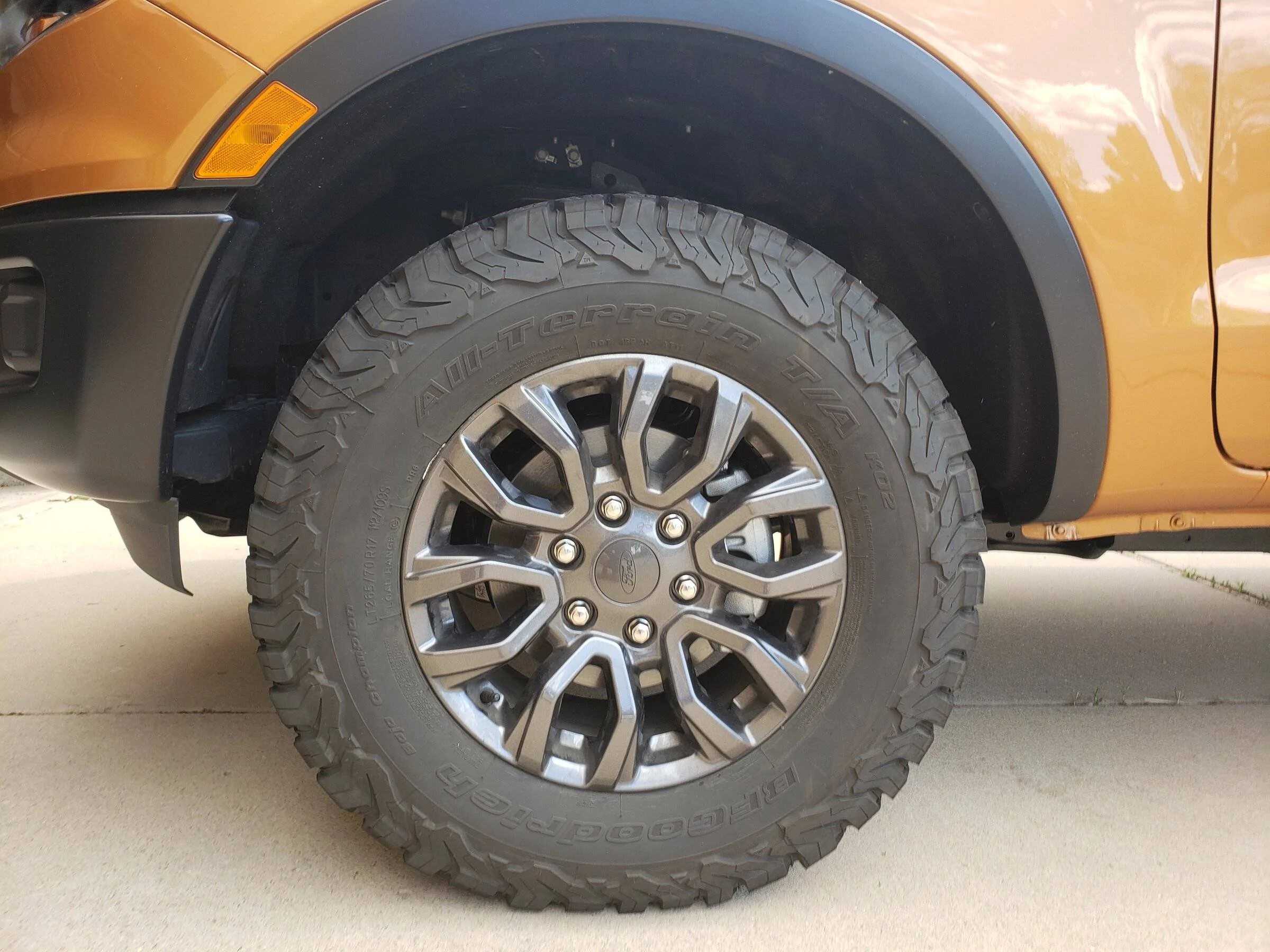

Costco says 265/70R17 will rub and won’t install them. Help.

Looks good, OP!
"Eff" COSTCO and their opinion on fit. I have a set of 265/70-17 Maxxis Razr AT that I took on some minor rock climbing with an OME front lift. Dented the rocker panel behind the front wheel well but, by God, those tires never rubbed anything inside while on the whole trail. (Yes, I now plan on getting rock sliders):curse:

Ben you shouldn't have any problems with that size even when aired down. I've had mine (same size) aired down to 18 psi and have never rubbed. I rotate them every 5000 miles and if you didn't already you should get a larger spare to match.
yes going to find a used one to use as a spare. And glad to hear aired down they still don’t rub!

Factory optional size in 2019-20. 2021 went to 265/65-17.

encoraging to hear, thanks! What pressure do you run them at?
You're welcome. I checked with BFG and a local BFG Dealer and their recommendations for these tires considering the weight of the Ranger were 35-40 cold. I found that 36 is ideal and gives a balanced ride. The KO2's ride and handle better than the factory OEM's on the street. Haven't gotten off-road yet. The KO2's have a high rating for long lasting tread life. Enjoy the KO2's if you decide on them! :thumbsup:
