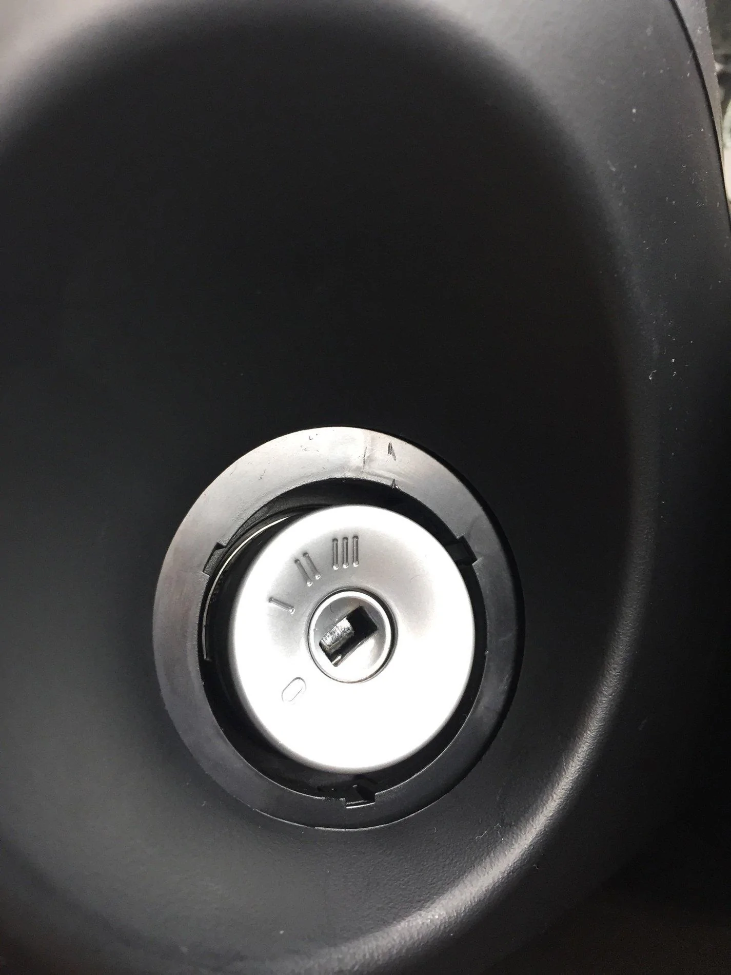

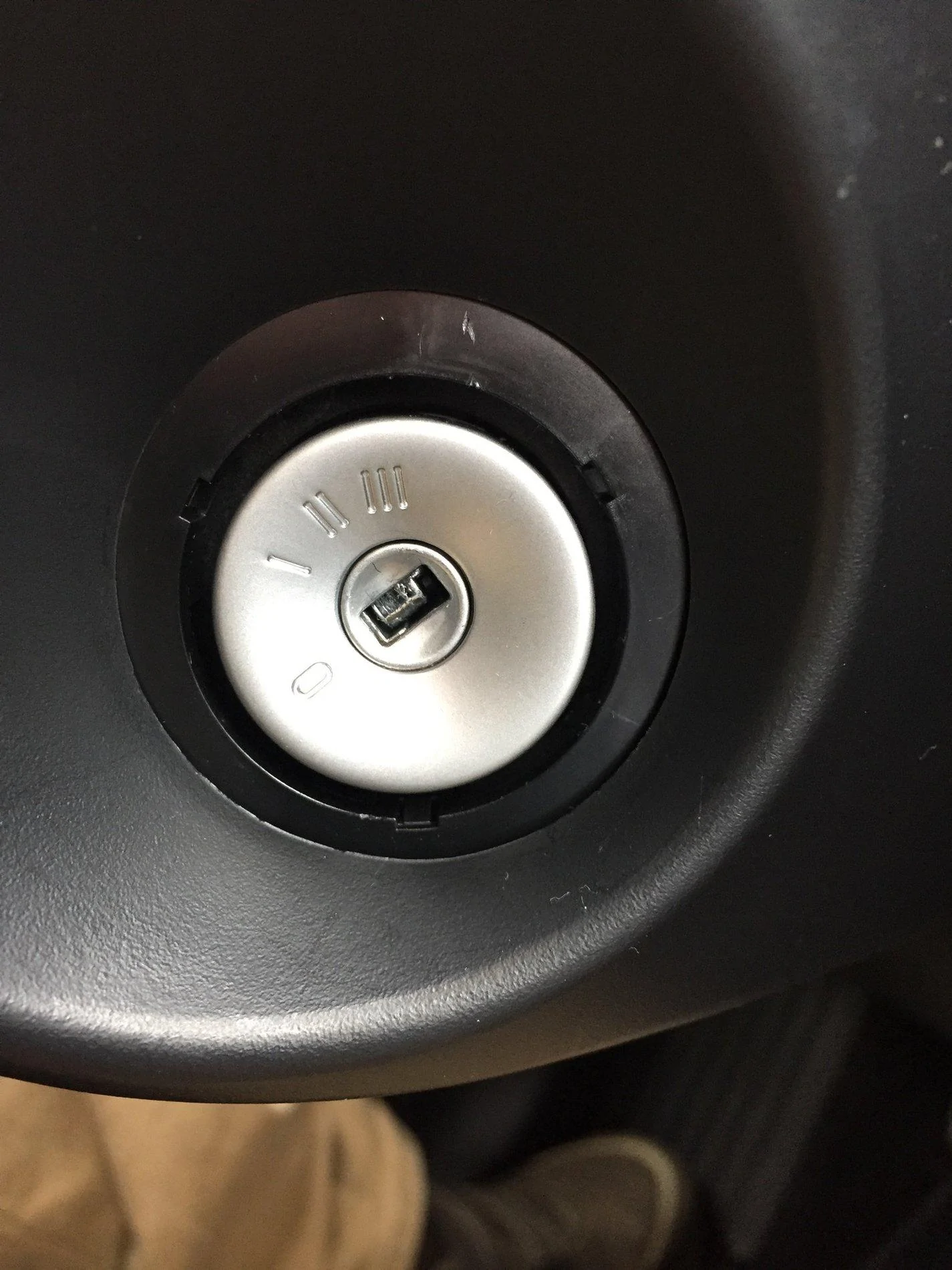

Well I got it to fit not bad for 1$ lol

I took the protective tape off and stuck it on. Not much to it. No force was needed I see the pictures were kinda blury. I will try to replace them tomorow. Is it worth it? To me I guess, it looks beter than nothing there.

Hello everyone, just purchased new ranger crew xlt 4wd sport package. On the ignition switch there seems to be missing a piece of trim around the key hole? Noticed it after having truck 3 days, called dealer, said bring it in so I did. They told me that that’s the way it’s supposed to be. They only had 2 more rangers on lot and they were lariats with push button start. Can anyone with xlt tell me if their truck is like this also? Go a try loading some pics. Thanks
As someone who used to work within Ford's product design, I can tell with good certainty that a finish bezel was meant to be there due to (1), there are 3 visible locking tabs for a trim piece of some type and (2), the flat mating surface was left ungrained on A surface (surface visible to eye). No car company would ever leave any interior A surfaces ungrained unless it is to be covered, painted or plated, but never raw. Cost cutting or oversight? Regardless, this is very poor presentation for critical touch points on a "new" vehicle. Maybe they're too busy working on the next gen Ranger which is due out sometime in late 20-21.
As someone who works on Fords competition, you sir are spot on. I've removed hundreds of those bezels and seen the exact 3 snap in points. Even my 19 y/o truck has a glow ring around the key cylinder.
