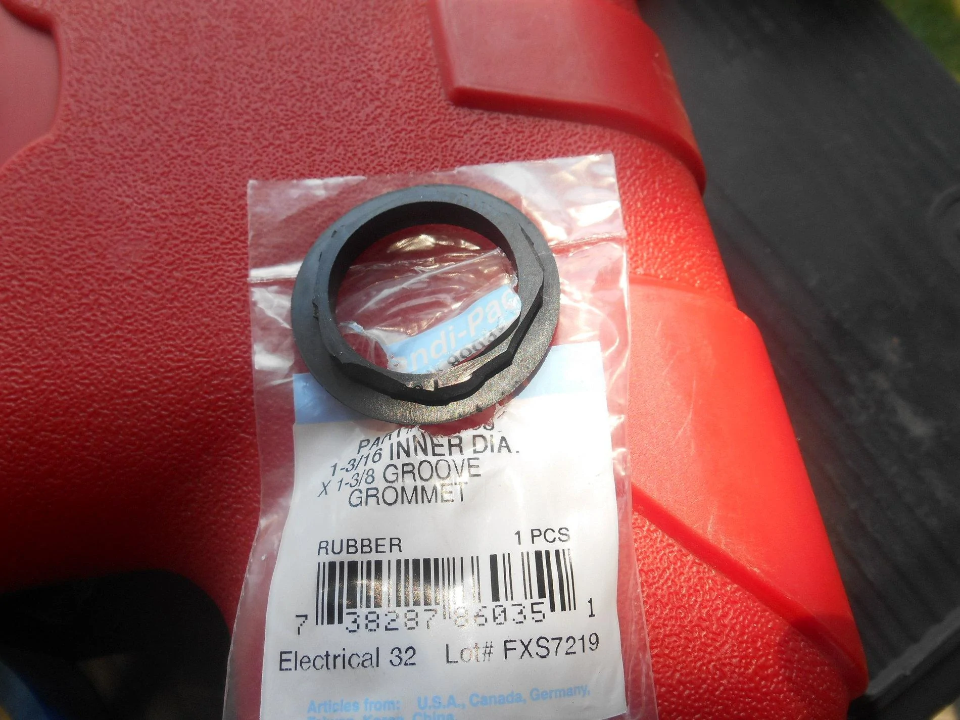

I had some 30mm id x 32mm groove diameter x 44.5mm od grommets & they work well. Just trim off the one side & push in. The ignition is just under 30mm so there is still a little wiggle but it's much better now & blends in well with the other rubber tipped items. Big thanks to retire003 for the idea!
Yours looks really good. Thanks for posting the measurements. It will help me if/when I need to replace mine.

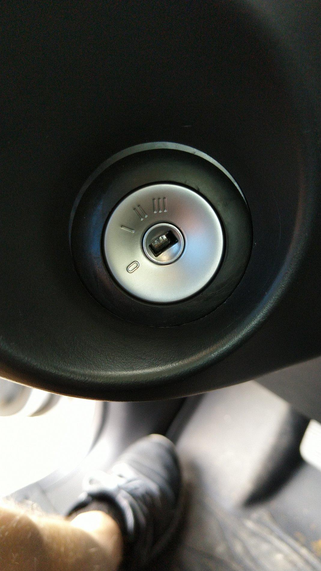

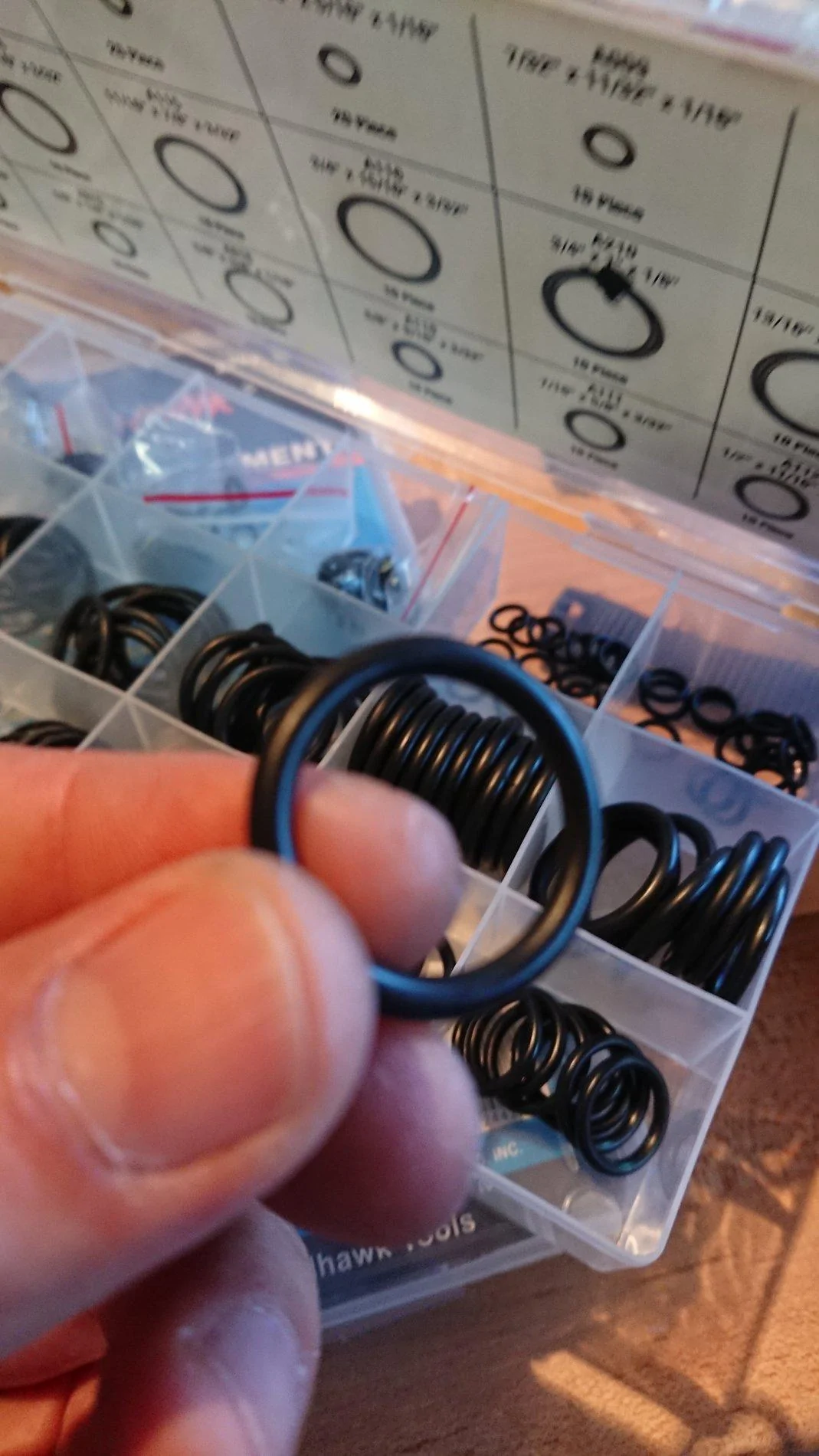

Hey guys,
I had some o-rings assortment from Harbor Freight.
Got some soap, slipped on a couple over the ignition. Got rid of a significant amount of the wiggle and looks clean. You can easily remove it with a hooked pick if desired.
total cost: .10?
time: 2 mins

Lol, yeah....it bugs me but looks much better than an unfinished hole
Agree but also the main reason I went this route was to eliminate the wiggle. Feels much more secure when inserting the key.
