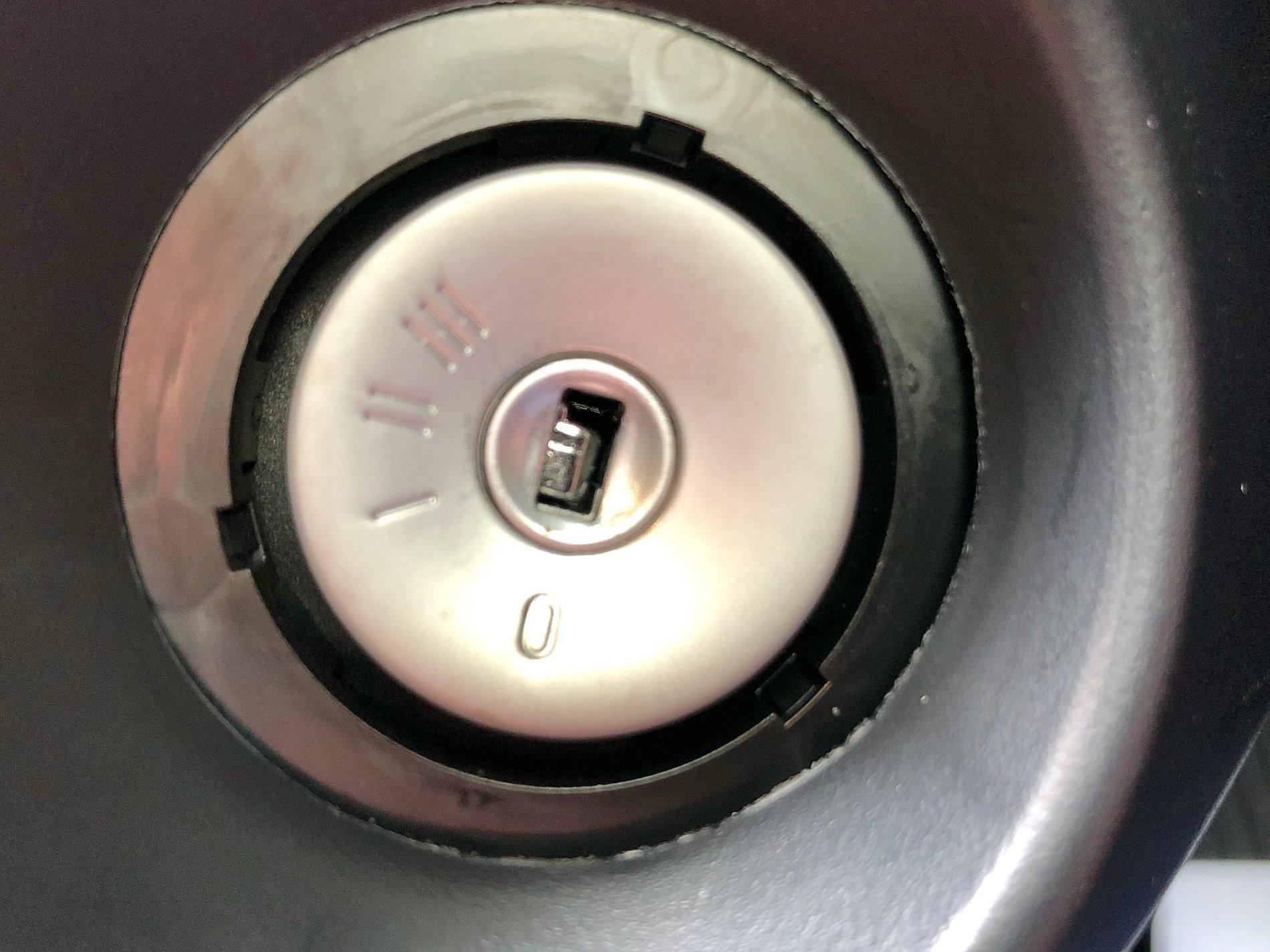

I grew tired of the loose feel of the key in the ignition. Couldn’t find a Ford part number so I bought a $2 rubber grommet and cut it in half. Not the prettiest but has stabilized the switch

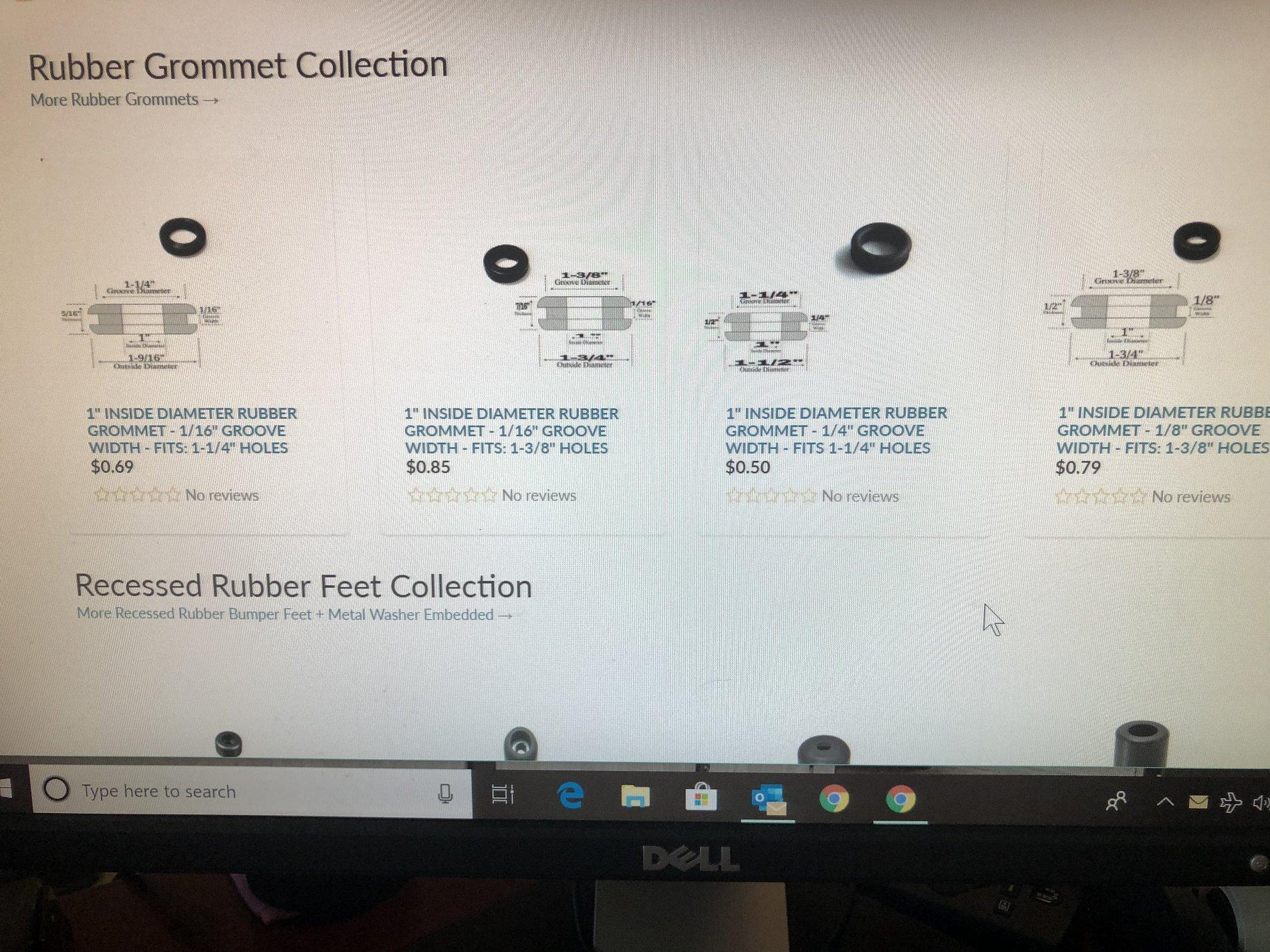

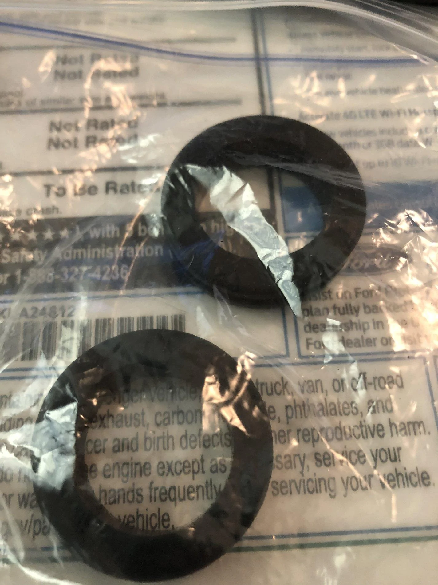

Sorry for the delay just got back from trip last week. I could not find the invoice information for my order. I don’t have the specific size I ending up using but here is the info:
I ordered from www.rubberfeetwarehouse.com
I ordered the 4 different sizes as in the attached picture. The grommets came in 4 separate unmarked bags as seen in the 2nd pic. The were pretty cheap so I ordered several to make sure one fit.

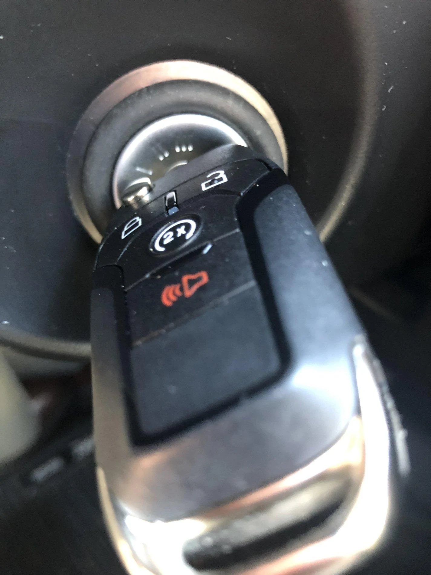

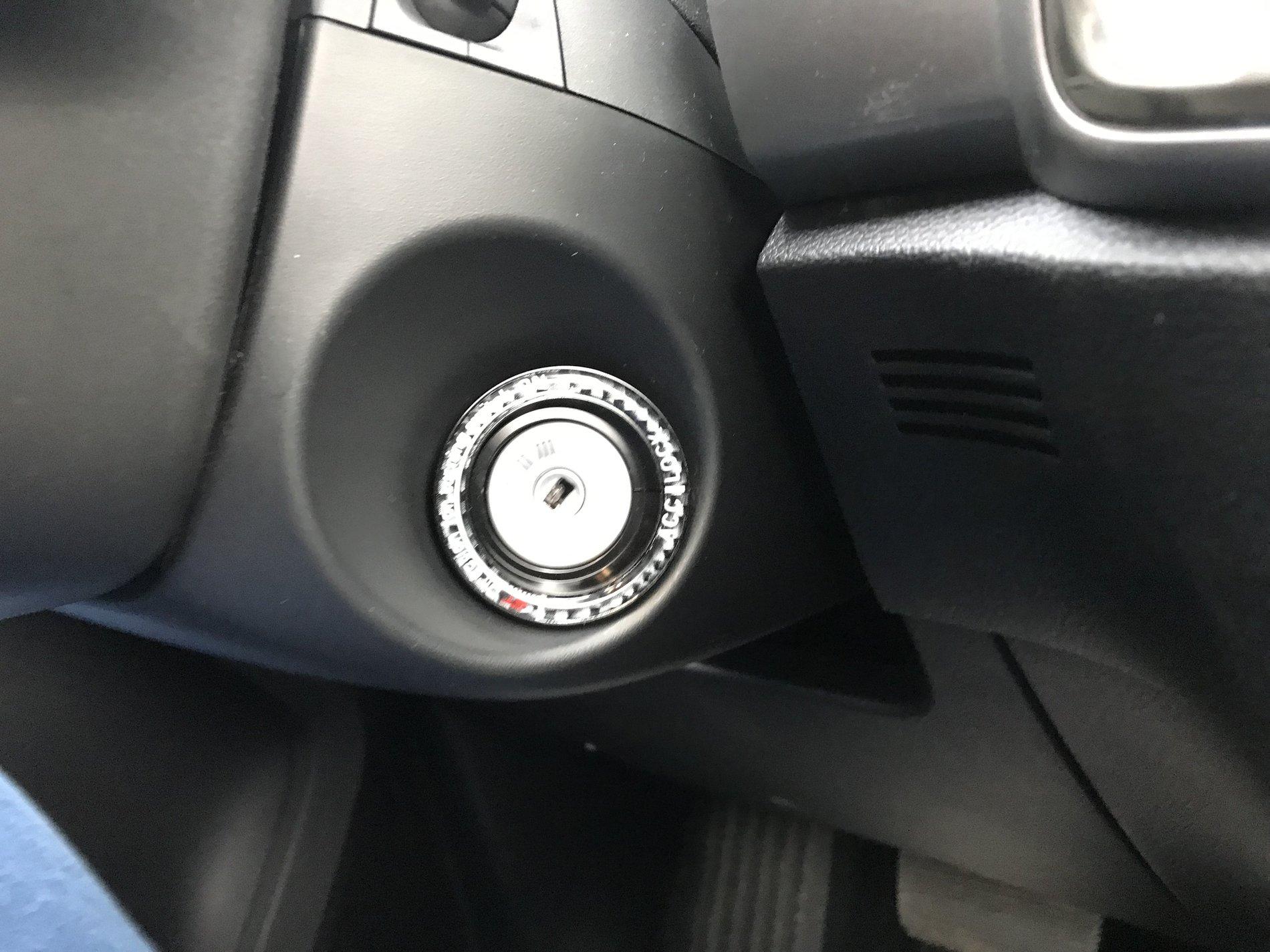

Good luck. Sorry I couldn’t give exact size. So far no issues and it stays snug. Here is pic with key in.

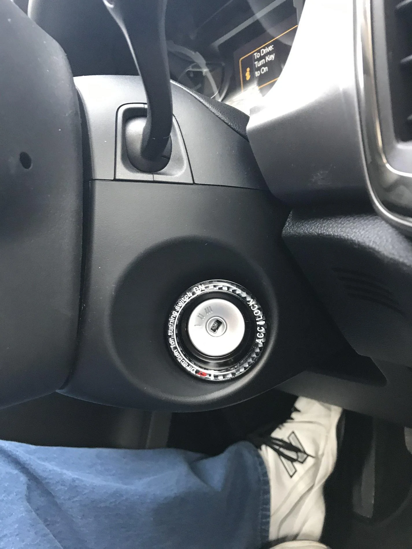

Me too, sorry for the crap photo but it actually looks pretty good.
