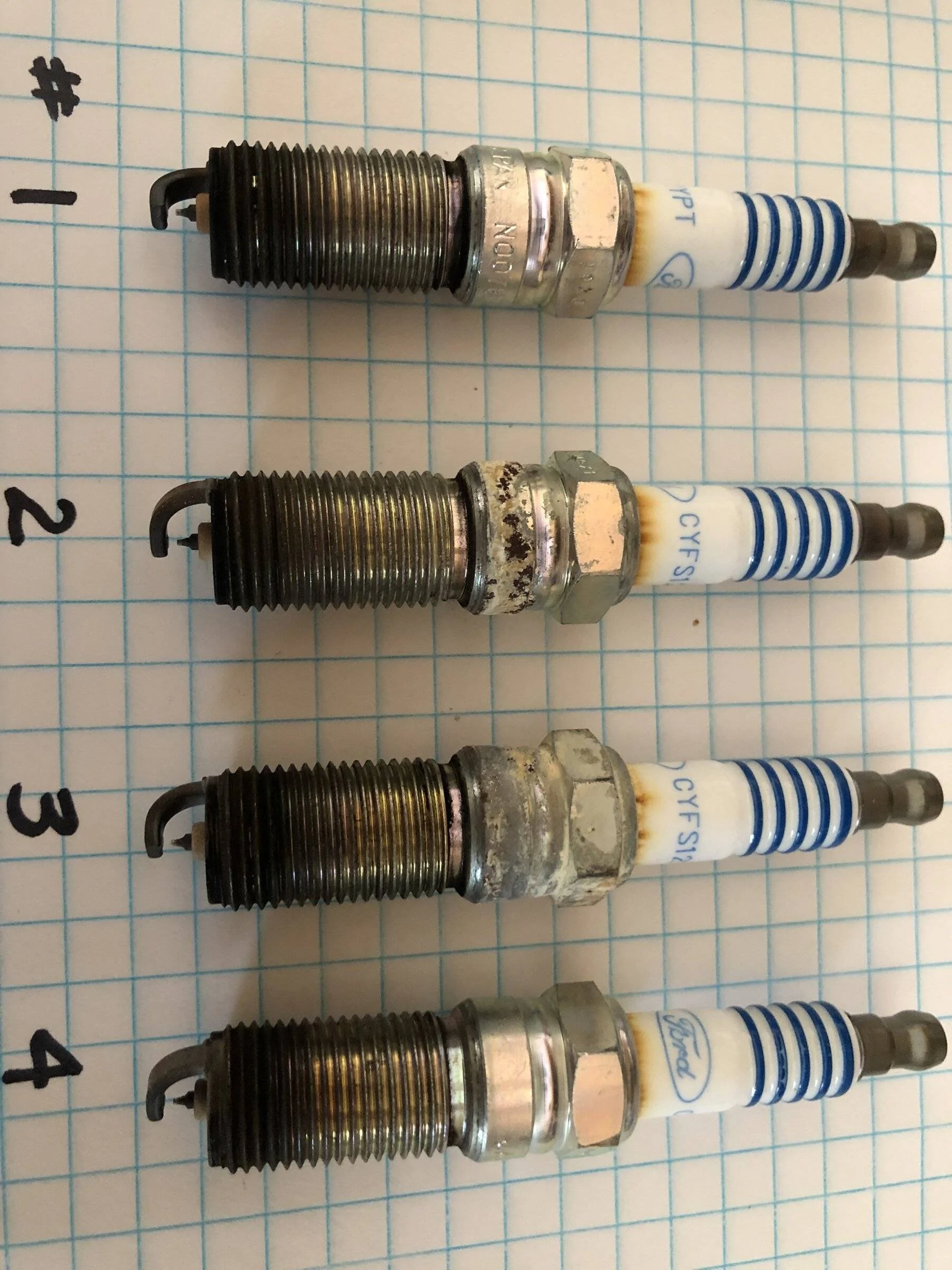

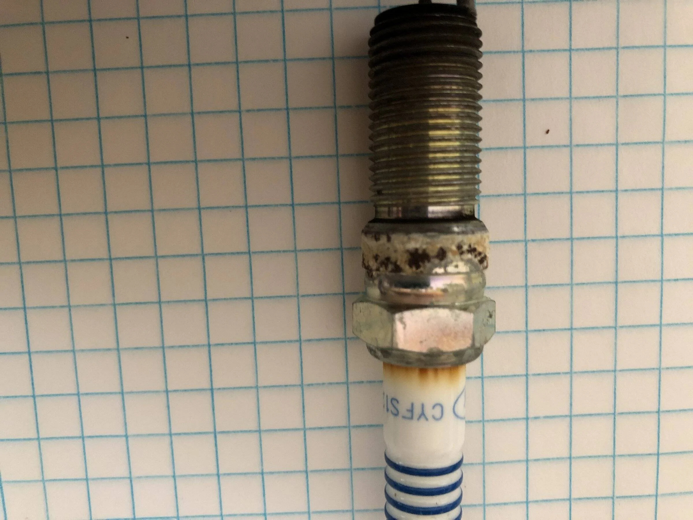

In my case I drove through a heavy rainstorm at highway speeds. The seals on 2 of the coil pack assembles did not keep the water out. These pictures show the result of corrosion after about 1 week after the water incursion. I was out of town and did not have my tools with me, so changing coil packs and plugs had to wait until I got home.
