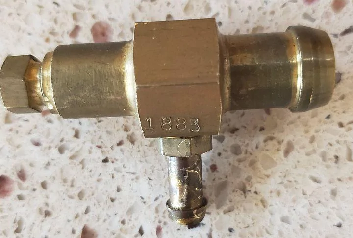

This was in reference to the Aerostar that Dick planted in the the basement wall... As for our boosted Ranger, I believe you are correct that there is a vacuum pump. The old SVO 2.3 trubo Mustang used a venturi in a boost bleed line...a very unusual way to get vacuum...here is a picture of one...
