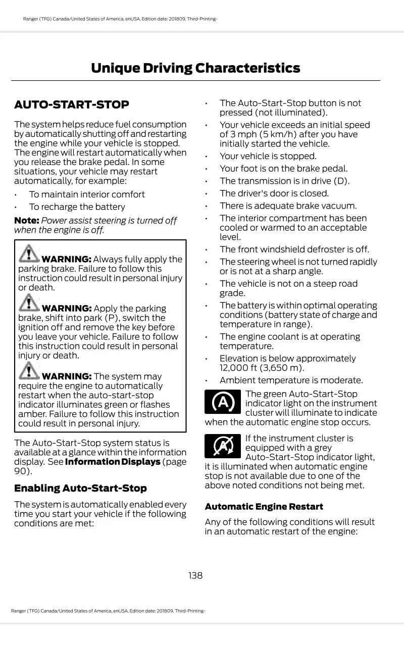

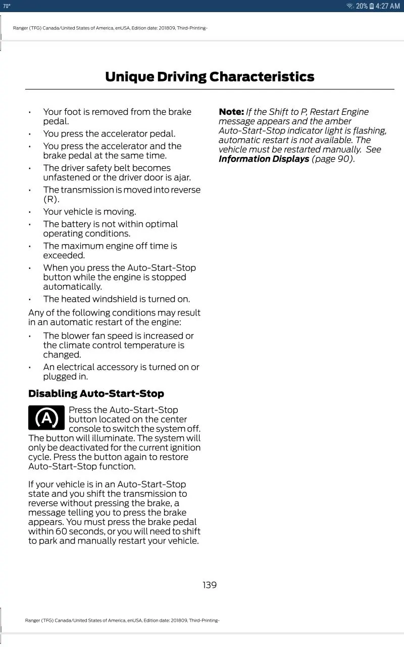

Just experimenting trying to figure out the situation.
So you put it in sport
The button lit up
You pushed the button and the light went out
When you would come to a stop your engine kept running?
Doc
Doc
Dec 24, 2018
94
5,843
23,541
Live oak fla
The button lit up
Yes, I had the air on that may have something to do with it,
Regards
THLONE
Thom
Feb 12, 2019
1,456
2,180
Tucson,AZ
internet wise guy
Ways to stop the A.S.S.
1- push the button.
2- buy a thing for $100 + $100 labor install.
3- plug in a trailer
4- plug in a trailer tester .
5- run ac fan fast.
6- plug in a light in 110 plug if available.
7- drive in sport.
8- turn steering wheel when stopping.
9- use a very light touch on brakes when stopped.
10- any more?
