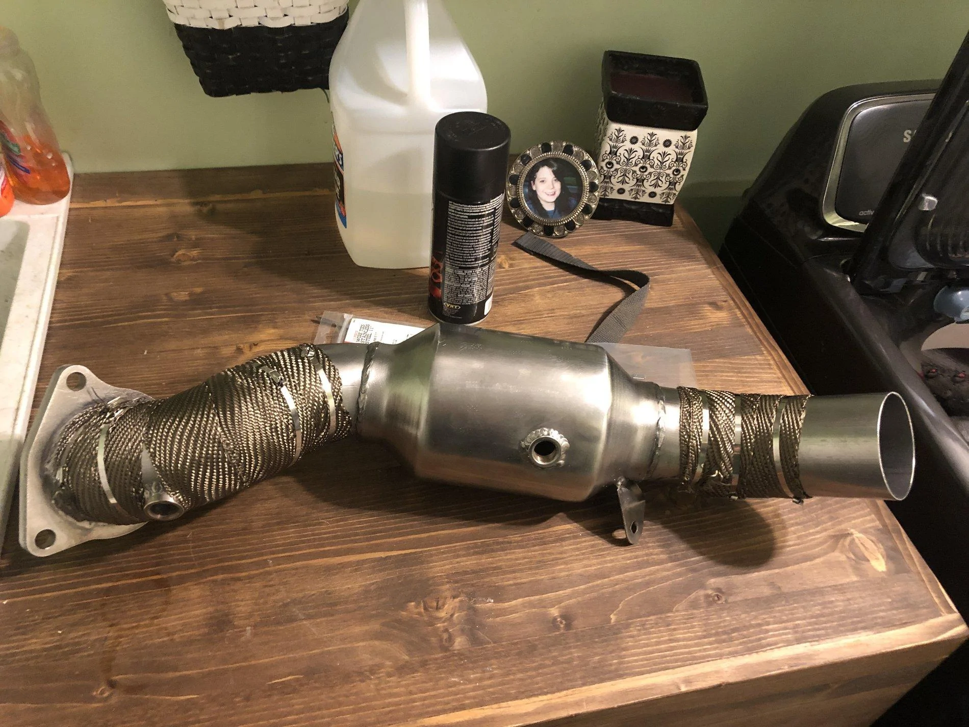

I opted for the SPD stainless as soon as it was released. The main reason is because it appears to me that the AFE drops down to 2 1/2” after the cat and requires a flange to bring it back up to 3”. The SPD on the other hand is all 3” and requires a flange to drop down to 2 1/2”. I obviously wanted little to no restriction going into my 3” exhaust.
Thank you for sharing! That looks to be a very well made item and I under what you are saying about the diameter. I need to verify the Borla exhaust diameter and go from there. Either way, this one covers both and it appears to have a smooth flow.
I am thinking similarly and plan to go with SPD for the 3” outlet. I am also considering pairing with the SPD 3” exhaust sustem that matches up with the downpipe. I also noticed the exhaust system has a resonator which I hope will help with the noise level. Ultimately I want the power from these parts, but am not overly interested in a sound increase. Any suggestions for the most power at a reasonable noise level?

OK, pay attention if you order. I meant to order the one I could clamp on and accidentally ordered the one that is for welding. Knucklehead move there. Anyway, I still clamped it, but had to cut notches into the pipe-ends of the resonator to allow it to compress with the clamps. See https://www.borla.com/products/universal-resonators/ Then you want part # 401338 to weld on or part number 401342 to clamp on. Put it on the pipe between the downpipe and the catback.
The second picture shows how much of the pipe I cut out. I can't remember what the measurement was, but it should be at least the length of the larger resonator section but less than the total length of the whole unit. You need some of the pipe left to clamp on or weld to.
It is a pretty quick job. It just cuts the edge off the sound a bit without sacrificing the power. I called Borla before I put this on and they said it would not affect the power and that you can put as many of those on as you want.
I started with one and it has worked for me. However, I did just install the CR Performance turbo upgrade and it is a bit louder again now. Maybe I will get another. But I'll wait a bit. Note that you want the 2.75 inch to work with the factory pipe. If you want to go with 3 inch, you will need to change the connection to the downpipe.
Let me know if you have any more questions or want a better picture.
Thanks for the info and pictures. Much appreciated! Any reason you chose to install in that location? Im considering installing right in front of the borla muffler for possibly an easier installation...one less cut. Im not sure if that would work yet though...enough space, etc.
