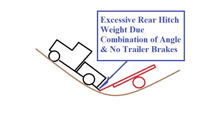

Not a rear end collision, excessive weight on the rear hitch. Hence, the Colorado was overloaded.
Maybe , but IMO more likely impact on the hitch as shown in your drawing.
More a result of dynamics than weight.
Either way your drawing shows the likely cause, especially when excessive speed is factored in.
Notice I said "more akin"

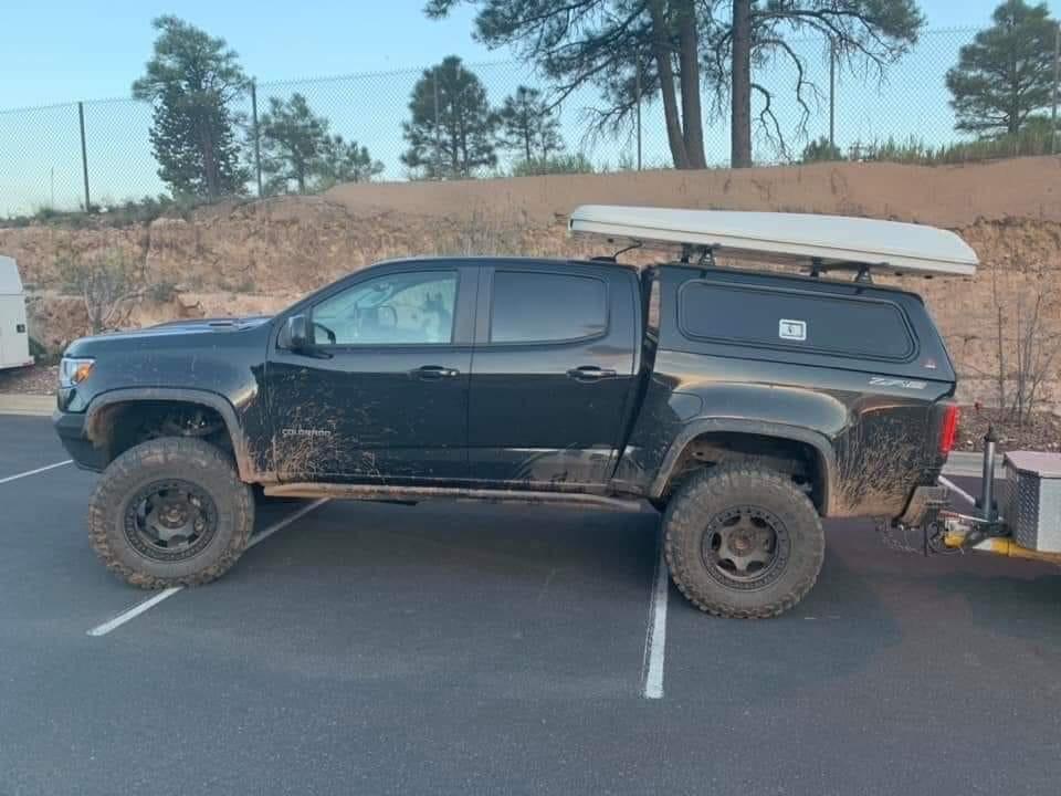

The problem is that the guy in the truck is not likely to be on the brakes at that point. He will only be on the brakes when both the truck and the trailer are going down hill. So the investigator's statement of the trailer lacking brakes was not a factor. If he had taken it to court he could have proven this to a jury.
What failed here is a dynamic loading of tongue weight and a limited safety factor built into it.
BTW, I've now seen a total of 3 Colorados bent like that. They have a problem. I've never seen a Ranger (old or new) or a Tacoma bent like that.
Out of curiosity, do you have information on the other two Colorado's? I'm on a Colorado site as well (there's a 2017 Z71 parked beside the Ranger) and have only ever seen that one zr2 with the bent frame.
I just remember from nosing around when I was looking at trucks. I'm pretty sure I saw the one that was in this thread, this one I attached, and another one that was red I think. My search was something like "Chevy Colorado Problems" then google images.
Probably the only 3 bent Colorados in the world, but you can't unsee that stuff and not think of it, hahah.
