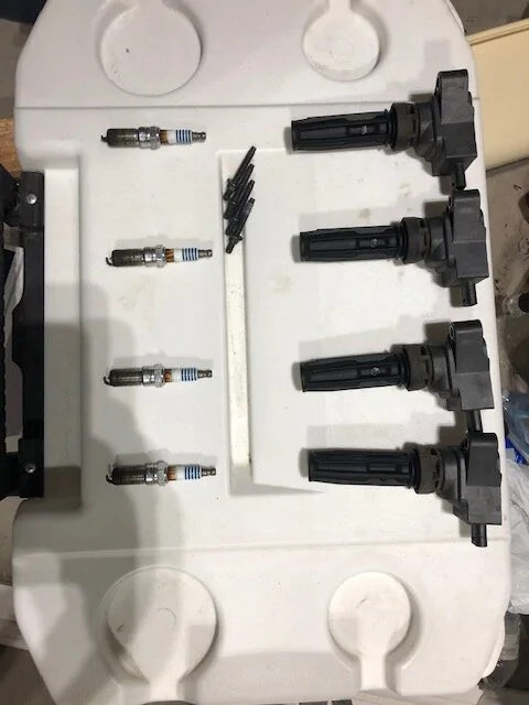

Update: Plug change went great, so easy! No problem getting that rear plug out with a rotate of the coil. Plugs looked great and the boots still look brand new after 34K. Can't wait to see how my Blackstone Analysis looks....should get that back soon.

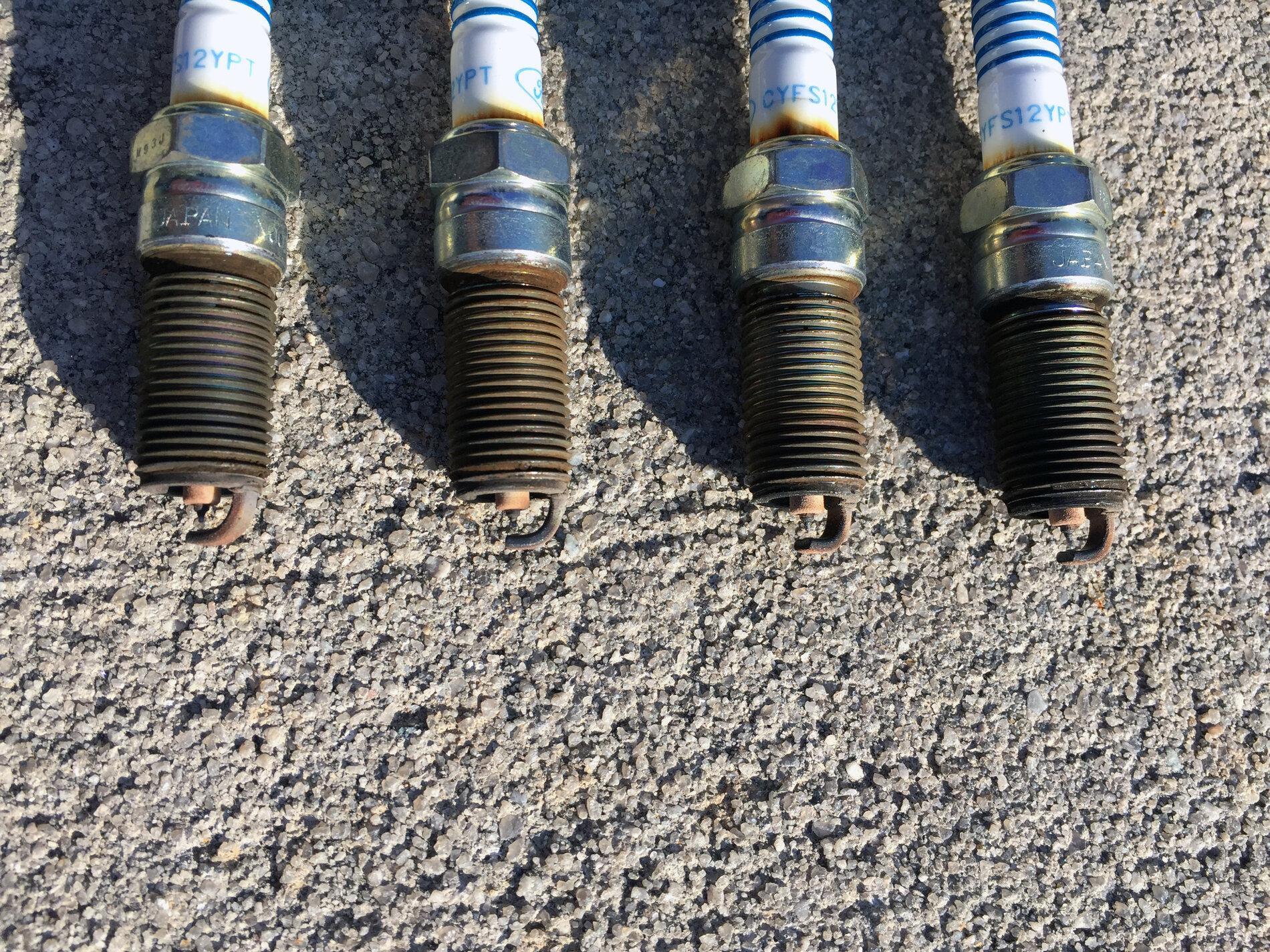

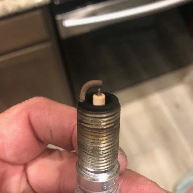

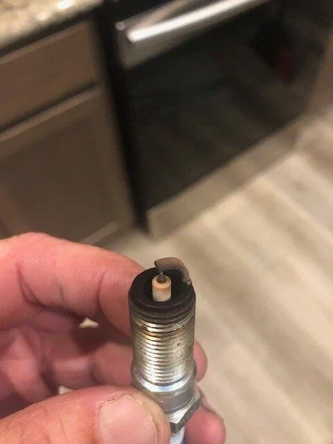

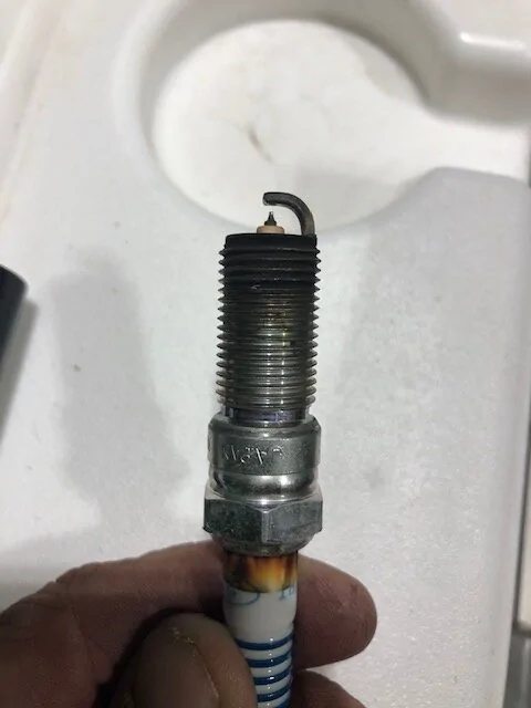

So this morning Papaw must take the walk of shame when analyzing the state of my old spark plugs after 34K. Overall the plugs look good, the problem is the significant carbon buildup. IMO...this is directly correlated to the fact the for the first 10K miles I was going back and forth between 85 and 87 octane fuel. This was completely out of ignorance I assure you. No one pointed out to me that I should run a minimum 87 octane. Matter of fact, once I installed the catch can and saw the first capture of gunk I never put anything but 91 in after that. I now get a very refined maple syrup looking liquid with each capture. Sadly I'm sure I caused some buildup in my motor. We will see over time how that plays out with performance. She is running very, very smooth. I pushed her pretty good last night during my shake down run after installing new FactionFab wheel spacers. The engine seems to really like the new plugs! I continue to get crazy reactions on the street when encountering performance vehicles on a Friday night....lol ;) Gonna get me a sticker of "Sleepy" from the seven dwarfs to put on my back window :clap::turkey:

Those plugs are not carbon fouled, not even a little.

Plugs look fine to me...

Some of the key reads are the center electrode porcelain insulator color. If stark white...way too lean, blackish...too rich. Yours looks fine. Look at the edges of the tip of the center electrode...edges rounded? Not good...nice and square...good!. Dito for the ground lug... The black around the base is not of sufficient caking to indicate any problem...not clean but no biggie. If you used a magnifier look at the base of the center electrode at the porcelain insulator...see and little silver balls? Then this is your piston eroding due to inappropriate mixture....not the case based on your plugs. Others may offer up opinions, but your neighbor is correct...run a touch rich is better than a touch lean... JMO!
