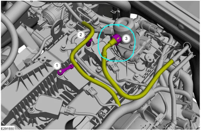

So anyone that has actually changed plugs in the 2019 Ranger.....how do you disconnect the low pressure fuel line? TIA

How did you disconnect the low pressure fuel line to get to the farthest to the rear plug?
I didn't recall having to move any lines to get to the back plug...can you post a pic?
Sid this is the best I can do right now till I get home....there is a rigid fuel line directly above the plug closest to the fuel pump in the rear of the engine. I have a great exploded view but no directions on removing that line. I appreciate HossierT telling me to give it a little tug. I just don't want this to be an item they have modified and tugging on it would be bad. It's a simple bell shaped connector with no tabs (exploded view connector has apparent tabs). Just wondering if I need a connector removal tool of some sort? Any feedback is appreciated.

not sure about Ford but for fuel lines many are held with a spring type connector - you generally need a tool that pushes into the connector and thus releases the tension from the spring. It's an inexpensive tool.
Yes that is what I’m curious about. Ford has several connectors like that I’m pretty sure.
IIRC there may be an o ring in that connector that it's recommend to replace on high pressure connections.
It's the low pressure fuel connection. when I figure how to remove it safely I will look for an o-ring.

I ran into this problem too with the low pressure fuel line. Thankfully you don't actually have to take it off even though it says you have to. Glad when I was able to go without because I did not want to deal with fuel on top of my engine and replacing o-rings as others have said, etc. If you are careful you can just barely slip the plug/socket/extension past it. The coil looks like you can't get it out but it it rubbery and bends
That’s absolutely correct and I was not talking about tugging the fuel line connector. I was talking about the clip that’s on top of the bolt holding the coil in. Looks like that’s #2 in your pic above. The coil will slide right past the attached fuel line.
