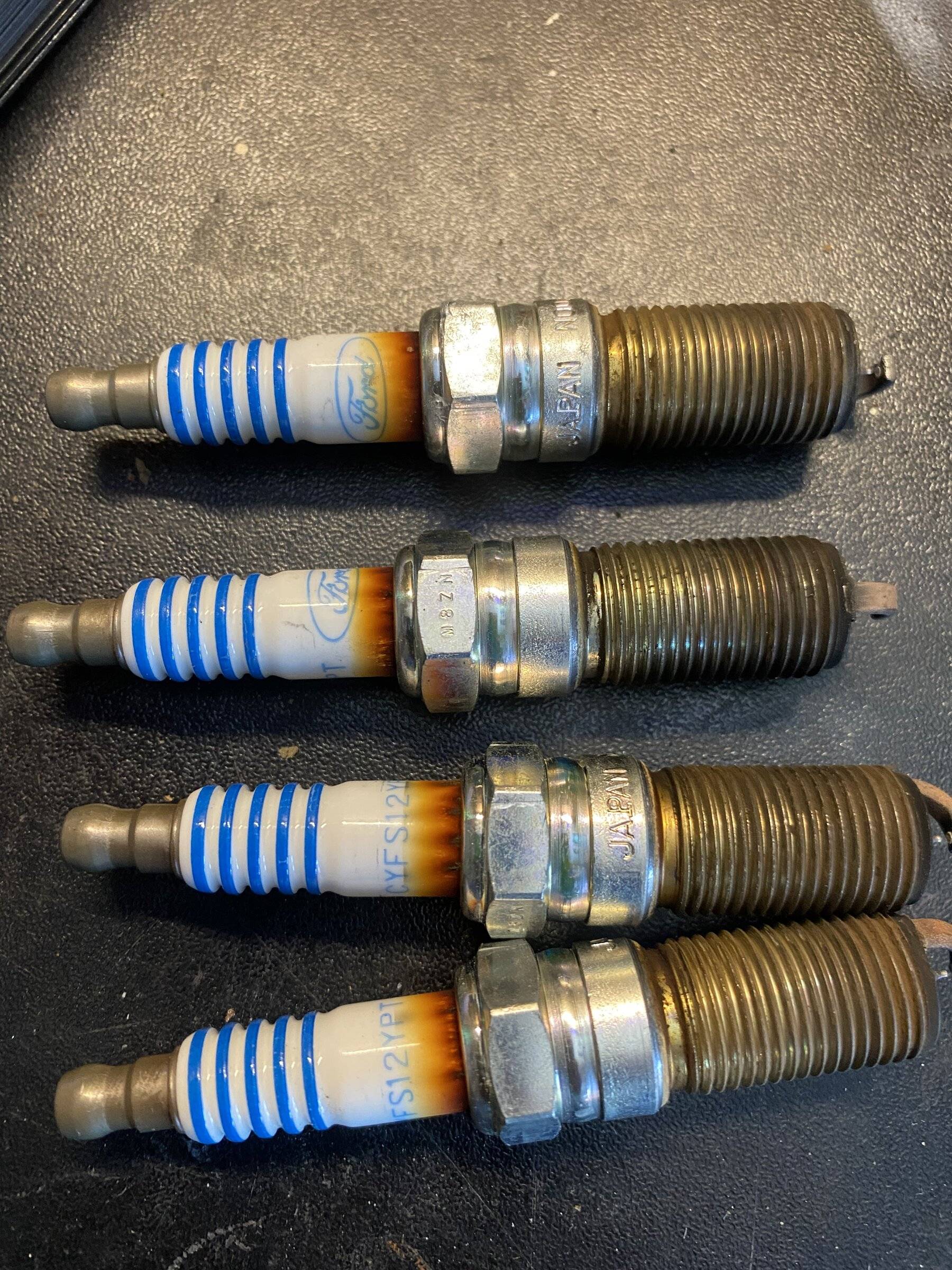

Went to colder spark plugs.........and....

Your plugs were nearing the end of their life anyways
The burn on the porcelain is normal, there are other threads on this
Glad that helped your problem by changing them
I changed mine at 17k to colder plugs, stock plugs looked and torqued fine but I had the burn. I plan on changing after 30k at around 45-50K

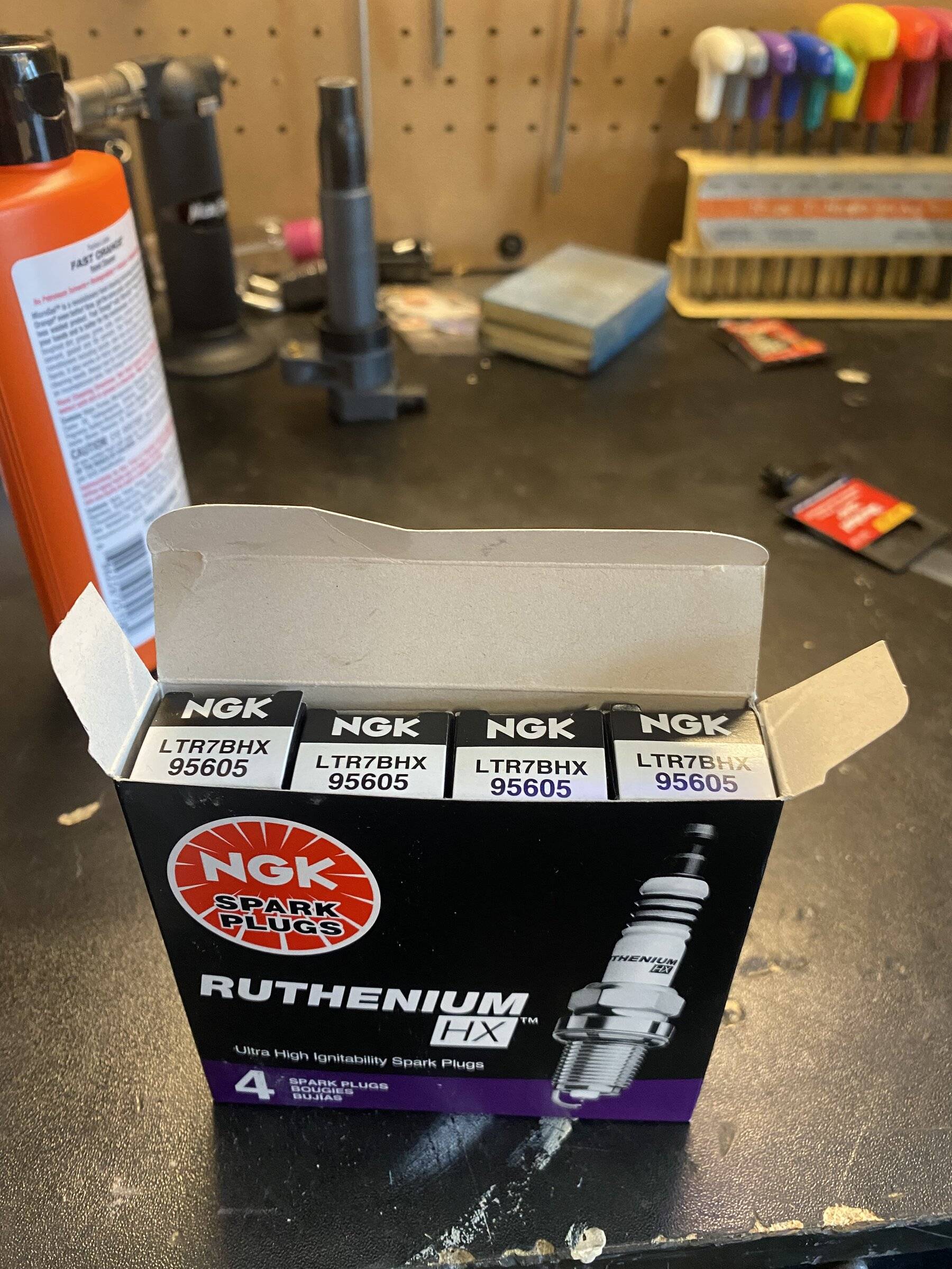

I went with NGK 95605. That's one step colder in ruthenium.
For the stock heat range there is:
NGK 90495 ruthenium
NGK 91794 laser iridium
NGK 94374 iridium ix
The one step colder from s3m is a laser iridium.

Ruthenium HX is different than Iridiums according to NGK and they promote it on their website as superior - PSPE® (projected square platinum electrode) provides the best ignitability and service life for high-heat engines. This NGK-patented design is recommended for turbo and supercharged engines.
I guess this would be the model for most of us without crazy performance upgrades?
I guess this would be the model for most of us without crazy performance upgrades? ILTR6R8G
I didn't see ruthenium HX on rockauto, so I went with ruthenium. Nice to know!
Edit: I did get ruthenium HX, it was clearly on the box lol

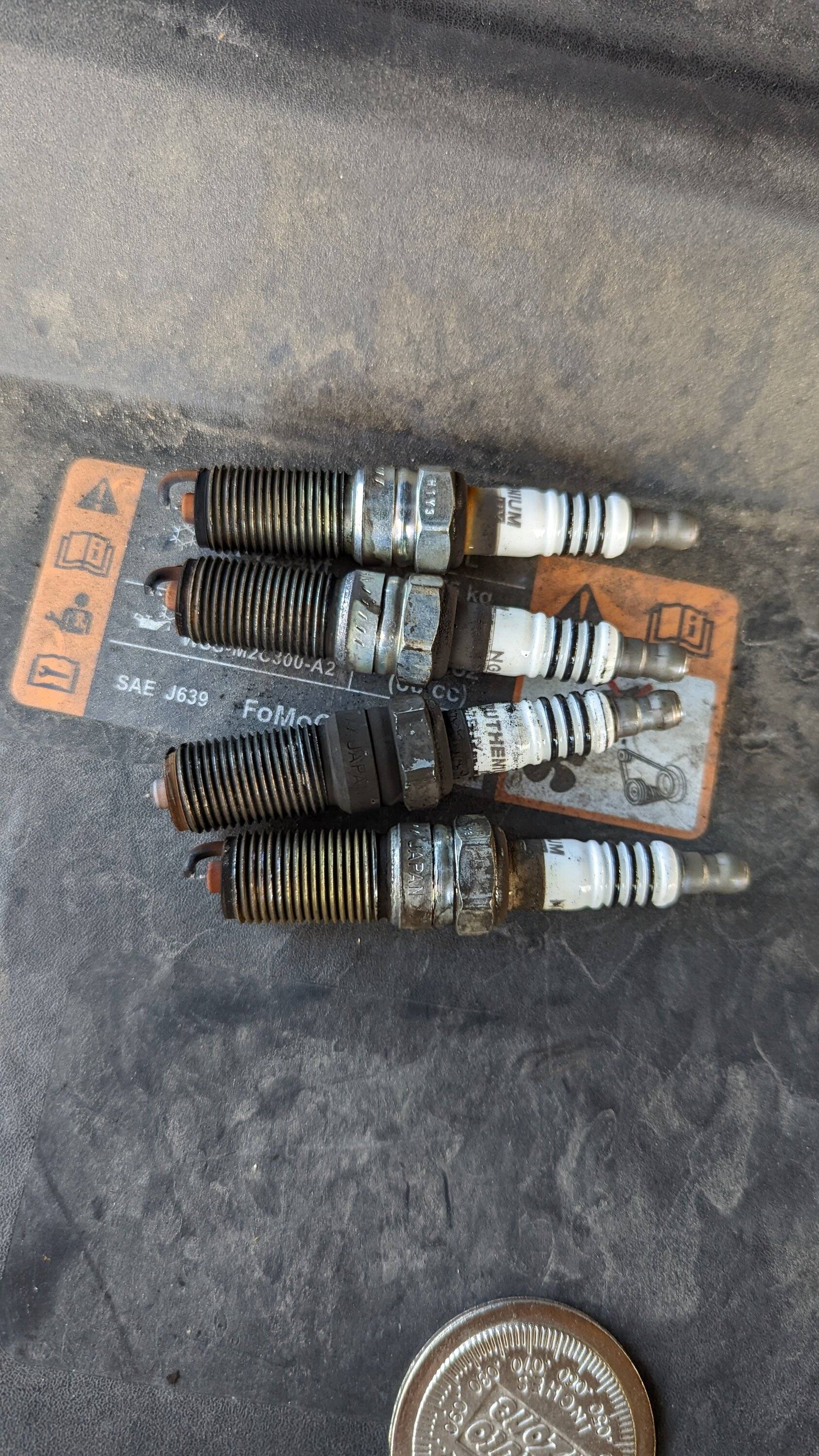

Update:
I had the one step colder ruthenium NGK plugs for 10k miles from 42k to 52k. Started noticing stuttering and the truck being hesitant. I have a aftermarket downpipe so I always get some pops when I let off the gas but I was getting popping on acceleration. Thought it was the EGR valve I saw a lot about on here. Then on the way home I got a misfire on cylinder 4. I decided to buy stock iridium NGK plugs from AutoZone and swap em out when I got home. Glad I did because one of them didn't even have the upper electrode thingamajig. The truck rides like new but sheesh 10k miles. I do drive the truck hard and floor it every day. The 10k miles was mostly on the daily tune. And a little note, I checked the gap they were all about .028" on the new plugs.

My OCD got the best of me because I didn't know what that " thingamajig " was called either. Did you happen to take a borescope into your cylinder to see if the ground electrode was still inside?
After researching I apparently didn't tighten them enough so they were subject to a lot of vibration causing the ground electrode to break off. When I removed them they were all loose. I've stripped threads before so I didn't want to tighten it hard but it felt like there wasn't any more turning to do like I reached the end of the threads. Guess I'll put a torque wrench on them.
And no I haven't looked inside.
If the ground electrode broke off while running then it’s long gone from the cylinder. Hopefully it didn’t damage your turbine wheel too much.
