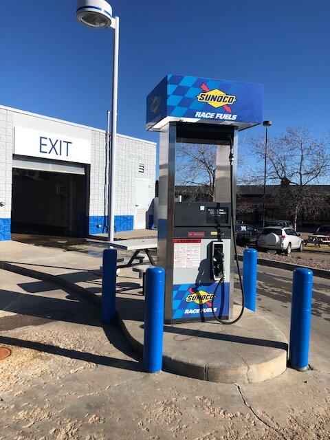

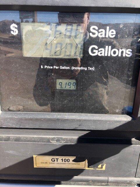

Oh goodness.....looky what papaw found at lunch today....hehehe :clap:
Sunoco GT100 Racing Fuel @ $9.20/gal.
I just wanted to see if a little would make a difference after talking to Anthony @ Livernois yesterday. This was one of the topics we discussed. I didn't think I could find racing gas so easy and very cheap compared to what I saw on the internet last night.
So I mixed 3 gallons of GT100 with approximately 13 gallons of 91
I'll have to figure the math on that....I was hoping for 93+
If I feel any difference, next time I will add 5 gallons of GT100 to 10 gallons of 91.
No worries.....it is unleaded.
