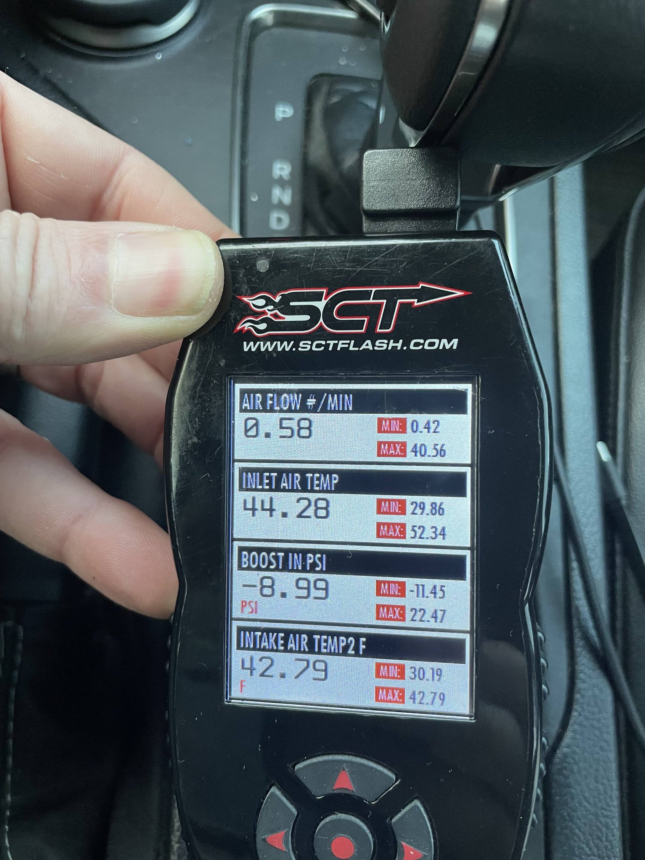

It’s cold out but so far I’ve been monitoring the temperatures and the only time my intake temperature is much higher than ambient is when I’m barely moving. Nobody cares about heat when moving slowly.

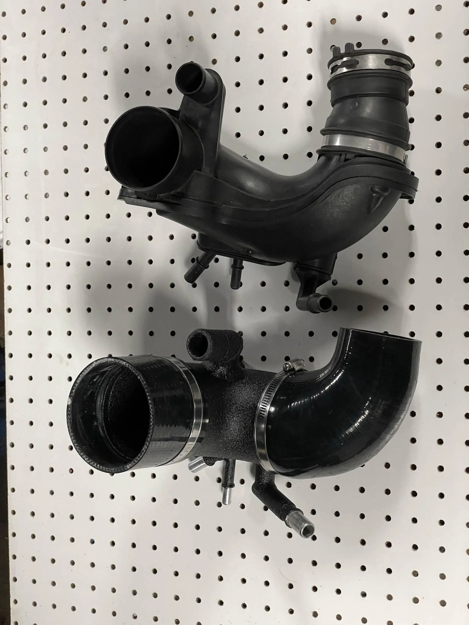

I developed a turbo inlet pipe for our trucks. It improves power and throttle response along with a lot of other benefits for modified trucks. The photo shows the stock one compared to my pipe
Is this something you sell?

How about a link? or any of the usual info, price, availability so forth.
Looks good!
It’s a custom piece turned into a small production run. If there’s enough interest I’ll keep making them but the price will go up if I do. Right now they are $449.00 shipped in most of the USA. The information is on the Facebook Ranger Performance group but anyone can message me for information. I have been developing this and testing it for a while now. I have thousands of miles and a few dyno sessions to make sure I’m happy with it.

I like it. But not $450 like it.

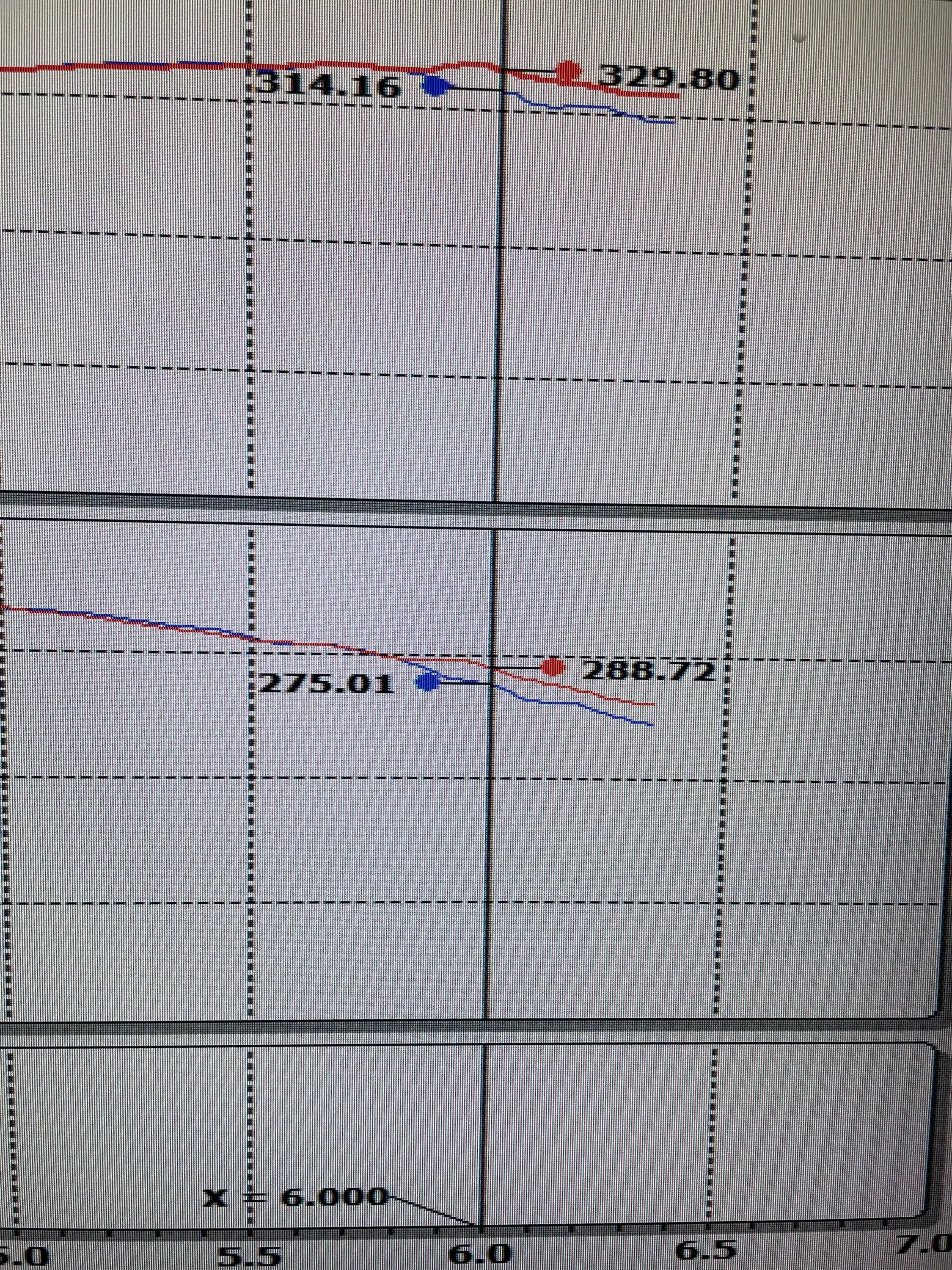

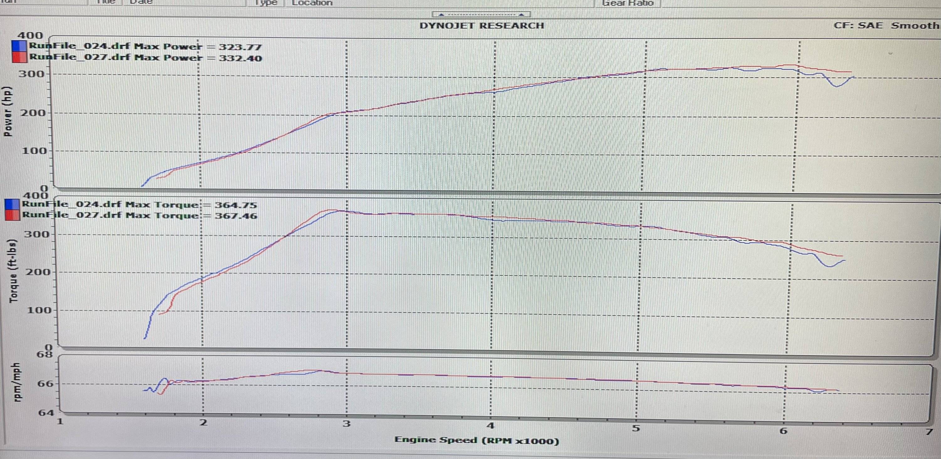

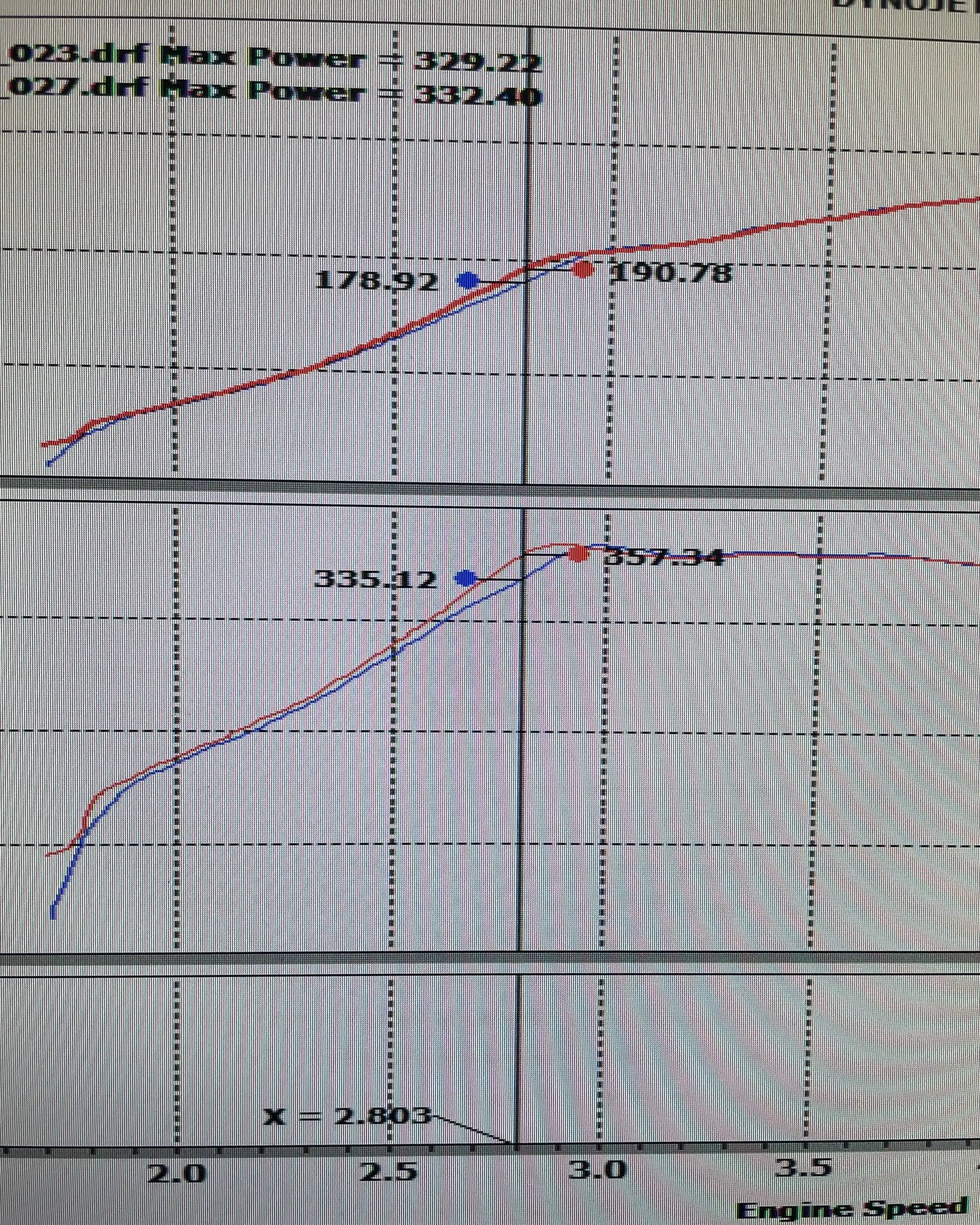

You should post those dyno sheets from the other thread here for people to find.

I was impressed with the gains, the difference in spooling and the throttle response was a big improvement as well.
It’s super time consuming to make, everything is hand machined and welded. The price will increase once I sell this batch. I posted the graphs btw, thanks for reminding me.
