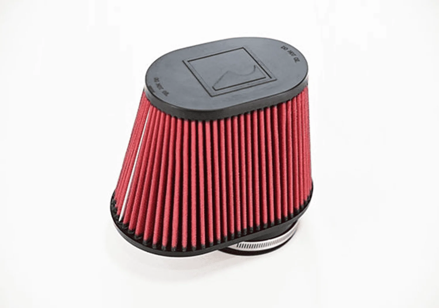

To my understanding(not much experience with this particular kit but want as well) the biggest difference is the filter material. Similar to the cotton gauze of K&N it will allow more air flow compared to the stock paper filter. Unlike K&N you dont need a special cleaning agent to clean the filter and you dont use any oil. For performance you will get a small gain but you also dont have to replace the filter every other oil change. Now there are those on here that dont believe in the kit and feel that it is a waist but to each thier own. What I really like about the kit is you keep the lower part of the factory intake box and that will allow you to run the Safari Snorkel if you want to go offroad and want a cold air intake. That is my input. Perhaps someone else will have some better input on this.

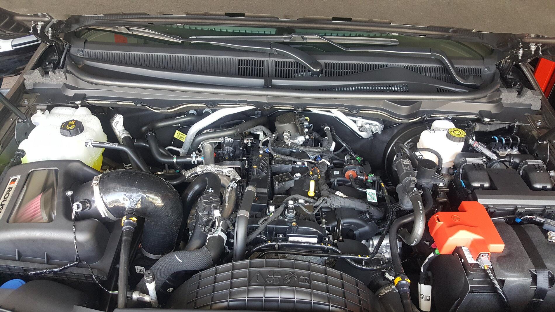

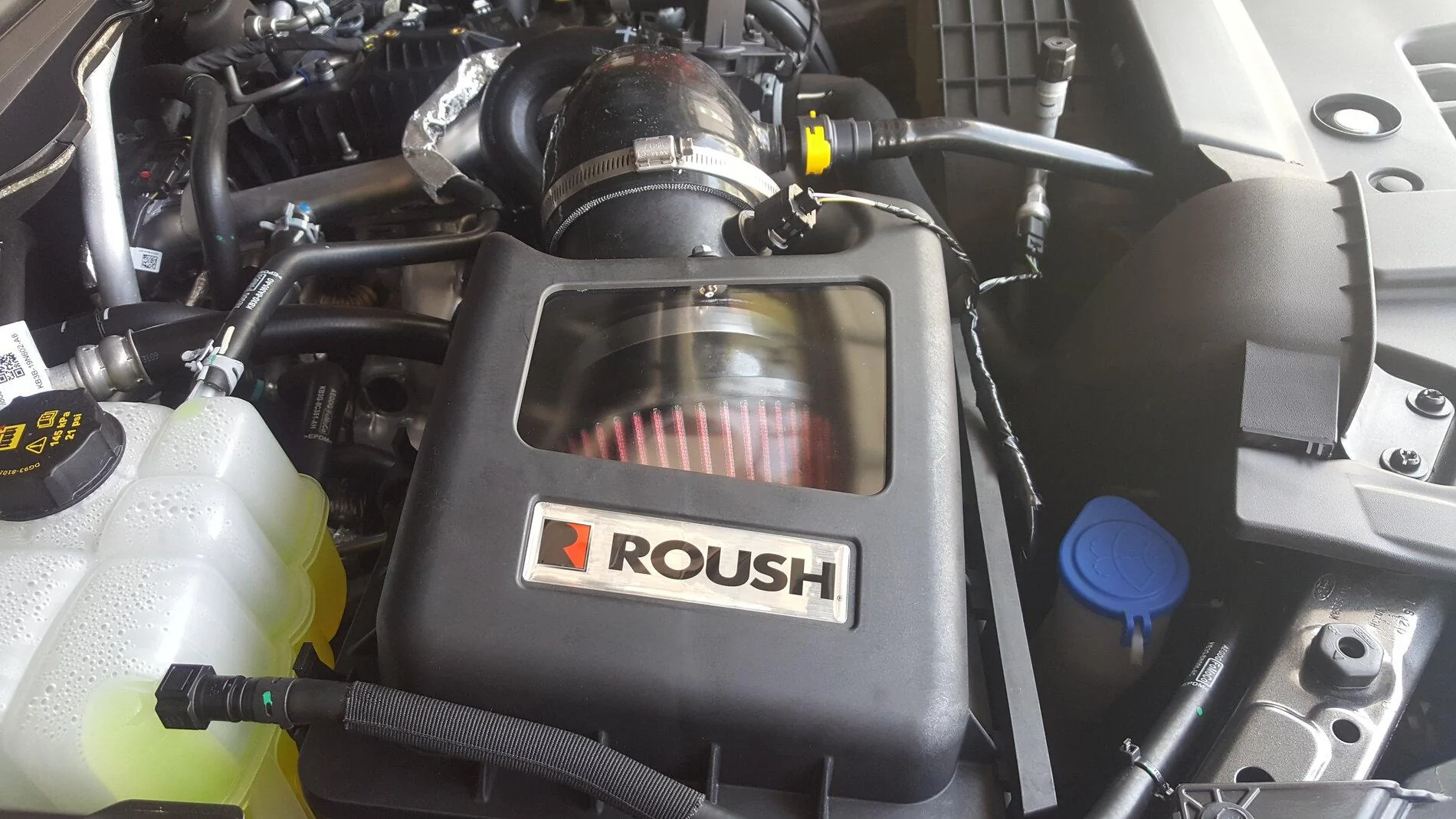

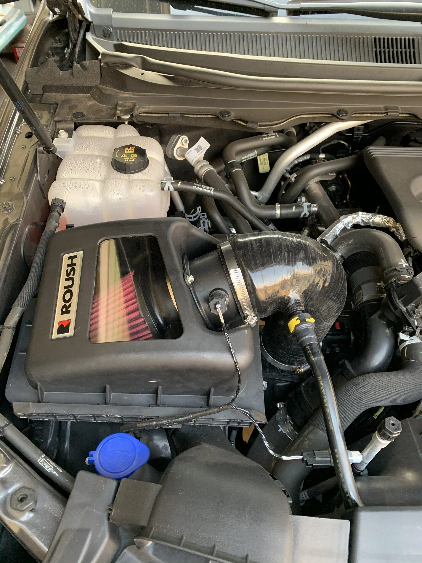

With the kit you are getting a K&N filter and the filter sits in the air box at a slant so it allows for a larger filter to fit in the air box. You can decide if adding a K&N filter is a benefit to you. Also the kit does come with a new flow tube and the flow tube is a larger diameter and smoother inside than the original so I would think this is a benefit as well but have no dyno numbers to prove it. Whether something is "worth" it is totally up to you to decide as it is your money and you decide how it is best spent. Like with any other purchase do your research and make decisions based on what you want.

Correct me if I'm wrong but I'm pretty sure Roush does not use the K&N air filters. They even state that when washing it you do not have to read oil it. K&N you do have to re-oil. Do you have a box that the filter was in?

Seems Frenchy is correct here its not an actual K&N filter.
I stand corrected...
Thanks Frenchy.!
I don't have a box for the filter as I remember it was in a plastic bag inside the box with the rest of the kit...

I installed the Roush CAI. It fits like factory,
but I absolutely cannot tell a difference between stock and Roush. Both in performance and in sound. I was really expecting to be able to hear a difference but I can’t.I’ve purchased other brands on other models of cars and could really hear a difference at least. I’m sure it is because it is still enclosed in a sealed air box, thus not allowing for much noises to be heard.
