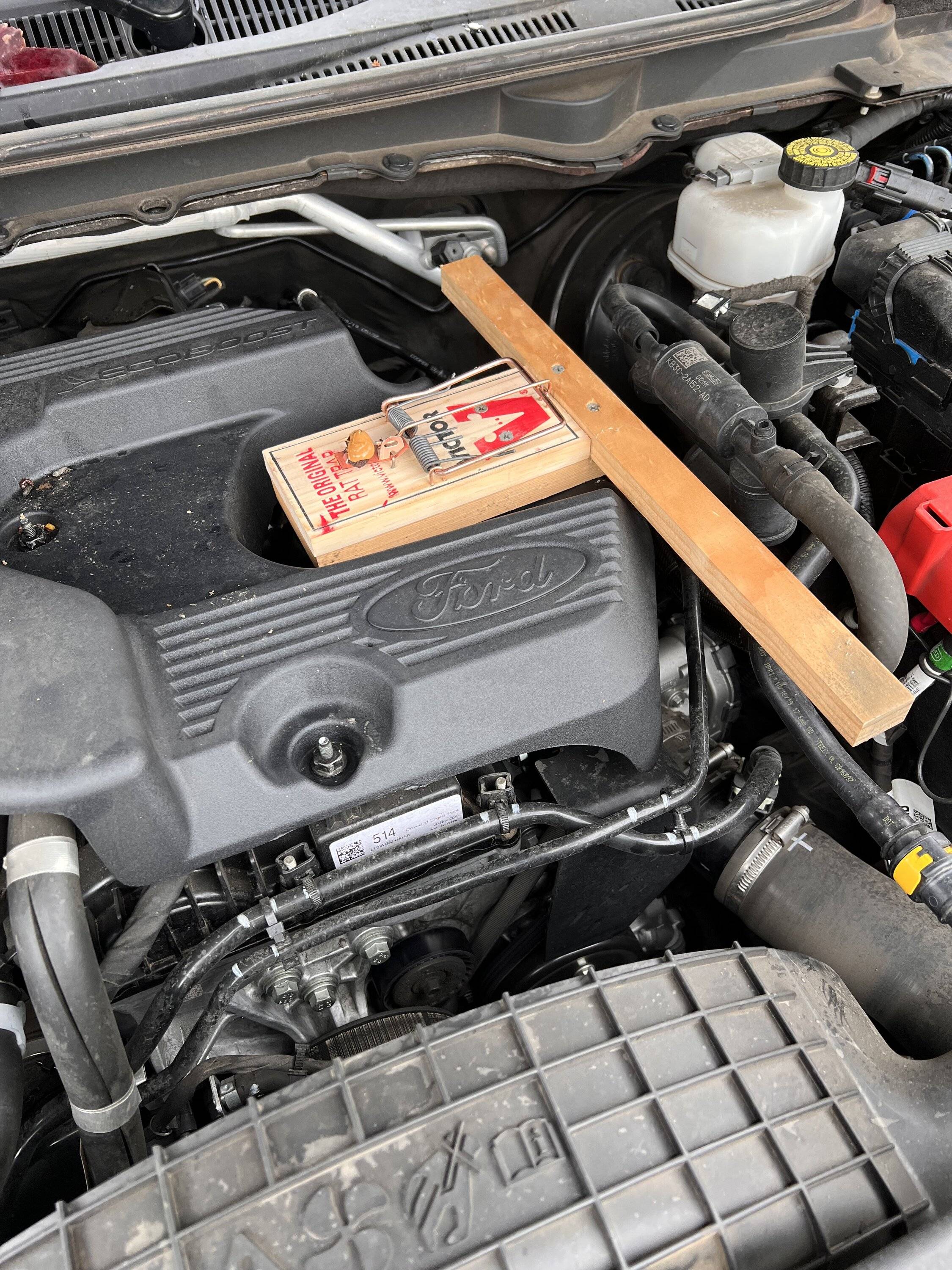

Since my discovery, I have been checking under my hood a lot more lately. At night I have been setting a trap under the hood. I attached it to a couple pieces of scrap wood so a rat can't drag the trap away if it doesn't get a kill shot. I put my keys in a bag to remind me to pull out the trap when I drive my truck.....

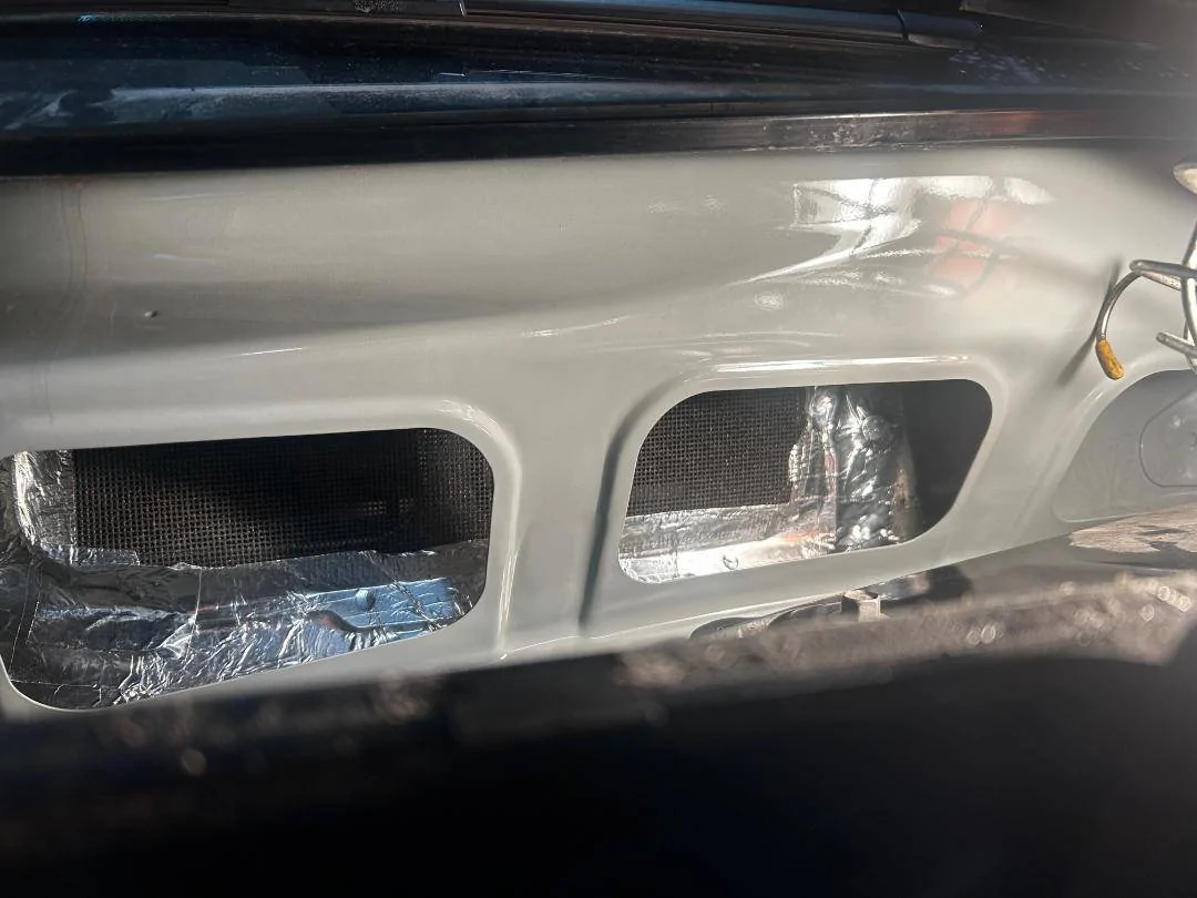

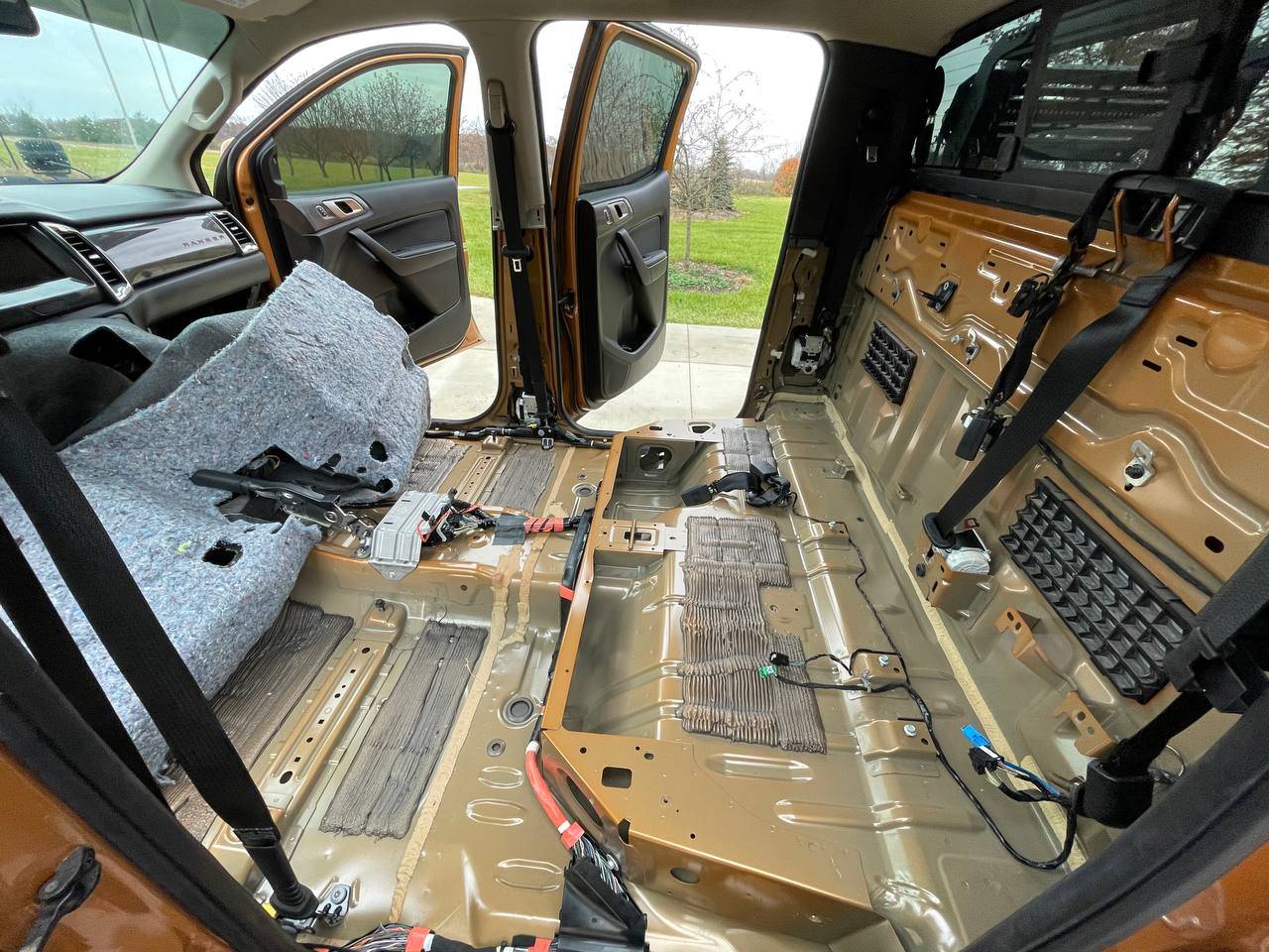

There is another entry point for mice in the cab and that is the 2 Rear Cab Vents
