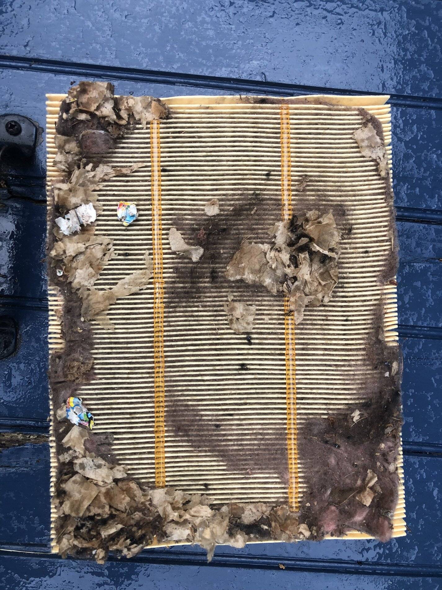

Noticed I had a mouse in my 2020 cabin when I saw droppings on the dash a year or so ago. I got the mouse that day and didn’t think of it again.
Fast forward to today when I decided to change the air filter…welp, looks like I’ve been driving for 15,000 miles with this sucker in it. Looks like he made quite the home…Check your air box after signs of mice!

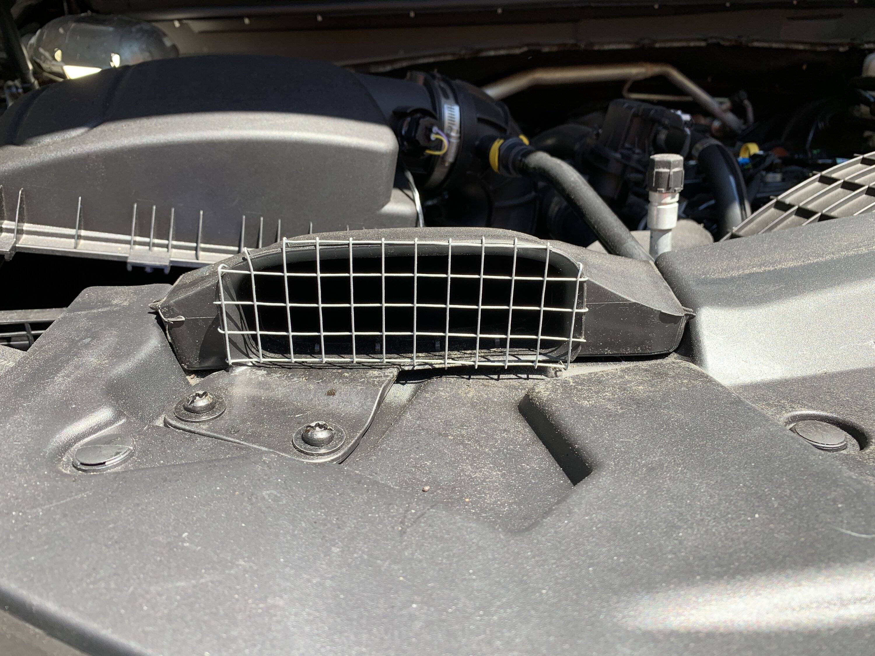

Just finished fabrication and installation of one screen for the engine intake out of 1/2" wire cloth (similar to prior examples in this thread) and two screens for the two cabin air intake holes out of 1/4" wire cloth. Given the possibility of food items being left in the cab, I wanted more thorough protection at the openings under the cowl. The little bastards would be much more motivated to enter there than the engine intake. Plus, I like the fact of the 1/2" cloth being less restrictive to air flow to the engine.

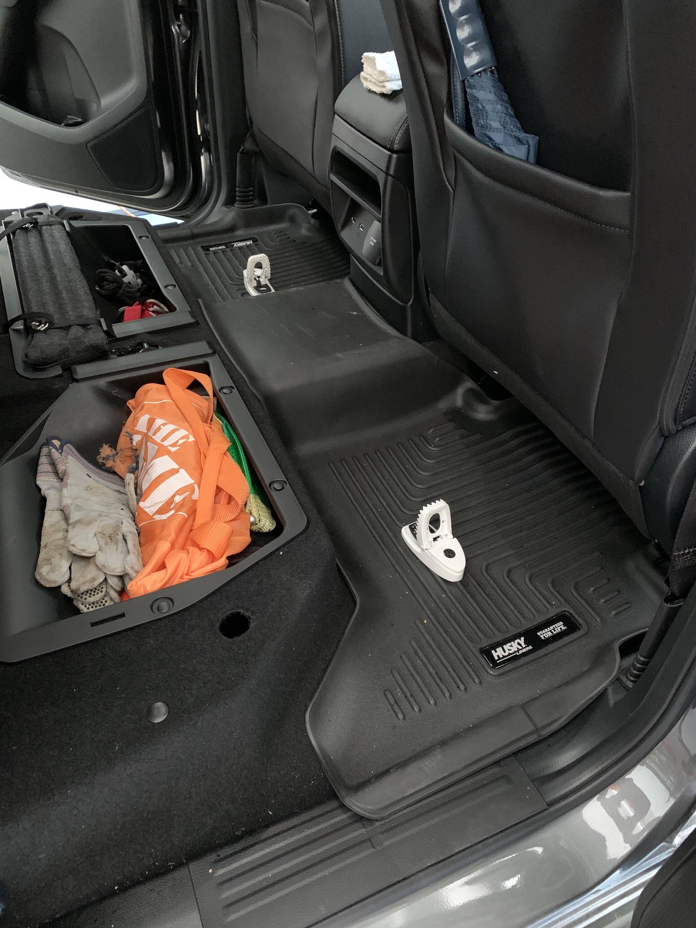

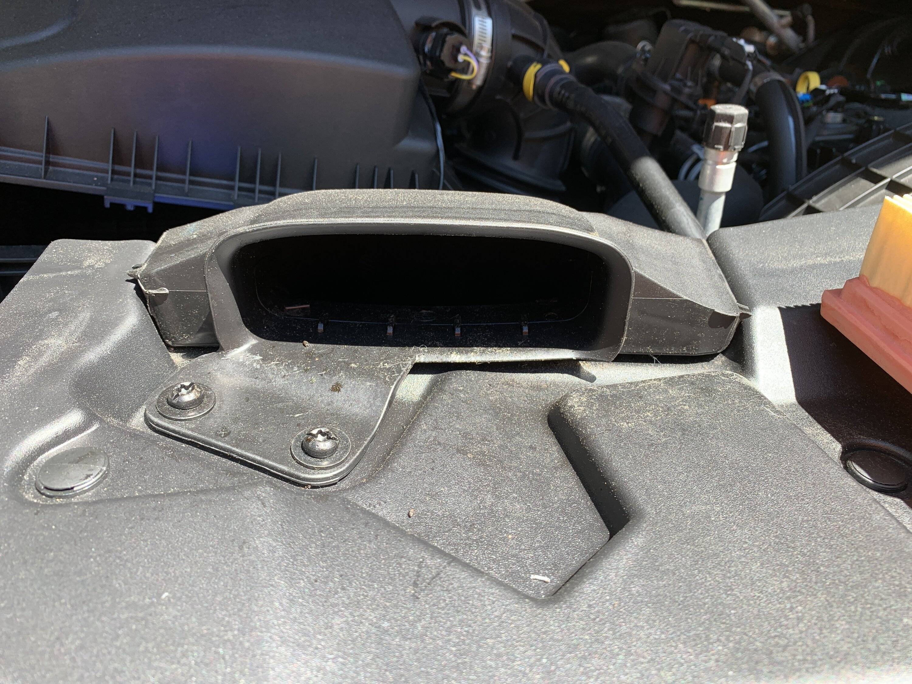

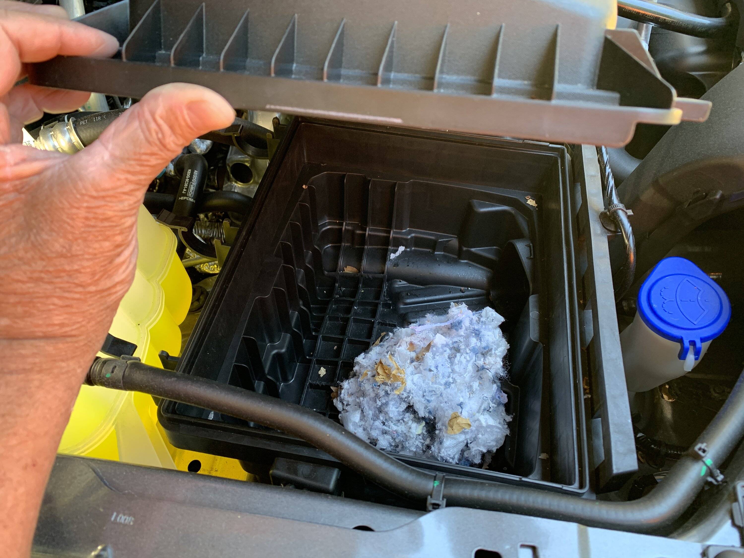

Within a week of getting my new 21 Ranger Lariat I popped the hood and found that something made a nest right on top of my battery. I didn't think much of it but over the months since I was seeing what looked like wet spray marks all throughout the interior. A couple months ago I installed the factory trailer brake controller which wired all the way back into the 3rd brake light and noticed what looked like mouse poop as far back as the bottom of the C pillar. Last week I put a couple mouse traps on my back floorboard (see pics) and have already caught 3 of them. In the pics below you'll also see a clump of material I found in my air cleaner today so I covered the intake with wire mesh.
In other posts, I've read and seen pics about the air intake for the heating/cooling system down through the cabin filter, but no picture shows me clear enough exactly where the air intake(s) are for the interior. Is it underneath the plastic cowl by the wipers? Can anyone please tell me where and how to get to these intake(s) so I can also block them with wire mesh.

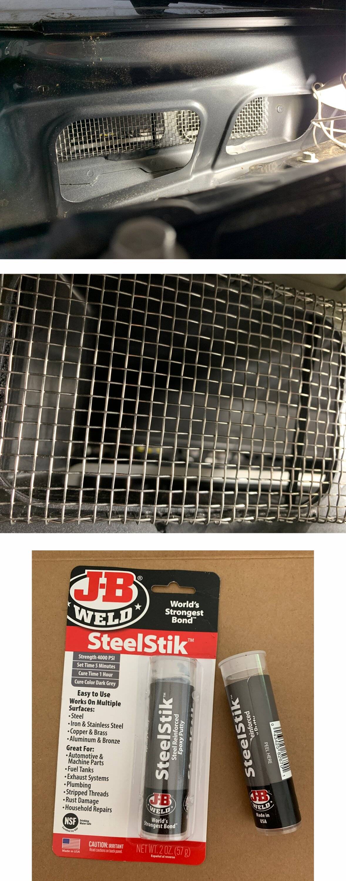

Well, I spent a good part of a day putting a (size 6) stainless steel mesh over the two air ports that allow air into the cabin air system. It was a fairly easy fix as you can see in the pics. I ended up molding the mesh so that as one piece it would cover both openings. I ended up using JB Weld Steel Stick. I cut and mixed a batch of it and stuck strips above and below each opening and then pressed the mesh into them. I then molded the putty tight into the mesh as you can see in the pic. Within an hour the putty was rock hard and provided a nice tight fit for the mesh.
