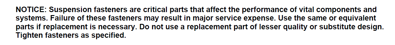

Is the consensus to re-toraue the factory nuts or seek out the 'quality aftermarket' u-bolt/nuts?
Would there be some 'upgrade' version?
I have been loading and towing a bit lately on top of mixed driving and would want to be proactive in prevention.
