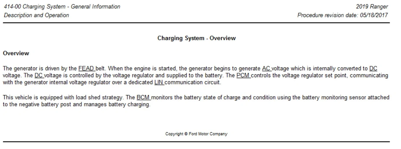

When I got my new 22 Ranger Lariat, I decided to dig into how the charging and BMS operates, thinking it should be an easy task by just doing a quick google search and reading the service manual. Boy, I was dead wrong. I was highly frustrated that at this point in our advanced technology there was not any full descriptions of the charging systems we have today.
I have spent a great amount of time pouring through the different Ford forums, which I noted, no one knows exactly how this system operates, just theories with nothing proven by testing. I also researched things related to the AGM battery and how it must be charged to maintain health.
I then took what I learned through the forums and compared that information to all the documents that Ford has released on the operation of the system, these include Service Manuals, Body & Equipment Mounting Manual, and General Service Bulletin’s, compared the various explanations and complied the facts.
I learned, without a doubt, that the Ford Manuals are basic and very poorly written for anyone that is looking for specific information and due to this fact, it has led to a mass amount of confusion on how this system works, across the whole, Internet. It should have taken me a matter of a few hours to research the information I wanted. But that was sadly not the case.
I found a very frustrating issue when I looked at the service manual for the Ranger, I noted in the description of the system 80% is mentioned, but no documentation of 75%, which if you view the Battery Target SOC 75% via Forscan, I have found that this is the percentage that the manual for the Ranger should show 75%, not 80%. Now some owners have reported that this number is 70% for them, and if this is correct then I believe this would only be on the 2019’s and is possibly related to the battery size difference from the Lariats to the lower trims.
I did an As-Built, comparison, and it appears that the 2019’s might be the difference, if you look at these (2) As-Built Files for an XLT for 2019 and 2020, and if you do the Battery Target change in Forscan the Easy Way, these (2) files change in the BCM.
These files do not match: Possibly the reason owners report a different (%) and then Ford, possibly raised the percentage for the 2020 and Up Rangers. So I cannot confirm without further research, but in my opinion, this could be a possible compare (point) if the 2019’s have more issues than others.
2019 (XLT) @ 70% (Possibly) 2020 (XLT) @ 75% (Confirmed)​
726-07-01 – (0101-0000-0037) ---------------------- (0000-1388-04D4)​
726-07-02 – (0000-0000-0036) ----------------------- (B000-000A-8C7C)​
When Ford puts together a manual for release, they generally use a previous platform as a guide and then configure it to the specific model, well I determined that this number 80%, is on other platforms like the F-150, and this specific spec got missed and was not changed for the Ranger, in documentation.
So, for the sole purpose of helping myself and others, wanted to pass along what I have learned from all the research and also include real world test and monitor results. I will be providing facts and my observation opinions. There is a ton of information on this system all over the internet and I found most of it to be misleading and confusing.
So, for the first time ever published, I am posting a full in-depth description of the charging system and all aspects. This is a long post, so get comfortable and enjoy the read.

From what I have learned so far, the PCM is the controlling module for the charging voltage output and it knows when the truck is in deceleration mode from the inputs of the Vech Speed and Crank Sensors, the PCM increases the field voltage to maximize the alternator output.

Reference Materials:
I am attaching some reference documentation as follows.
Note: If you reference any of the Ford manuals for description on the operation of the charging system, please note that these manuals can and will be confusing and that is the reason for this post, to break it down how it truly works.
1. Aux Batt Charging - Smart System - 12v Planet
https://www.ranger5g.com/forum/atta...167315/?hash=e1da65d8c6c722b1079b219da661341a
2. Ford: General Service Bulletin: Battery Charging
https://www.ranger5g.com/forum/atta...167316/?hash=e1da65d8c6c722b1079b219da661341a
3. Ford: General Service Bulletin: A/Start System
https://www.ranger5g.com/forum/atta...167317/?hash=e1da65d8c6c722b1079b219da661341a
4. Ford: General Service Bulletin - Deep Sleep
https://www.ranger5g.com/forum/atta...167318/?hash=e1da65d8c6c722b1079b219da661341a
5. Ford: Smart Charge Explained - Taken from a Ford Transit - Body & Equip Mounting Manual
https://www.ranger5g.com/forum/atta...167319/?hash=e1da65d8c6c722b1079b219da661341a
6. Ford Ranger Service Manual: Charging System Operation

@airline tech
Where does the reference line generator desired voltage come from ?
This infernal engine cut I'm getting , relates to intermittent voltage cut on ☝🏻☝🏻☝🏻 that line

The PCM (Powertrain Control Module) controls the charging voltage via the LIN communications link. See diagram.
