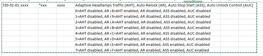

Ok, my curiosity got to me. and I found something interesting. Now it appears that the only settings that I see altered in the As-Built files for mine are: 2 Files, related to the switch.
Mine: IPC: 720-01-01 (2F0F-1464-7251) Factory A-Start Deleted - No Switch Installed
2021 FX4 -IPC: 720-01-01 (2F0F-3464-7271) With A/Start
720-01-01 (XXXX-3XXX-XXXX) to (XXXX-1XXX-XXXX), you are disabling ASS. but this is in the IPC.
Note: How the auto unlock is tied into the ASS, might be something to note for reference when you lose both A/Start and are having issues with unlocking the truck.
and this file in the FCIM
Mine: 7A7-01-01 (0076-80DC-1496) (Ass-Disabled) (No-Switch-Installed)
Compare: (XXXX-X1DC-XXXX) (Ass-Enabled) (Switch Installed)
So, my question, has anyone tried changing those two codes, to disable it, you may have to disconnect the ASS switch to obtain a result without any DTC codes though.

So, to clarify, I have my ASS disabled from the factory and only have 2 known hex codes changed and it is not the BCM code that others are using to delete it.
So, to answer what does disabling ASS using Forscan, actually do, within the BMS, well I do not have a positive answer, but I think it is doing one of 2 things.
Slave Exists BMS Configuration, I think all this does is it tricks the system into thinking that the battery voltage is below 11.3 Volts, thus keeping it from activating. I was attempting to find the post about owners still seeing a vehicle charging message in the IPC, when they have disabled ASS by this method. If they are constantly seeing the message, then I would be correct. But this is my best logical guess.
