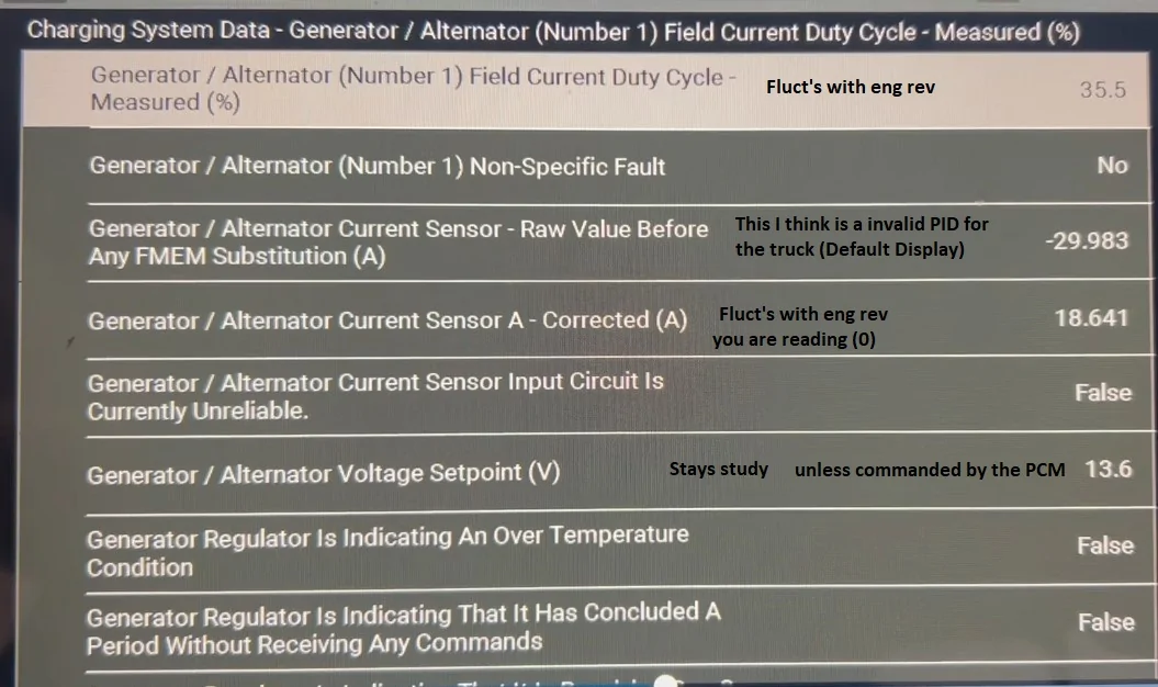

This is where you are faulting - this screenshot is at idle, if I rev the engine (duplicating) yours
the Duty Cycle & Current Sensor rapidly increase (quick snaps)
The PCM is not picking up (receiving) that the alternator is producing output current which is feedback (ref) on the LIN.
You can see the PCM side of the circuit is working as its setting a desired setpoint, so either the alternator is bad, or the LIN circuit is bad, most likely a bad connection (heat) increases the resistance on the circuit, and a bad connection is disabling the output.
I can't see the alternator causing the engine to cut out. I can see the PCM having a problem causing the engine cut out and the alternator voltage to dip at the same time, since it controls both.
As I said earlier, you can (as a test) unplug the LIN connector on the alternator and run the engine to eliminate it as a possible problem.

Something I have noticed but never really paid attention to:
All the BMS Sensor and Charging Targets - Relate to the SOC, in my mind it always went to battery voltage:
BUT if you actually think about it and with the BMS (Calibration) it references it being used to get an ACCURATE SOC - Hmm - What if the SOC is off, then then charging system will follow that SOC Calculation, no matter what the actual voltage is.
This would be the SOC Drift - Which is supposed to correct itself on the (Sleep Calibration)
So, a more accurate reading to correct the drift
During (Engine Running) it is measuring the in & Out Current as well as voltage & Temp so the SOC may drift while driving
PCM Control of the Generator (Note all PID data = Generator)
This is a single wire (LIN) circuit than takes place of the old (Gen-Com) & (Gen-Mon) & Sense Wire
LIN (Local Interconnect Network) - PWM with a Ground
PCM: (Master Node)
The PCM sets a Desired Generator Voltage (Setpoint) to the Regulator (PWM) 125 Hz Frequency
This is determined by the PCM From:
Set operation Mode: From Above
Engine Parameters -Such as: Throttle Position, RPM, VSS, Engine Load.
IAT (Intake Air Temp) (Perceived Battery Temp) outside of the BMS Sensor Reading
BCM - Input of Battery Condition (BMS Sensor Input)
Feedback from Generator (Current) Load
The Generator is also sending feedback of Generator Temp (Internal) as there is a PID for Gen Overtempt being reported (True/False) - so this would only be a DTC code monitor along with any other failure code DTCs that the PCM is monitoring for the LIN circuit.
Regulator (Slave-Node)
The Regulator in turn from the received data pulses the signal to ground rapidly producing a square wave signal (Duty Cycle) - The field current is being pulsed to ground this in turn controls the output voltage. (Based on the PCM Desired Voltage Setpoint)
The Duty Cycle is measured as a percent (On-Time)
The Duty Cycle (is what controls the voltage output) of the Generator, this is the current (Amps) reading.
The Higher the Duty Cycle - The Higher the output voltage will be.
So, on a PID data list you will see the Duty Cycle and Gen Current PIDs fluctuating.
Every 5-Seconds the Desired Generator Output Voltage is pulsed for change, if no change is required it will not change
To truly see the PWM (Duty Cycle Signals) it needs to be viewed on a Lab Scope
Here is a Ref Data Chart for Duty Cycle T-Shooting - Semi Accurate as a REF Only Guide
Note this is from the old style 3 Wire Control, but works for the LIN Control
This is me playing:
Wanted to see the BCM PIDs -
Sensor Disconnected Defaults and Sensor Disconnected & a BMS Reset Defaults
Sorry I did not realize I did not have matching PID data for the pics
But before disconnecting:
Bat Volt was 14.1 Volts
SOC 91%
Batt Temp 55 Deg
I was curious if (even though) it's not updating the BCM for data, is this data being transmitted to the PCM for charging data - or is is not being sent due to the fault code that is generated with it disconnected.
As Noted, The BCM still has it powered (ON) by its LIN Bus - so the LIN is still powering the connector for data (dead end connection)
I was questioning how long this default data remained and wanted to know if any of this default data was being transmitted to the PCM. IDK for sure but I believe the fault code blocks the data from being used and the PCM uses IAT as the back-up for battery temp
-----BMS - Disconnected ----------------------- BMS - Disconnected & Then BMS Reset

What we need to actually see is (ALL) related PIDs for the charging system to pin it down, we are not seeing that and can only make suggestions at this point.
However, note that a issue on the LIN circuit (voltage rises) as the throttle is increased may be triggering the PCM into LIMP Mode, the same goes for it being disconnected.
So, note: That even with the LIN disconnected there is still power feeding on that wire, if its shorted it will back feed into the PCM - I think this is what we are seeing.
The Ground is being applied via the wire instead of the Regulator and the PCM still thinks the LIN is connected because it is seeing a ground - so it's not going into default charging (Mode) the way it should if you disconnect the LIN wire -it's not seeing an open circuit.
This is why I am FOCUSED on the LIN Circuit.
We are not seeing (ALL) the PIDs for what the Generator does with it disconnected @ Idle and when the RPMs are raised.
So, I agree it's either the PCM (Module Supply) voltage dropping or its the (System Voltage Supply) or the (Inferred Battery Voltage) all of these plus the Desired Set Point Voltage as well as the various other module voltages need to be viewed and the Gen Current and Battery Current.
So, we have a long list of PIDs that we are not being shown, as well as the various PID (fault monitoring) related to the charging system.
It may also be possible that the (LIN) was shorted which again took out the generator (2nd) after it was replaced.
Basically, bottom line is - the PCM appears to have forced LIMP Mode, and this is why the PCM is limiting the RPMs.
Again, a full system scan and or Self-Test Reset of the PCM will / should reveal something as with this test (Automatic) RPM Increase is performed, and it may show something at this point as it will not be able to get a valid response.

I am working on a hunch - but when you get it back together, I need to know any other issues you are having other than throttle limitation.
Anything else noted - hard starting, IPC Messages, door locks not working and I am focused on the Gen Desired Voltage - defaulting to 10.6
Plus, it would help to know, what has been Replaced and or checked so far - Detailed
I have a hunch that the PCM is losing the ISP-R. (Input)
Ignition Switch Position Run - This data is sent across all the data busses.
But for the PCM:
BCM to PAM & PCM - via HSCAN 1
With KOEO (Key on Engine Off) that is the normal Gen Desired Voltage 10.6 Volts, so it MAY possibly be an issue on this circuit, the PCM is thinking the engine should be off as it may be losing the ignition switch position.
I need to dig some more, to see what other factors could trigger the 10.6.
Just throwing out possible.
