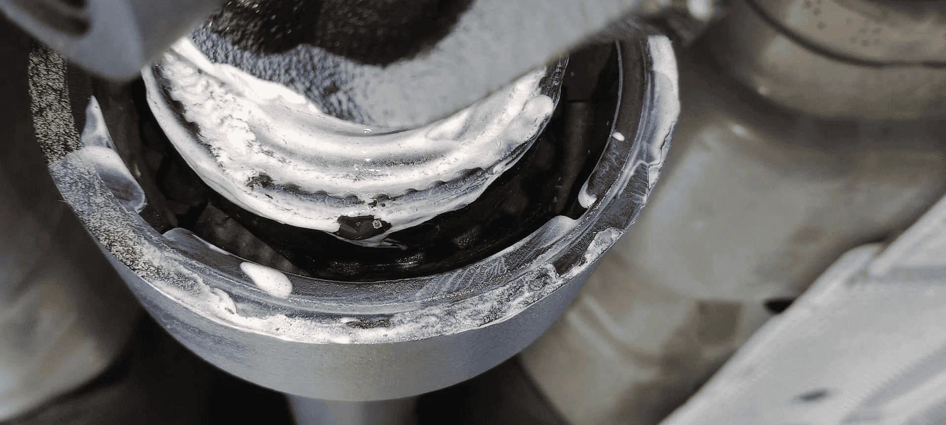

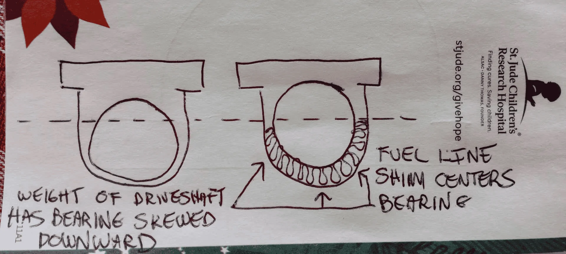

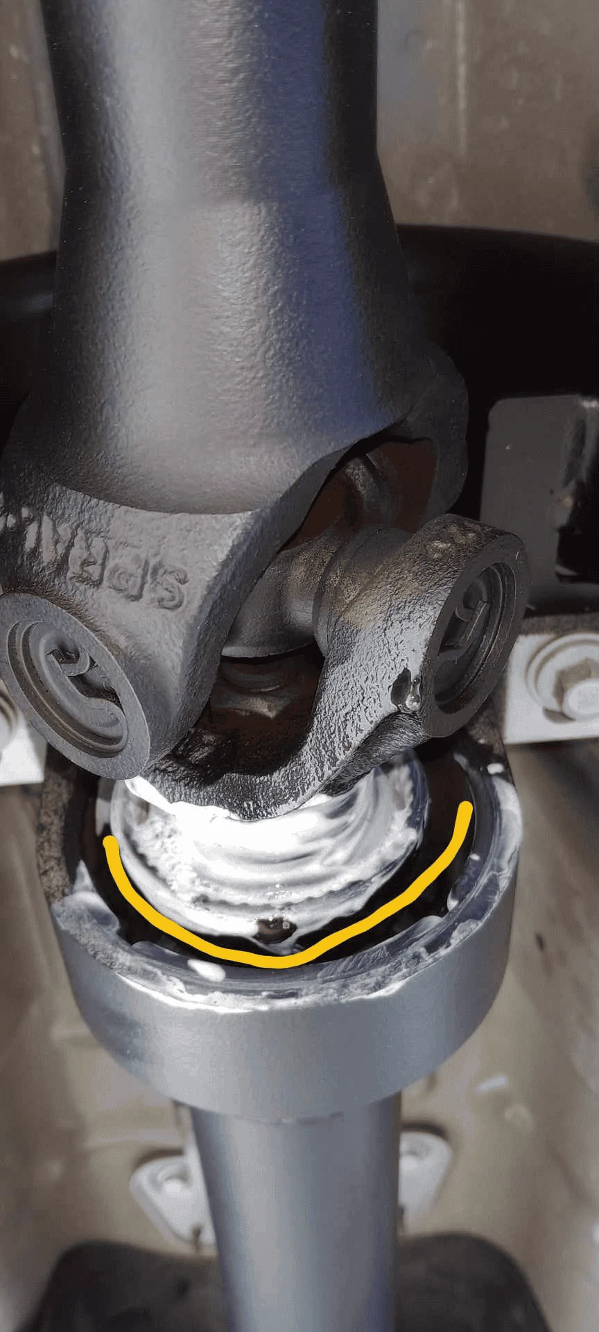

So my carrier bearing started intermittently squealing . It was pretty bad the other day . It has a tendency to do it more when it rains for the life of me I dont know why . Unable to get into the dealer I decided to take a look at it . I noticed on mine the rubber donut for lack of a better term seems to be sagging downward with the weight of the driveshaft. So I took my hand and forced the driveshaft upward and was surprised how much it moves upward...a lil red neck engineering I thought to myself to stiffen that up and down motion / position / angle might help. I took a 6 inch piece of rubber fuel line, slit it down one side and stuffed it into the rubber donut ring gap on the bottom half that faces the rear of the truck . The yellow highlight below is where the fuel line is inserted . Think of the installed shape like a smiley face smile on the lower half of the donut. Once "stuffed" It positionally moves the yoke upward a little bit in the donut. Voila it stopped squealing . Full disclosure AFTER my non sqealing road test and not content :) leaving well enough alone additionally I sprayed WD40 White Lithium formula into the area. One could surmise from this experiment maybe its a yoke angle thing in the bearing ? Too early to celebrate yet but I will keep all advised . Maybe someone else can try to this bandaid too and see if it works on their truck. I am stock ride height, XL 4X4, no leveling but with 32" tires currently at 40k. It started intermittently doing this on mine at around 28k.
FWIW. UPDATE 7-21-23 Still no squealing but its probably still too early to tell B U T I have noticed a byproduct of the rubber fuel line shim is less shudder on takeoff -feels more solid ....I guess its more rigid and diminishes up and down oscillations a bit. A nice byproduct of the shimming.

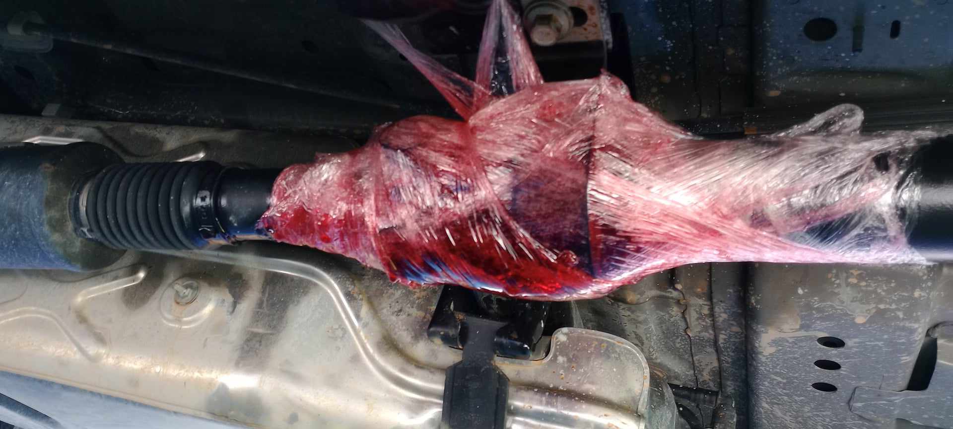

Update 10-15-23 : So my carrier bearing has been quiet as a mouse for the last 3 months or so ...the other day I ran through a totally orange clay silted puddle about 2-3 inches deep at 35 mp due to a downpour near a turnpike project near my house . Within 10 seconds of hitting that puddle my bearing started squealing. It NEVER stopped squeeling this time (a first). I must have driven 50 painfull miles yesterday with it constantly squealing - never letting up . Usually it would squeal for up to 15 miles or so then stop squealing. So from this -its got to be a contamination issue getting into the bearing. Anyway I decided to wrap the bearing in saran wrap and fill the saran wrap to the top over the entire bearing with transmission fluid . I let it soak overnight . In this pic it leaked down over night but it was fully submerged for numerous hrs before it leaked down . I unwrapped it this am ,wipe off all the trans fluid take it for a drive and its quiet as a mouse again . Like I stated months ago back in the thread it tended to do it more after a rain storm which I couldnt explain. Puddles etc splashing up on the bearing must be part of it . Lets see how long this bandaid lasts.

Well its been almost a year since I did this dousing with transmission fluid and saran wrap overnight. It still hasnt squeaked in 11 months - I have some transmission fluid laying around so honestly when I get some time I am going to do it again . FWIW.
