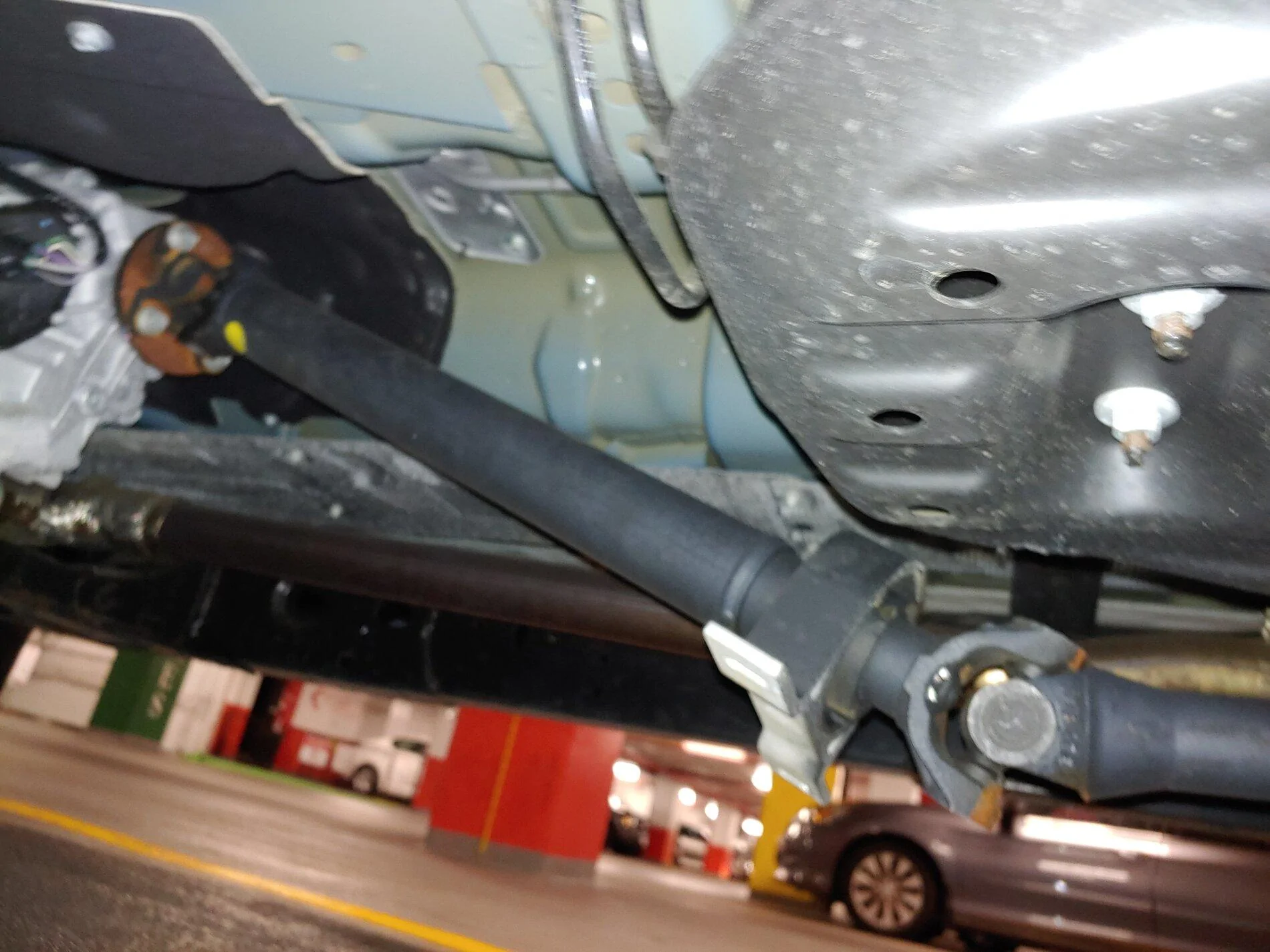

I know this is an old thread, but has anyone else had there carrier bearing fall off. Just bought this truck 10 days ago. Less than 300 miles on the odometer.
That is the first one I've heard about on these forums. That is crazy - you probably lost the bolts, huh? I'm guessing they dropped out at some point - where did it fall off? Looks like that is in a parking garage?

It started vibrating on the freeway and came just as I was getting off onto the exit.

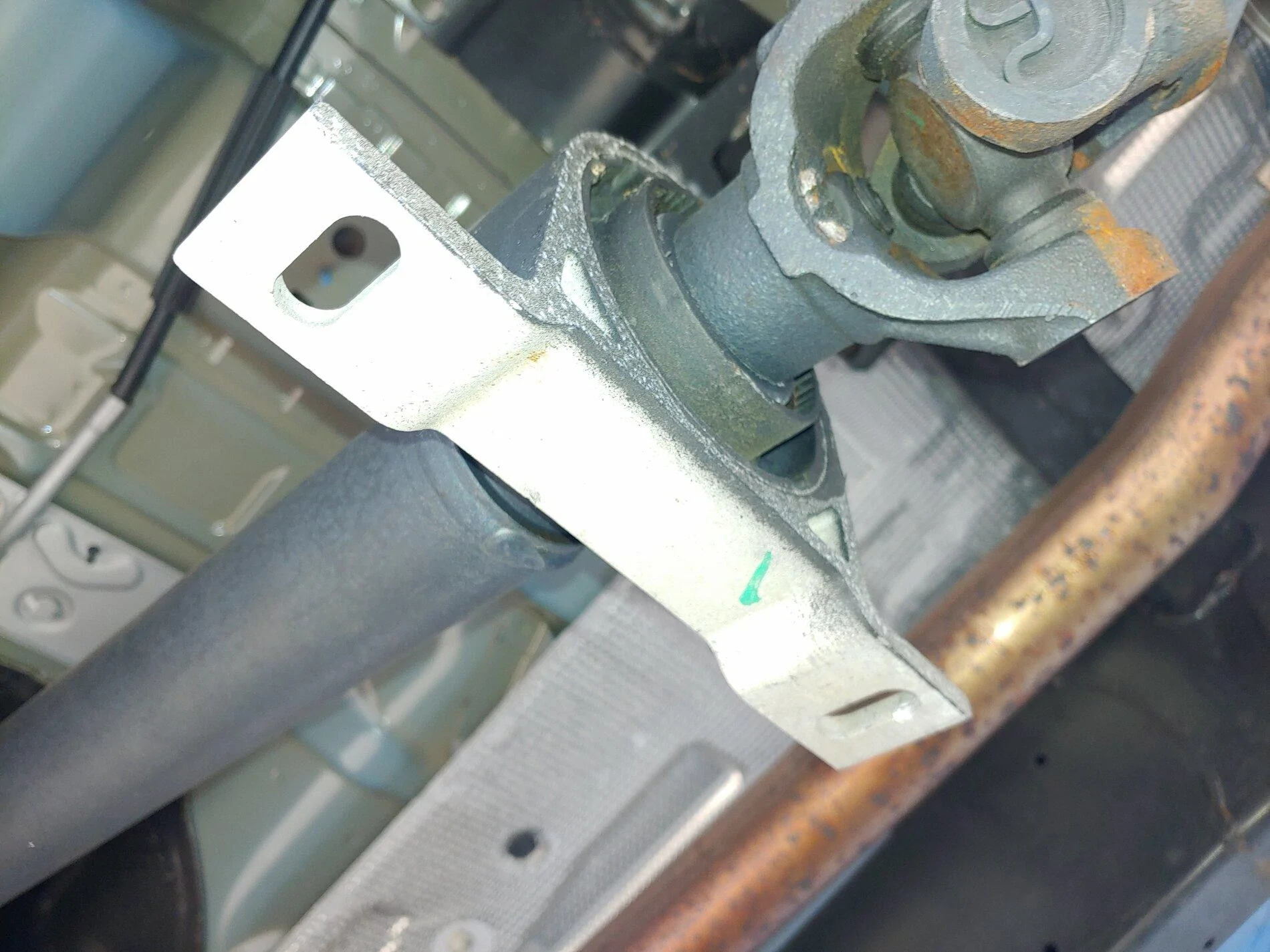

A little off-topic, but not... I had a tarp get wrapped up on the driveshaft while driving on the freeway this weekend. I had to get under and cut it off. Part of it melted on/into the carrier boot/bushing. Can anyone share a picture of the rear face of their carrier? Want to see if mine looks normal or if some of the rubber surrounding the bearing has melted away.

Hi Charly,
Weird. I have seen a few driveshaft related problems, but not a tarp! Worse was a box spring from bedding. Awful trying to remove the spring wire.
Good Luck with your remedial efforts.

Thanks Phil. Running just fine but I still have some concern. I’ve got a busy week and can’t get the truck in to service. Hoping someone can provide a good picture of both the front and back faces of the carrier so I can compare.
