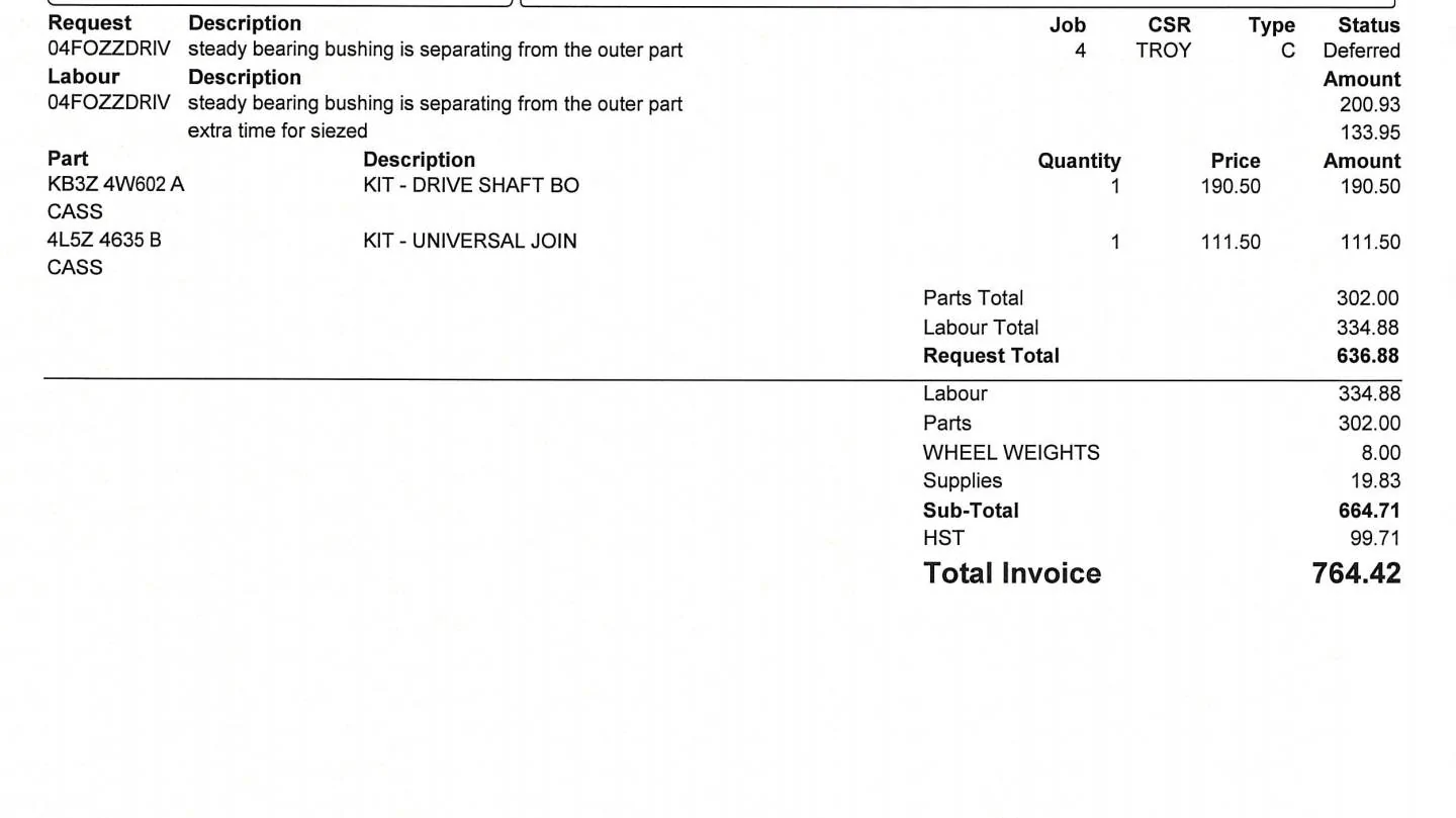

Truck is in the shop to get the rear driveshaft/diff pinion seal replaced under warranty and they're telling me the drive shaft steady bearing bushing is 75% worn out. And it's not covered under warranty. I have a hard time believing this. In my warranty package it states all rear wheel drive bearings and supports are covered but this one isn't. Also I'd this a good price or is this something that can be done cheaper at a friend's shop

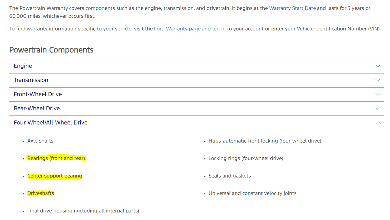

When I read thru my ESP, there is no mention of carrier bearing (steady bearing) in any of the different levels of coverage from Base to Premium. But I don't see anywhere that specifically states
that it is not covered.

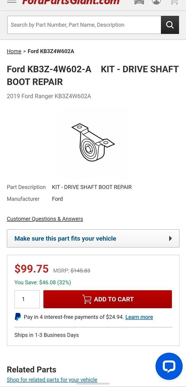

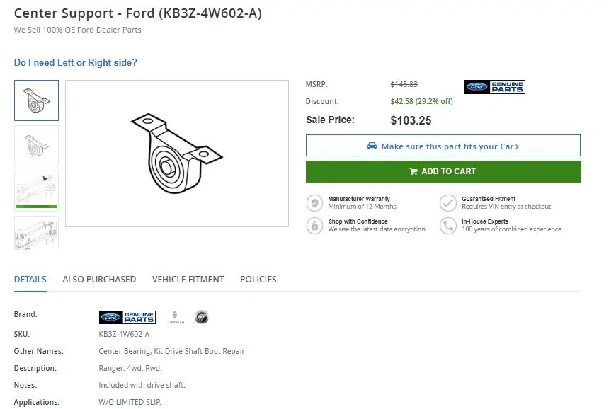

When I looked up that P/N at Levittown, it's called Center Support and the notes say included with drive shaft. Next to other names it says Center Bearing, kit Drive Shaft Boot Repair.
I don't know how it is on our Rangers, but on my '95 F150, the bearing was pressed onto the shaft and was not easily replaced on its own. I needed a press to pull the old one off, and press on the new one.
THIS, I believe most people that have had this issue had the entire driveshaft replaced under warranty. The driveshaft assay is coded as a warranty item but the bearing is not.
