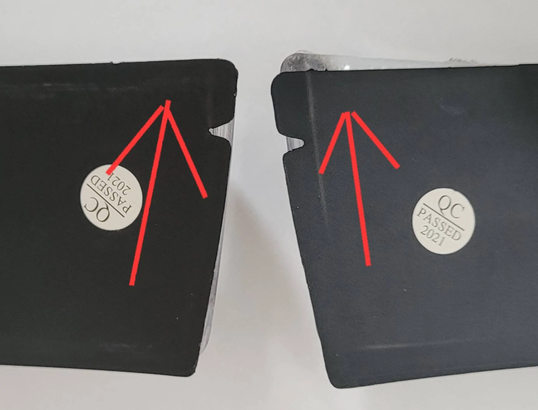

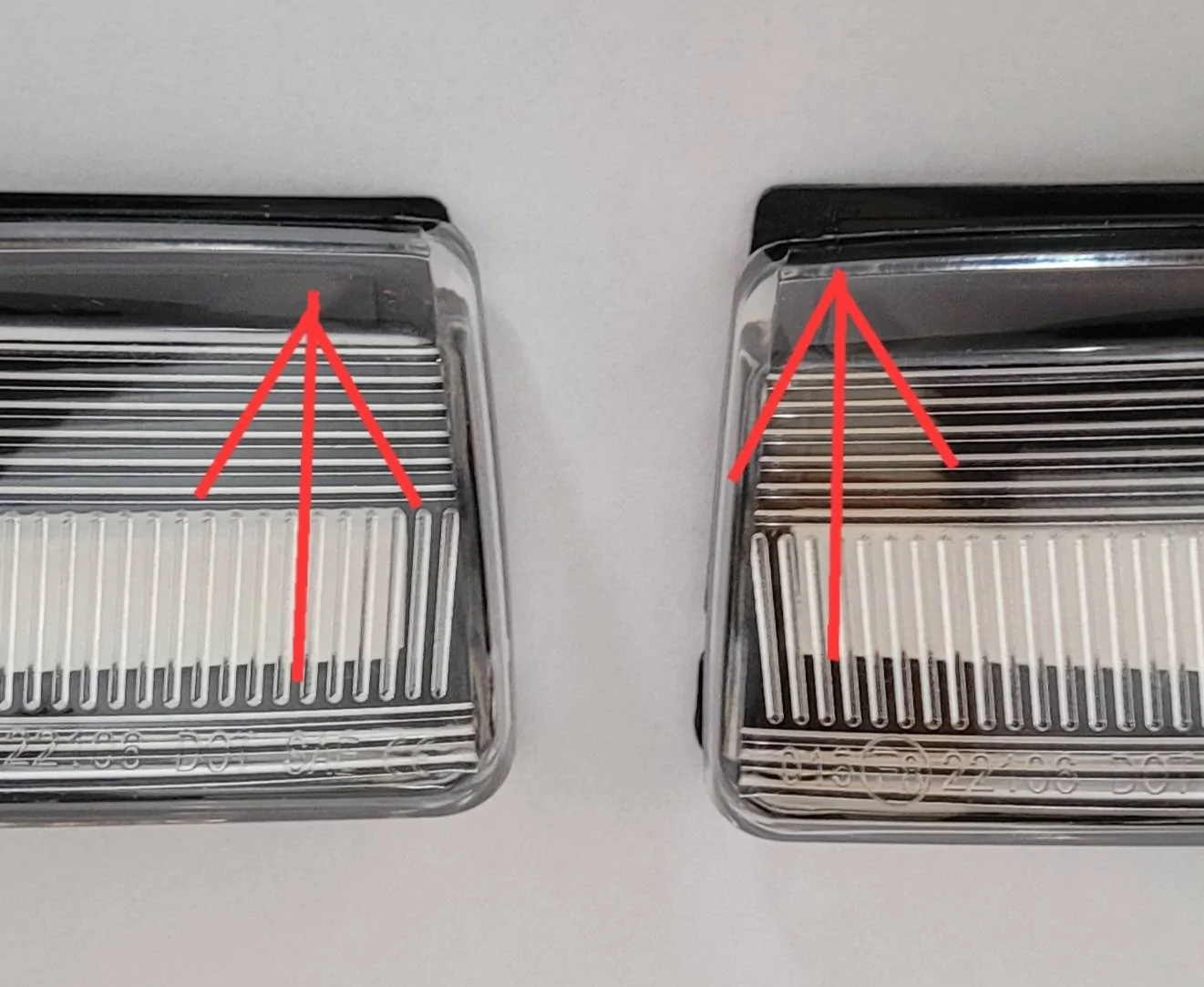

Received the clear sequential turn signals for the mirrors. VERY disappointed with quality of assembly. Both lenses misaligned on back plates. Won't fit correctly in mirror housing.
Hooked it up and really like the function of the LED's. But if it won't stay in mirror it's useless.
But hey, it's the risk you take ordering from a communist country.
I really like how they put Quality Control Passed Inspection stickers on each one.

Sometimes you can luck out. If they use crappy adhesive and the bonds are weak they’re easy to separate. My side markers were like that. I reglued mine and used sealant to keep them watertight too. In a way glad it worked out that way. Otherwise they would have fallen apart mounted

My experience is that the best quality was on Amazon AND had a backplate with same opening as the stock lens - the keyed bulb socket.
The worst quality have a pigtail coming out of a flat back. I did see misalignment on these.
The former actually had DOT markings on the lens also.
