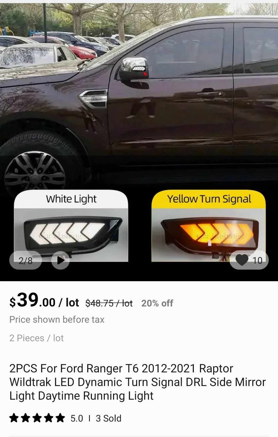

I didn't get these but thought I'd contribute to conversation. These include a DRL feature which there isn't pre-existing wiring for. You'd have to add it.

Are they for N/A? The description says Wildtrack which is not N/A. Also posting a product without a link is grounds for a time-out. You only get one warning, lol.

Proceed at your own risk.
AliExpress: 2PCS For Ford Ranger T6 2012-2021 Raptor Wildtrak LED Dynamic Turn Signal DRL Side Mirror Light Daytime Running Light
https://a.aliexpress.com/_mMusAiI
