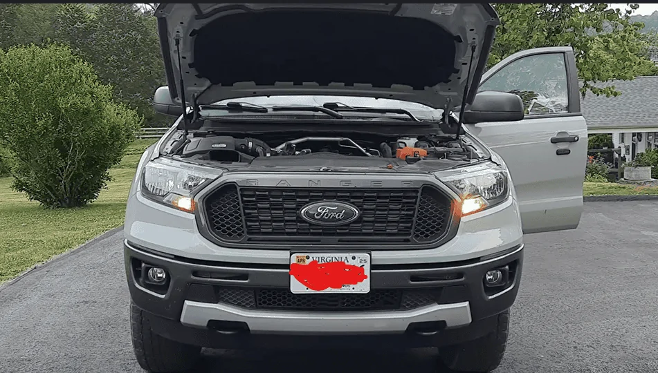

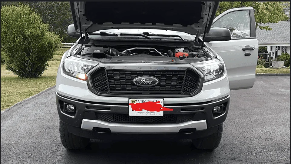

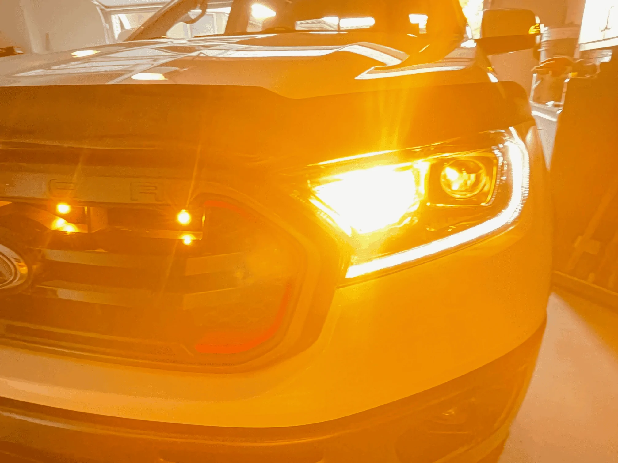

I have a nice vidoe with one Oxilam and one stock turn signal with the flashers on. But not sure how to block out my plate number in a video. (is that really necessary?) So I took a couple of screen shots. Even though this was in daylight, the drivers side is definitely brighter. Plus, you can see that the passenger side never really gets a chance to completely shut off before it lights again. Compared to the LED which has an instant off, instant on capability, which is extremely eye catching. The two pics are with the 4-way flashers running, with only the driver's side turn signal changed to LED. The first pic with both on, the second showing the off cycle with the passenger side still in the process of going dark.

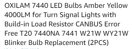

this is the oxilam description from amazon, just the turn signals

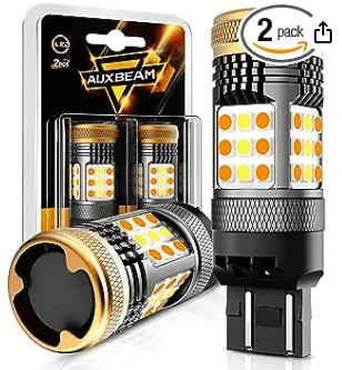

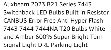

and this is the description of the ones i went with, turn signal and white drl's. i run the drl's along with the grille marker lights all the time

The Oxilam bulbs shown are 7440 bulbs and they will work just fine on a Lariat with the LED headlights, where the turn signals are only turn signals. The halogen headlights require a 7443 bulb. The 7443 bulb is a dual filement type bulb. One for turn signal and one for parking. Notice the 7440 bulb only has two contacts and the 7443 has four. To further confuse the issue the Lariats come with 7443 bulbs but the parking circuit is not wired in the connector.
I have switchback bulbs in my XLT similar to the Auxbeams shown. I run them as my DRLs, along with my fog lights, instead of low beams.
