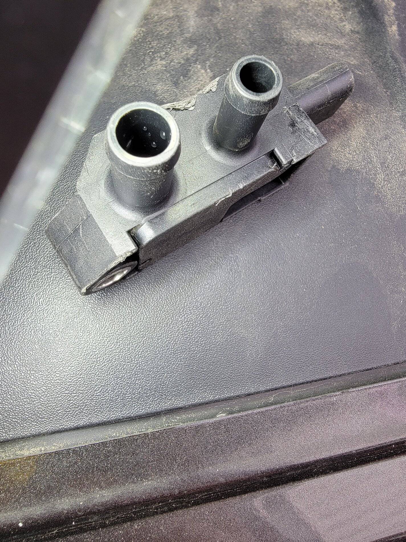

Well, was able to swap the EGR sensor over the weekend. Truck was stuttering pretty bad under light load Friday night taking the wife to dinner. Pulled the sensor on Saturday, one bolt, one electrical plug and 2 hoses and it's off. The crimped on hose clamps are the hardest part, either cut or pry off with a small screw driver. I replaced with small worm drive clamps.
I noticed some liquid (water maybe) in one of the sensor ports of the one I removed. Not sure if that's related to the problem.
So did it fix the problem? I'm not entirely sure. It's certainly not missing for 1-2 seconds like it was Friday night. I still feel an occasional miss on tip-in and I accumulate misfire counts in Forscan, still spread out across all cylinders. I've got to do some more driving and data logging to see for sure.

Other than having to lay across the engine bay to get to it, this wasn't bad. Other than the darn un-service able, non reusable hose clamps.
I had though ignition originally, but it shouldn't be bad across all 4 at the same time. Truck is definitely better after the sensor swap, I've really got to work to get it to hesitate and even then only for a second. Problem is still there though, need to do some more work with Forscan to see what else might be happening at the same time as the miss.

I just replaced LB5Z9J433B like Tim's dealer did and the issue is essentially gone. No more bucking at that RPM sweet spot, about 1500RPM, 30MPH, 7th gear. Idle is also back to buttery smooth.
Dealer insisted that a tune-up would fix the problem, and they wanted ~$300 parts/labor for 4 plugs. I did my own tune-up, to no avail.
LB5Z9J433B comes with the hoses and all, once you got the old sensor/hoses off it is a super easy install. Like Extreme just mentioned the individual sensor p/n shot up in price, the whole assy was actually cheaper. Old sensor was loaded with moisture, dripping wet.
Is there any way to make Ford aware of this problem? I wonder how many more people are having a similar issue.
Good to hear it worked out for you. So is this sensor a common wear part now if moisture causes it to be faulty. My vibration is so intermittent, hard to duplicate on mine but very noticeable. Occurs at any rpm range not specifically 1500-2000. Was leaning towards shimming rear end but might try what worked for guys

Now I'm kicking myself for not ordering two or three at the $15 price range I paid just a month or so ago! Hopefully the replacement will last as long as the original (≈ 3 yrs) and the price will come back to normal. Lowest I've found recently is $58!!

Amen to that. When I ordered mine and installed it I thought I should order some spares since I am sure this thing will need regular replacement. I put it off and now it costs nearly 4 times as much as I paid.

To clarify, I still experience the symptoms related to TSB 20-2277. Even though I had my dealer carry out said TSB the driveline vibration when accelerating from a stop is still there, I saw those posts about shimming the carrier bearing and I'll be trying it soon.
LB5Z9J433B solved my random misfires at the RPM/speed/gear I mentioned above, I don't believe the two problems are related to one another.
