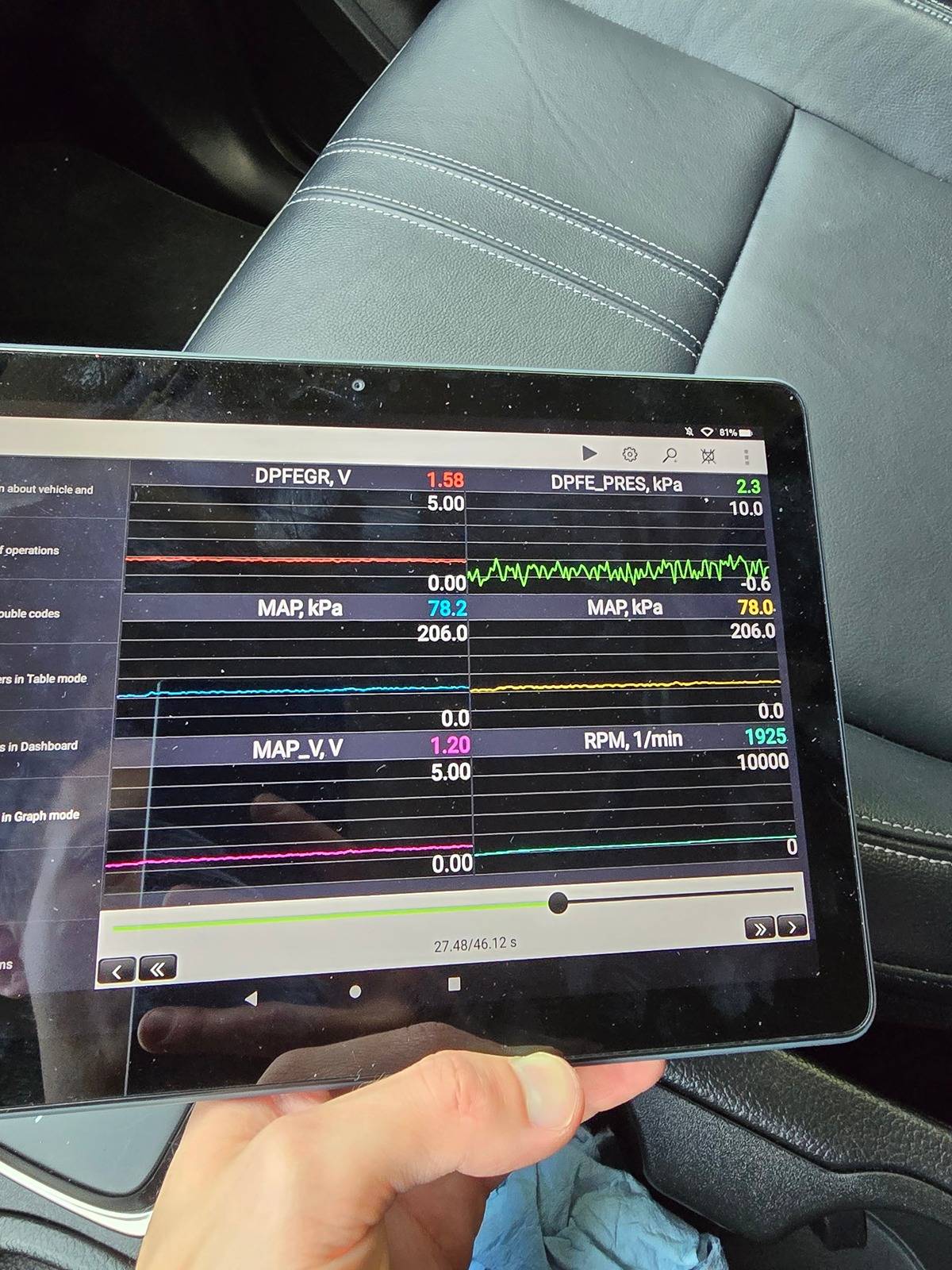

I took some more data today regarding this issue. My truck hasn't progressed to the point where its not driving well, but I feel some studdering in the mornings, especially when its damp. It also seems to have an increase in misfire counts when easing back on the gas lightly after letting off such as when accelerating out of a turn. DPFE sensor was replaced sometime last fall so its about 6-8 months old.

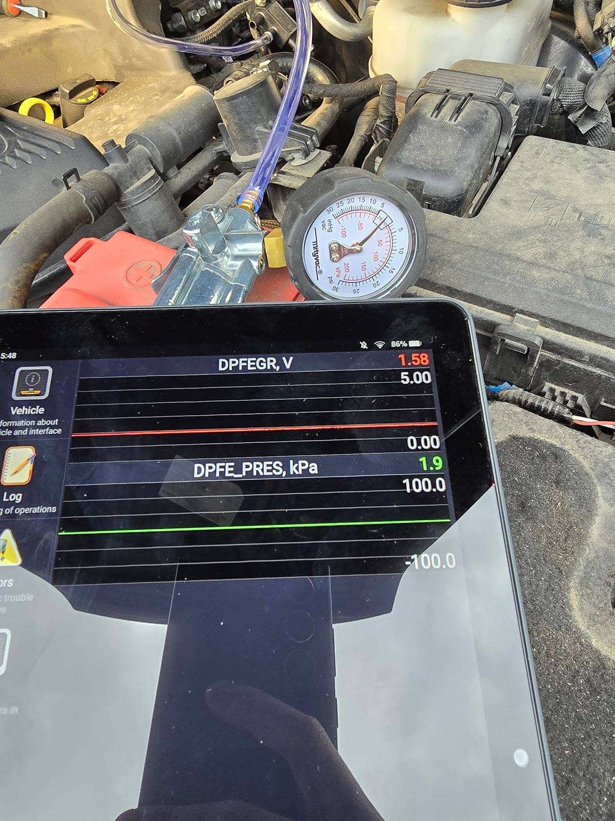

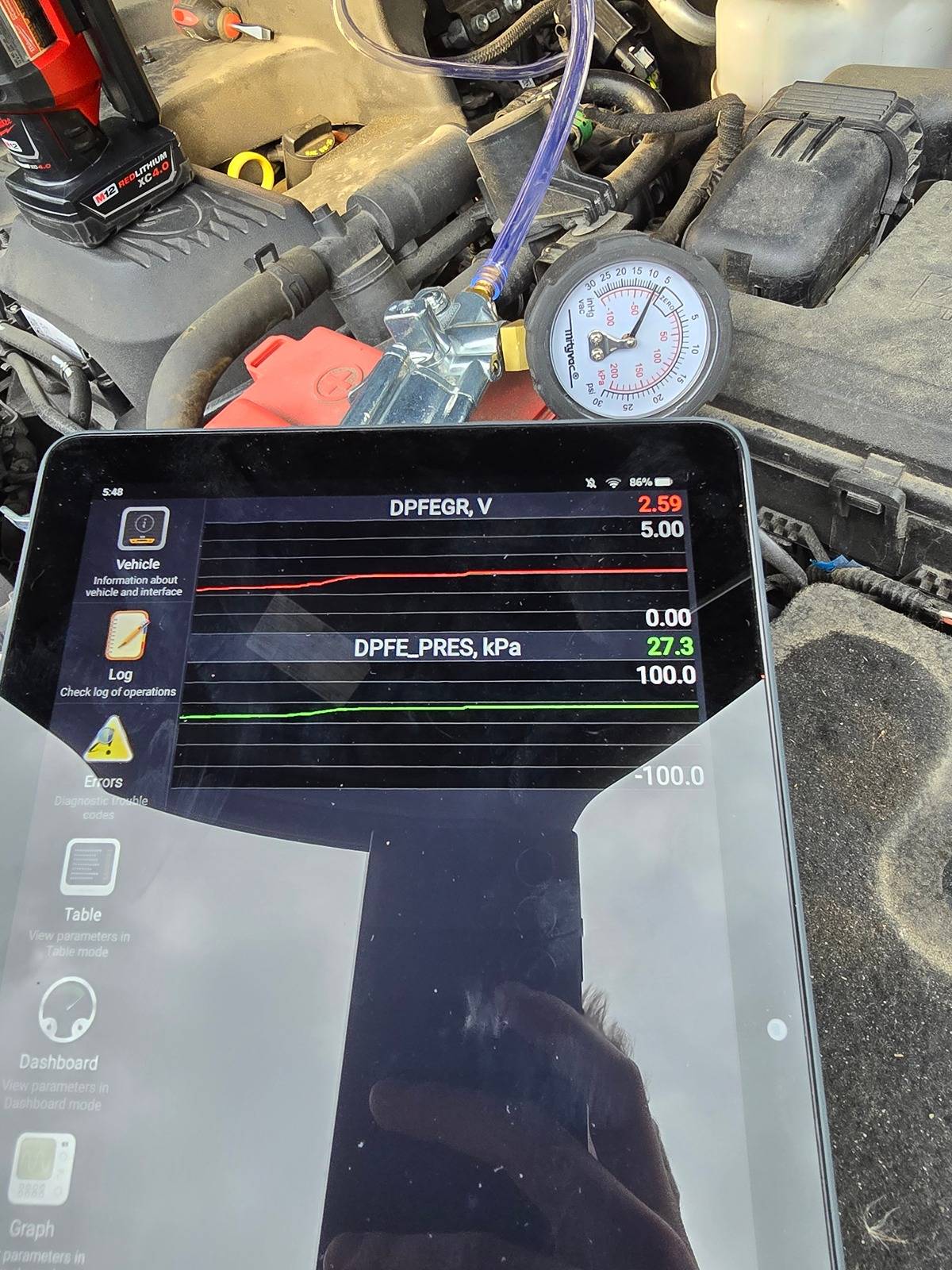

First up is a manual vacuum test of the current DPFE sensor. Approximately 1.5V at 0 pressure and a steady increase/decrease with the vacuum applied. Sensor is quick to respond and no weird spikes or dips.

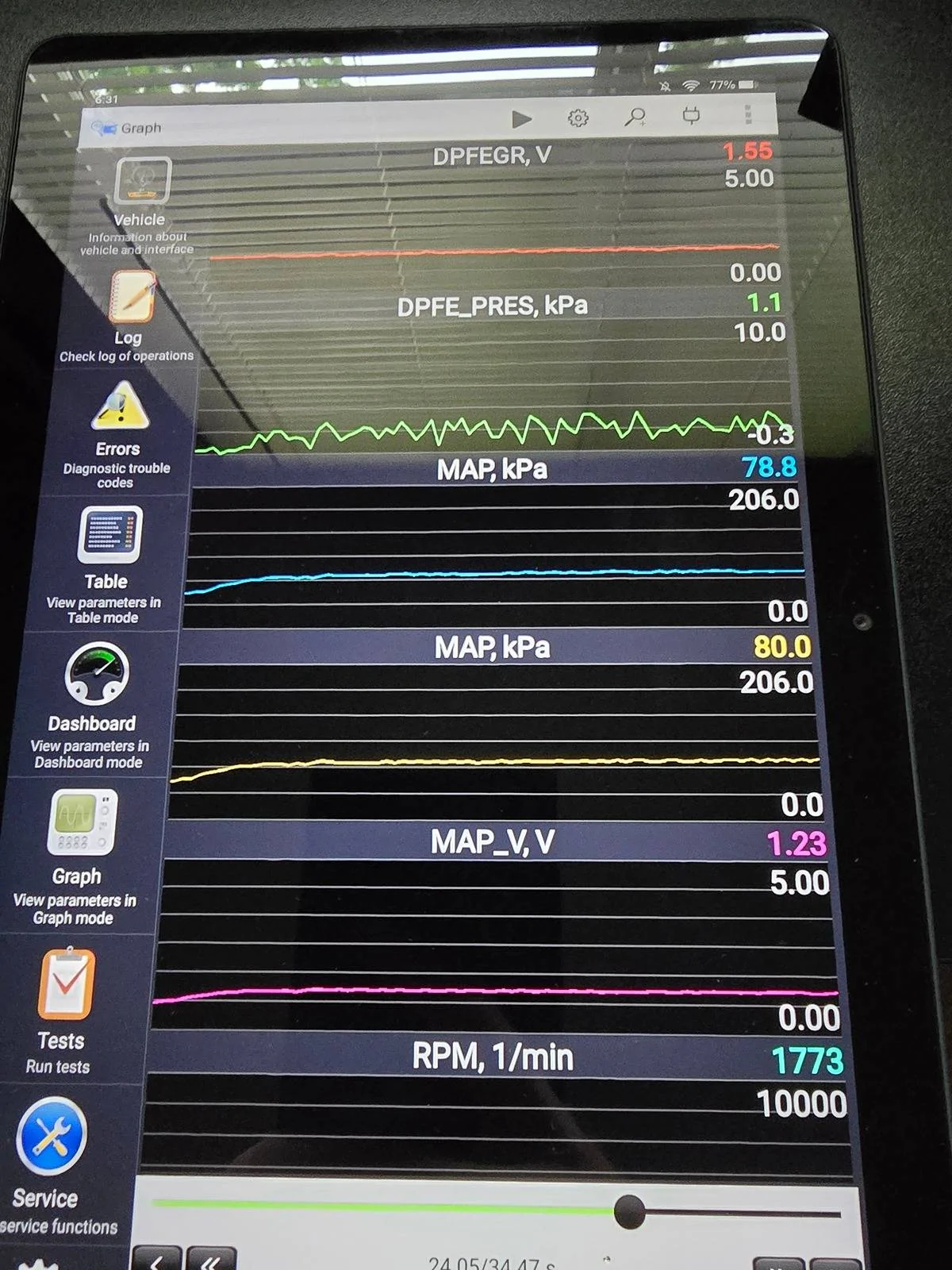

Next, I tested in vehicle using the process described by airline tech a few pages back. Sensor showed no flow and 1.5V at idle, flow and voltage increasing when in drive, on the brakes, and holding at 2000 RPM. The DPFE voltage is more or less steady, but the pressure reading seems like it jumps around a lot, even if its following the general trend of the voltage.
Next, I swapped in a new sensor and repeated the in vehicle test. Same behavior as before. Conclusion, no issue with the DPFE Sensor?

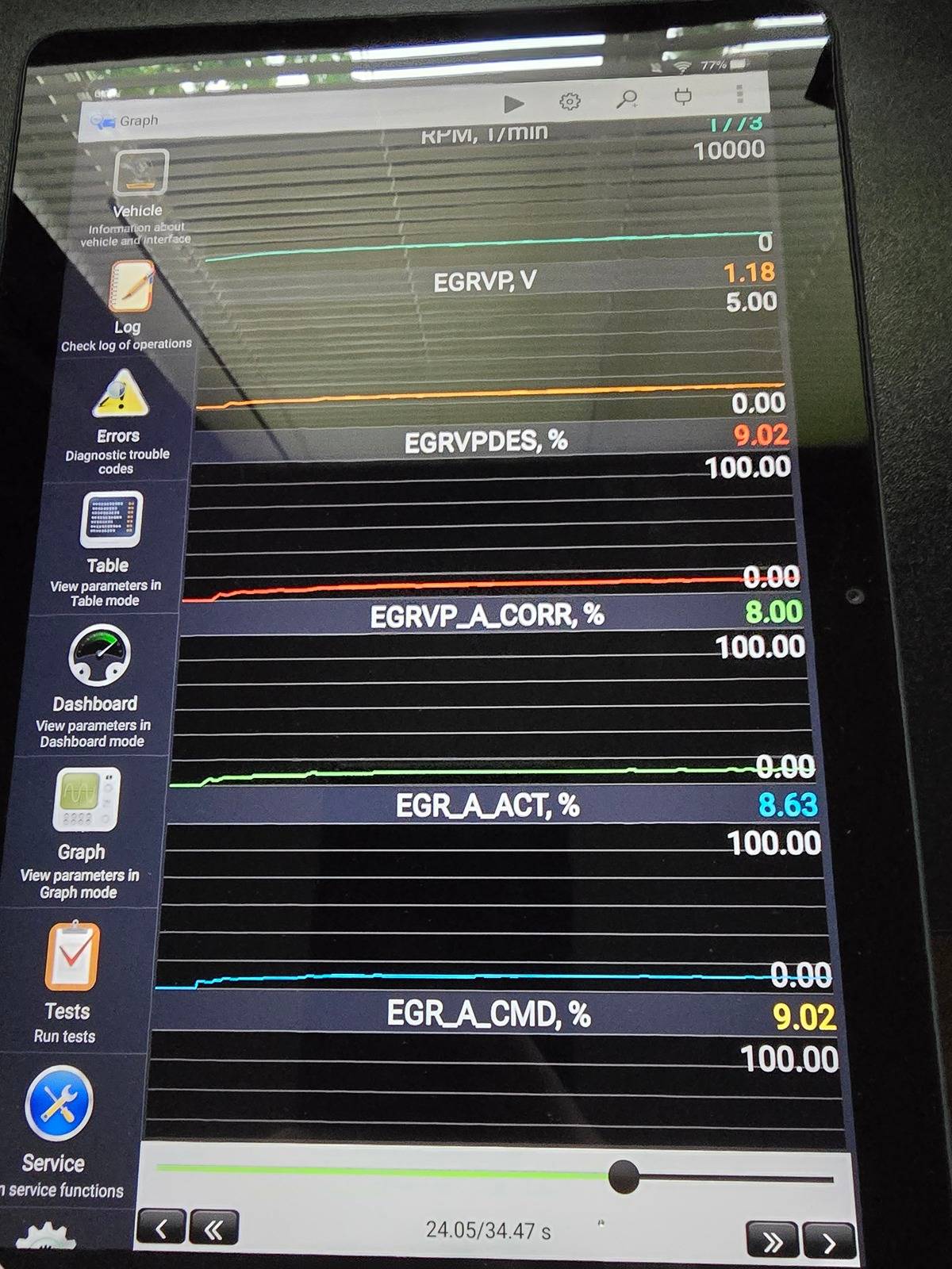

I checked the EGR position, its opening, 0 at idle, 8.5%-9% at 2000 RPM during the test which matches the numbers airline tech posted.

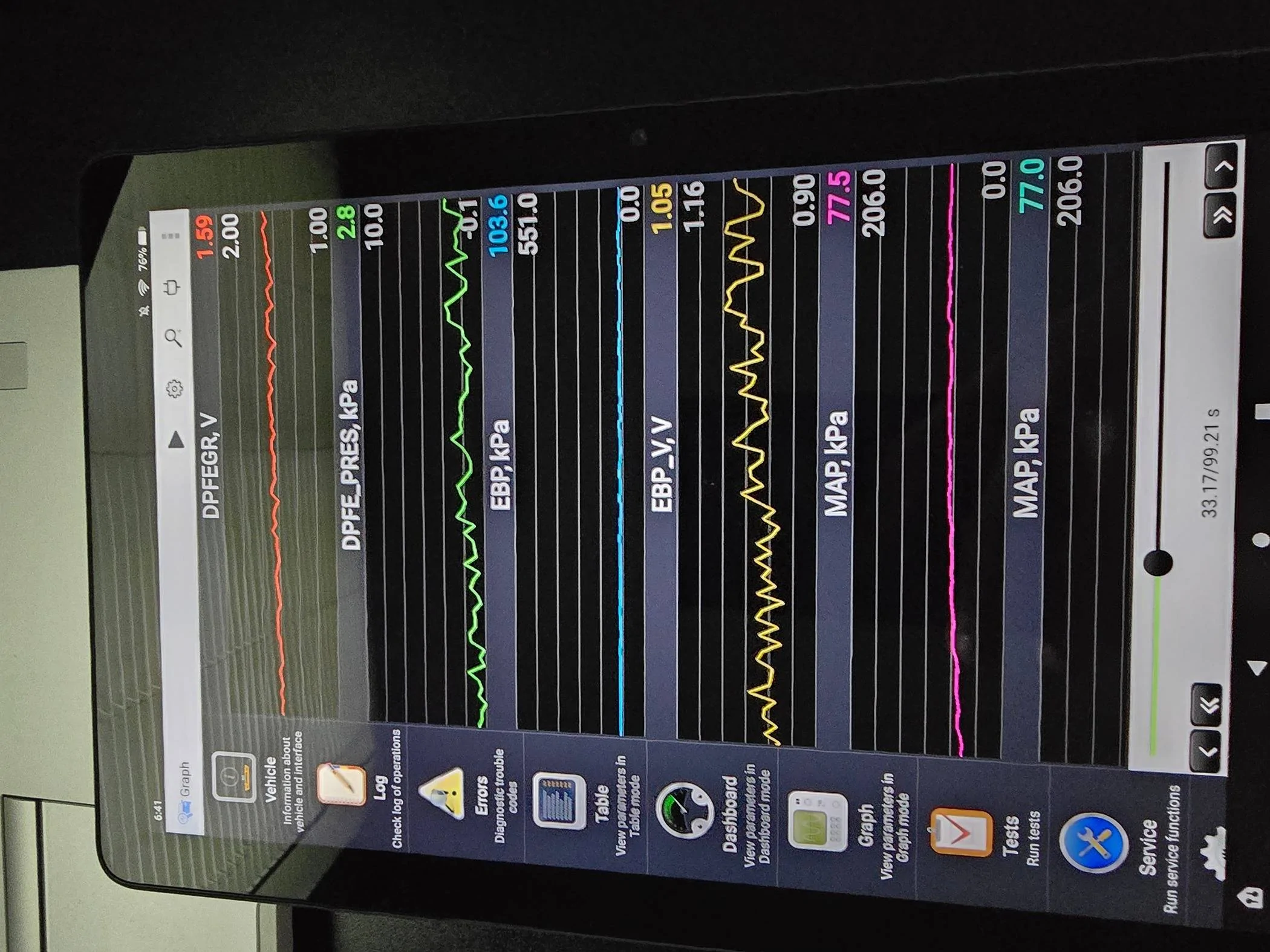

Next up, check the Exhaust pressure sensor voltage. This doesn't seem to move much, but it does move. I see the greatest change durring sudden change in RPM, but generally it increases with RPM. The amount it changes is miniscule though, like 0.99V at idle to 1.07V at 2000 RPM. I've no idea how the computer separates signal from noise at that level, but my readings match the values shown by airline tech, so maybe its correct? The signal is not smooth, there's a lot of ups and downs, but EGR position is stable, so it doesn't seem to be affecting how that opens.
So Im a bit stumped at this point. I feel like the DPFE pressure should be smoother. The voltage is smooth, so there's something else that is feeding into that calculation that is making those peaks and valleys. Maybe its the Exhaust Pressure Sensor? If that's cheap enough and easy enough to get to, maybe I will swap that out and see if there is any change. Maybe I am expecting too much out of the thing and it just doesn't drive smooth, but that's not something any of the other vehicles I've owned have struggled with.

If you ref post #652 - Mr. Busses - Drive Cycle, post he mentions the fluctuating DPFE Pressure, before replacement, but I do not know if that became stable after Tube & Sensor replacement.
Other than that, from what I see with what was posted - all readings appear normal
The Map & EBP readings appear normal range as well.
