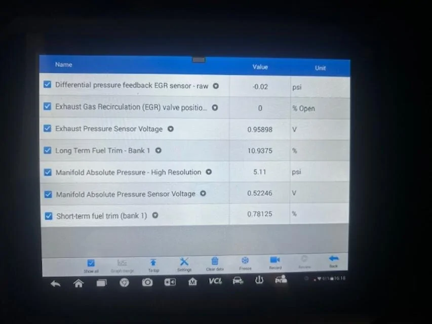

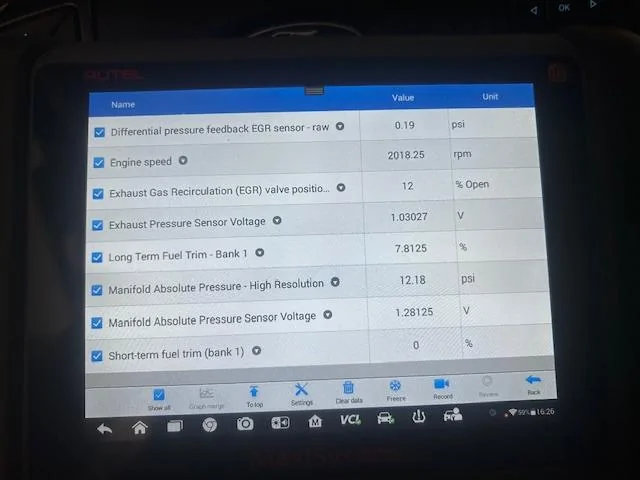

Not quite the Data Pids I wanted to show, but at least with a capable scan tool you can see the system and get it to activate without a Vacuum Pump.
Now to clarify scan tools will sometimes display opposite of what you want to view.
With my Autel the DPFE is displayed in PSI vs Voltage
So, we take the test procedure for the DPFE, note these parameters have been updated to a more accurate reading in the current manuals.
Normal: (KOEO) = Key On Engine Off
1.3 to 1.7 Volts or (-0.06 PSI) - which should show a average reading of 1.5 Volts. (No-Flow)
Now when you start the engine and are at idle, this reading should not change.
Reason the EGR Valve is closed (No Flow)
The manual has you disconnect the hoses at the DPFE and apply a vacuum to the sensor and record your voltage readings / PSI.
Apply a vacuum of 8-9 Inches of vacuum to the small port of the sensor and hold for 10 seconds.
you should see these PID readings on the DPFE Sensor
2.5 Volts or 3.62 PSI (25 KPA - Converted)
Release the vacuum and the sensor reading should return to original reading within 5-Seconds.
Now to understand (1) factor for the EGR system to operate, the engine has to be under a load.
So, a quick alternate way to see the EGR Valve open and close without a full-on test is this:
Bring engine to operating temp and hook up scan tool and bring up relevant PIDs.
Take at IDLE readings of the DPFE sensor with the EGR Valve closed, should be closed at IDLE
Set the parking brake and place into drive:
HOLD BRAKE PEDAL
Increase RPM to about 2,000 RPM
You can now see the EGR Valve open (to about 10%)
Now you look at the DPFE sensor PID, the Voltage & PSI should rise, indicating FLOW, a second verification of flow is the MAP Sensor (PSI) Rise, exhaust flow into the Intake.
A third verification of flow is the Exhaust Press Sensor voltage rise:
Note this is not the DPFE sensor, this is the Exhaust Back Pressure sensor downstream of the EGR Cooler. The system uses this input as a source of data for actual EGR Valve position.
Bring engine back to idle, and all of the IDLE PID readings should return within 5-Seconds.
Basically, a simple test, to ensure that the EGR Valve opens and closes and also checks at least partially the DPFE sensor's ability to sense flow and return to no flow readings.
What you are looking for: DPFE Readings, you want to ensure that the DPFE sensor is reading (zero flow) when the EGR valve is closed, and you want it to sense flow when the EGR valve opens
This is not a full-on test of the system but at least gives the ability to get the DPFE sensor to activate.
Being that (IF CODED) the most common code reported is P139C, this code is generated by the EGR system monitor (Test Results)
Once per drive cycle, the system will perform self-tests, normally at Idle but due to the ASS system this is performed OFF Idle.
Part of this test is closing the EGR Valve and looking at the DPFE sensor readings.
If the sensor is out of range (Lower or Higher) than normal it will trigger code P139C
Now a Bad Sensor, Plugged Orifice Tube or Disconnected or Lose Hose can be at fault.
A faulty DPFE sensor is the most common, so it is not reading flow when the EGR valve opens, or it is reading flow with the EGR valve closed. (Lower or Higher) than normal readings or inaccurate flow readings when the EGR Valve opens, reading higher or lower flow rates compared to actual valve position.
This flow rate along with the EBP (Exhaust Backpressure) reading, determines the EGR valve open position with various other data inputs.
Example PID's at Idle:
ERG Valve Open @ 2000 RPM
This test will be helpful, for those low speed (Low RPM) stumbles, hesitation issues.
as you can see the EGR Valve Open and Close.
If you feel the stumble, hesitation or bucking while doing this test, look at the DPFE sensor readings and EGR Valve position or do an Indepth troubleshooting test.

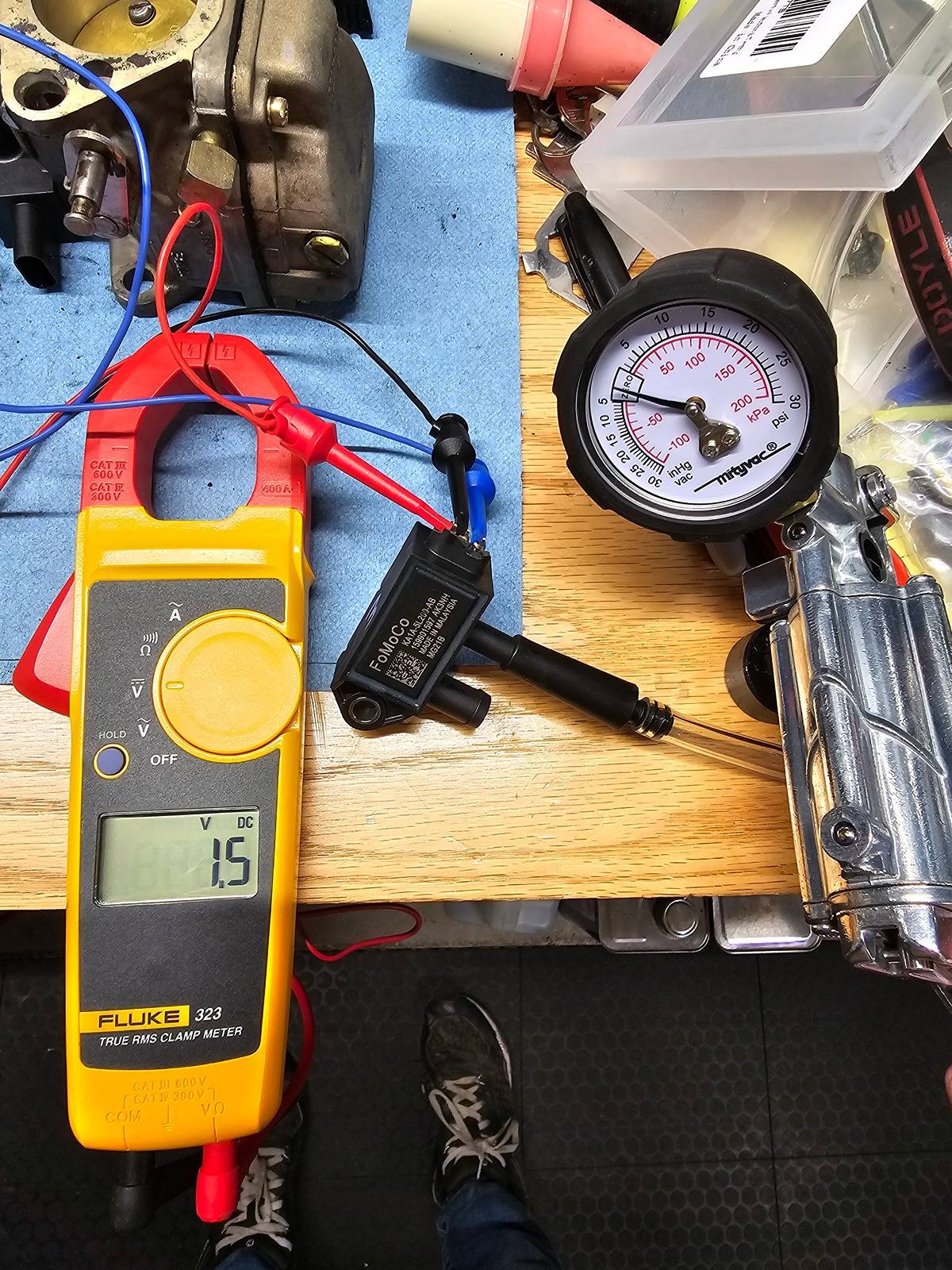

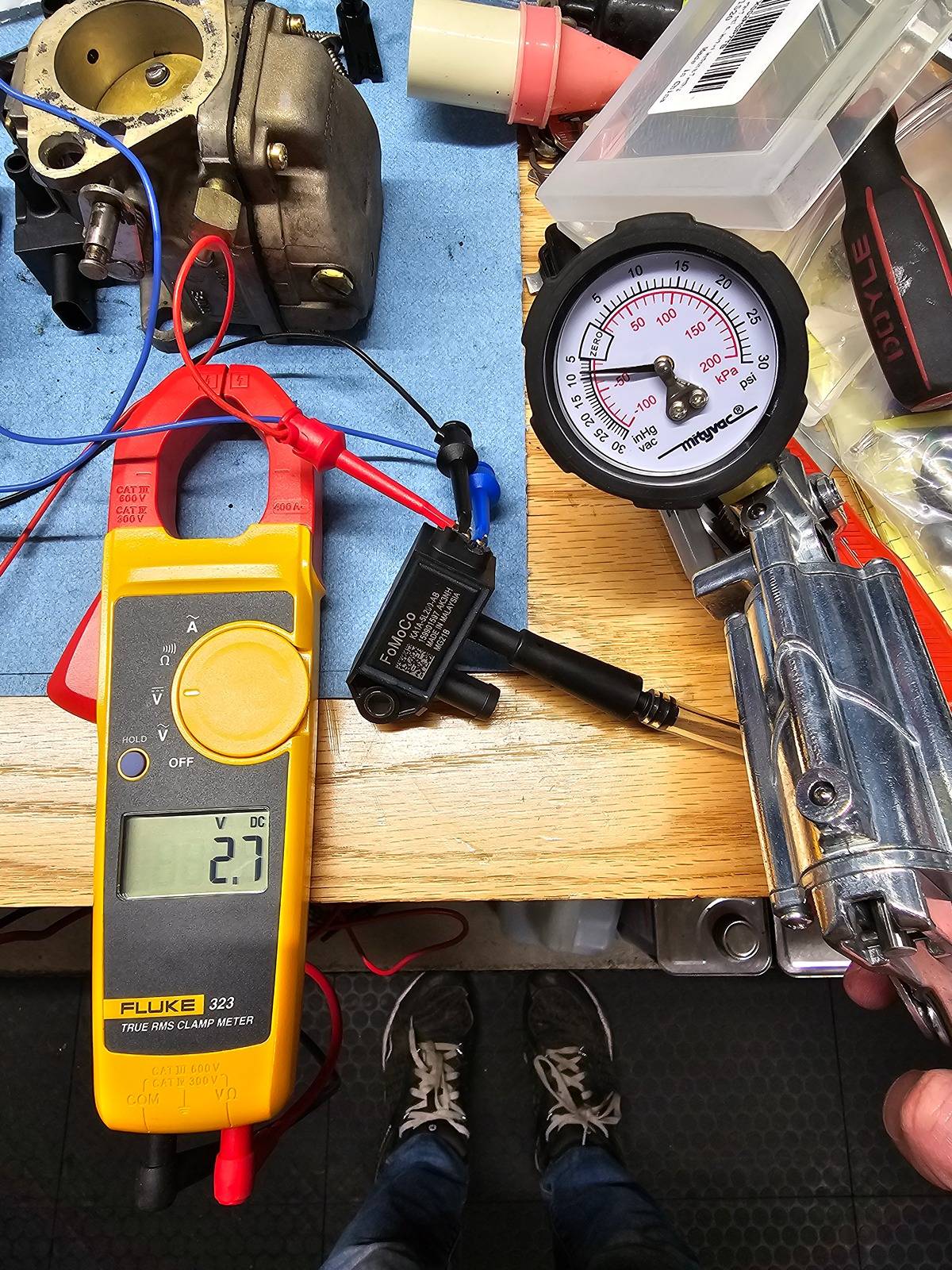

Had a chance to do some testing today with some of the old sensors I have replaced on my truck. I've changed about 5 out in the 42k I've had it chasing a studder/missfire at tip in. The sensor replacement does seem to make a difference for a bit, but it always ends up deteriorating. Some days worse than others, it does better in the winter and when it's dry and worse on cool damp days.
I tested 3 sensors I had replaced on the truck because of hesitation before. I tested on the bench with a 5V power supply and a handheld vacuum pump. I'm comparing function against the specs Airline Tech posted above
At atmospheric, all 3 sensors read 1.5V, so that checks out ok.
At 8in vacuum, I'm reading 2.7V. I'm guessing that's close enough to 2.5 and that my vacuum gauge isn't that precise.
All 3 sensors returned to 1.5V as soon as I dropped vacuum to atmospheric, so I can't see anything wrong there even though they weren't working well in the truck.

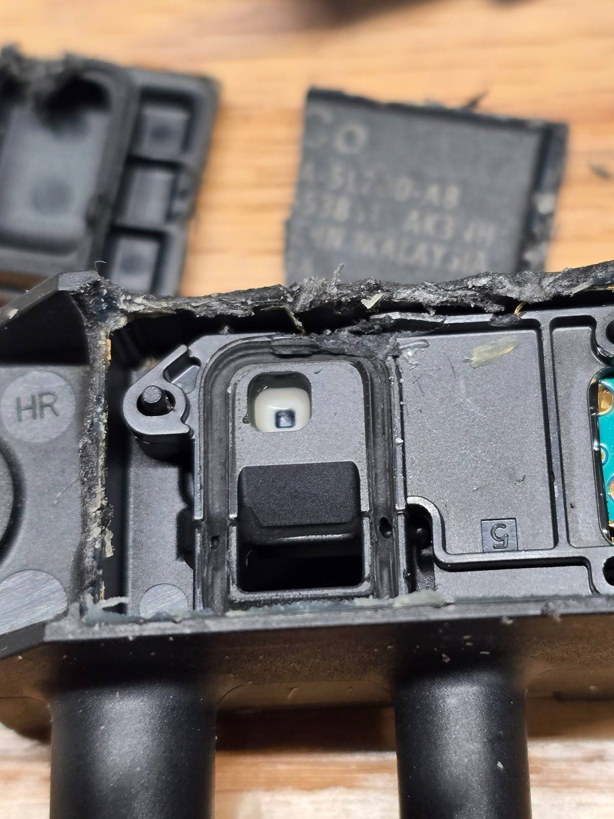

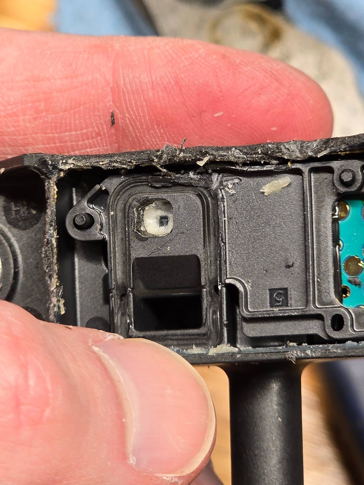

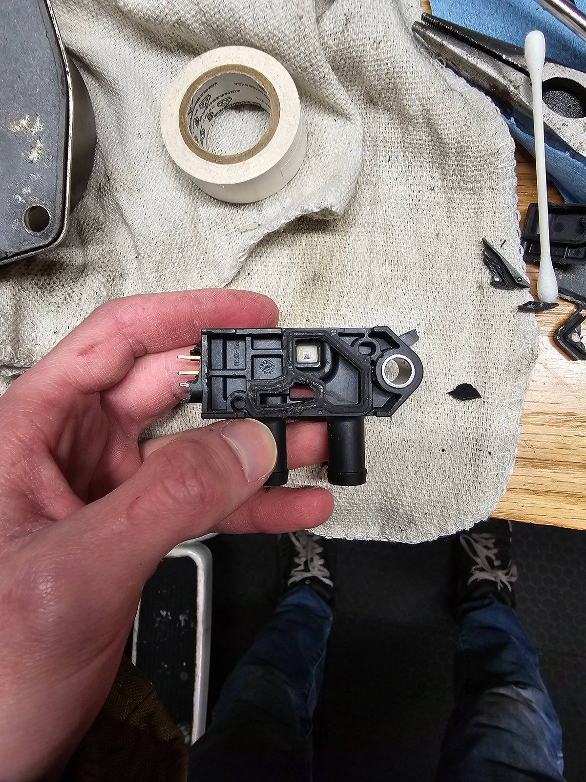

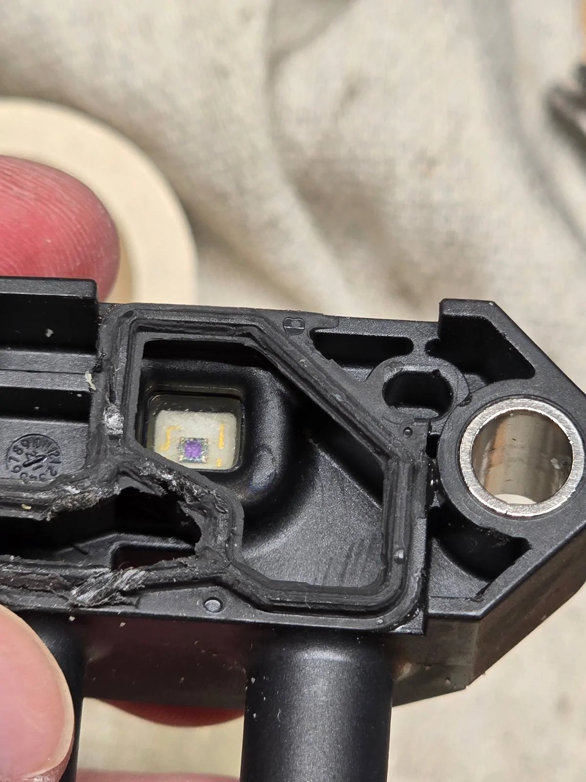

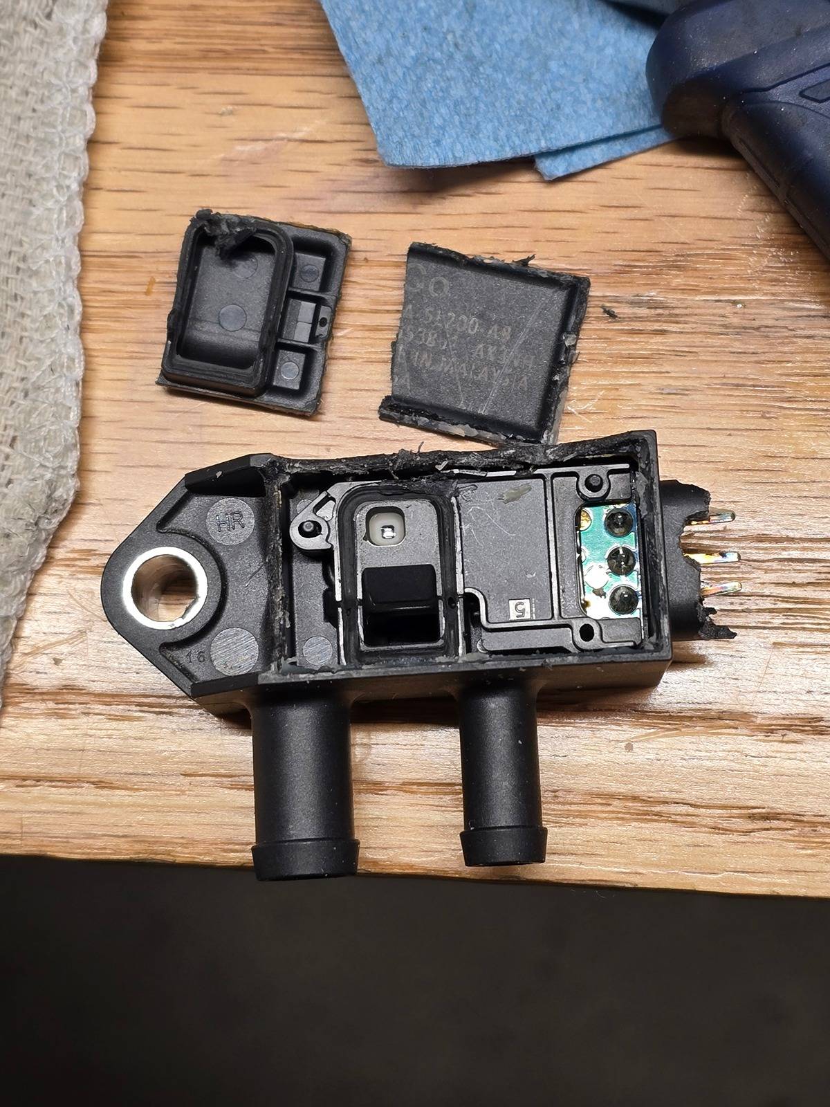

I also opened up one to take a look inside. There's not much there, just a single sensor that sees pressure from each port on each side, hence the differential in differential pressure sensor. I did notice that the sensor face is potted with some kind of material. This should mean that the water we see in the sensor when it's removed shouldn't affect it.
So I'm stumped. Not sure what actually breaks in the sensor or maybe it's a temporary condition and it goes away when the sensor sits. I suppose I could pull the sensor that is currently on my truck and test it. It's not the worst it's been, but it does.have hesitation occasionally...
It is likely that nothing 'breaks'. What I think happens is that the moisture gets into the sensor substrate and either causes the signal to change or causes some bond to be weakened that changes the signal output.
