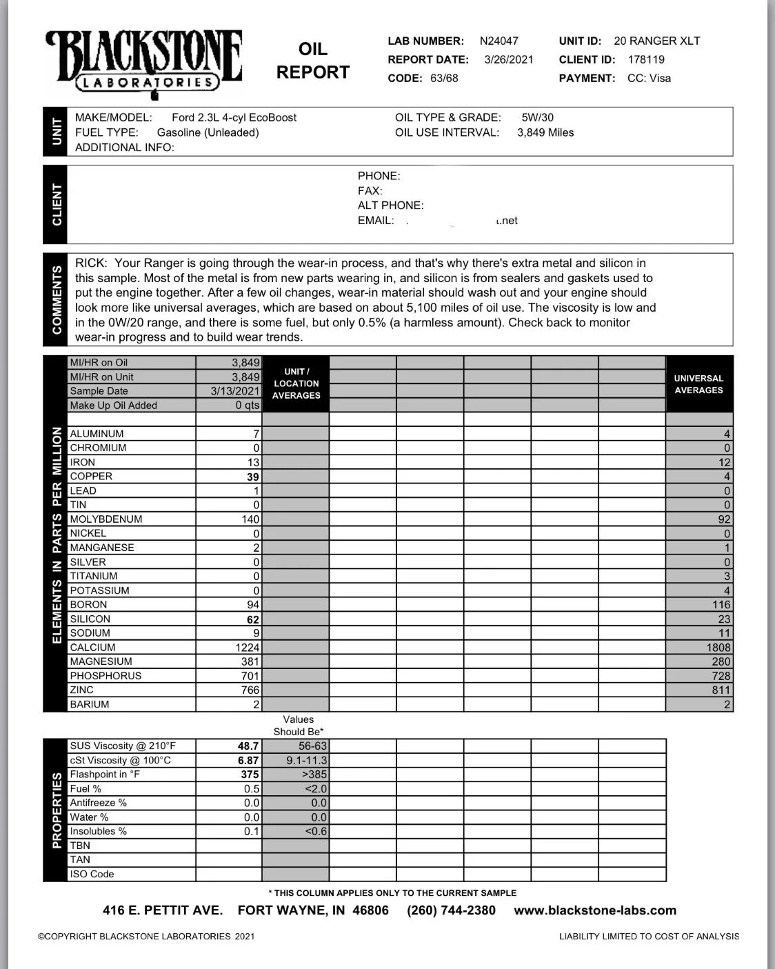

That’s mine. I have a little fuel but I’m not worried about it unless it gets high and stays there. The metals amount on a new engine is within normal. I’m at the point mileage wise now where I can wind it up a few times to max and get rings set and should be good to go with the next analysis check.

I really like the comments section giving a summary of your results. Does this come standard with every report?

After seeing some information on this Site about Blackstone testing, I was going to change my oil right away having 2623 currently on the odometer. But I talked with a guy today (an oil analyzer at Blackstone) and he said that it was an extremely unusual circumstance to see a new vehicle tested at 3000 which has any concerning contaminants. So, I've decided to change at 3000 and have it tested and then decide what to do about testing when its changed again at 8000. This falls below Ford's schedule gap to change oil every 5000 if you are not following the oil-life monitoring system which meets warranty requirements. Dave (who has proven to be an expert mechanic and is current on automotive technology) gave me the same advice as your mechanic, so I trust this advice. And on top of that he likes Rangers ?
