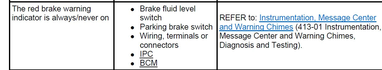

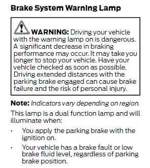

are we sure we dont have an indication?? the spread of false information is an embarrassment
Thanks. I stand corrected! I should know better. Research, Research, Research.
Ebrake worked fine.
No level sensor.
So @CB750F since you stated "No Level Sensor" you might want to have them check that at the dealership while it's there.
But how do you know this is accurate? Our owners manual suggests we have a cigar lighter, among the other errors that have been pointed out. Certainly enough to anger Phil into telling us about that aspect of his job at Ford.
Maybe you'd be willing to suck brake fluid out of your reservoir for our edification? Just a thought.
