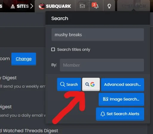

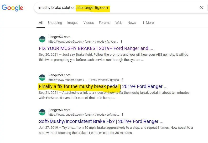

To add to this great advice, I find the in-forum search to be abysmal. It's not like a Google search and doesn't combine the words for the results. =(
So if I search for mushy brakes, in the forum, it'll likely get results that talk about "What did you feed your Ranger?" Mushy Peas! or lots of brake upgrade posts ...
I know of two ways to do a better search.
1) So I usually do this in google, I put in my terms and then site:ranger5g.com

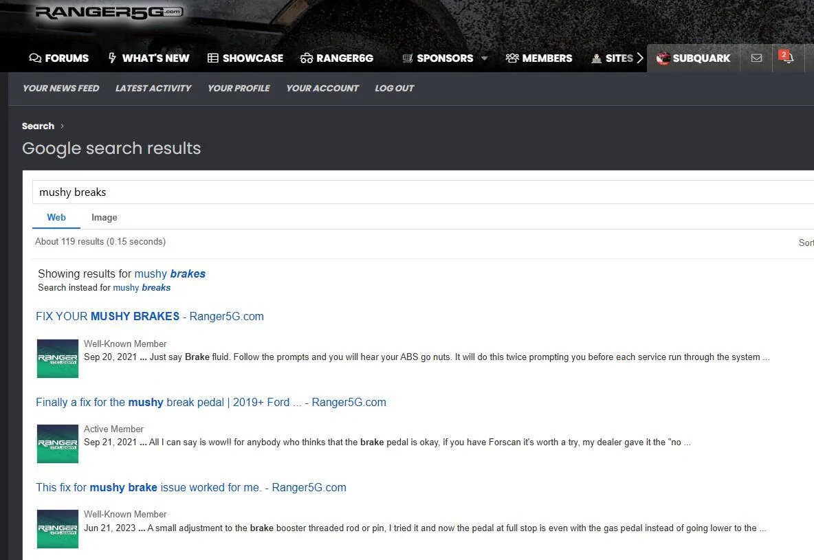

2) The same is accomplished in the forum search IF you use the google button, and it'll do a real google search and fix your typos (I wrote breaks here):
