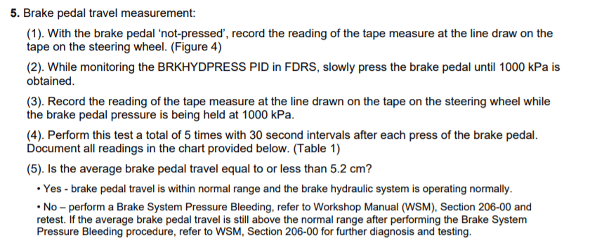

did you carry out the test as per this?
5.2cm of travel is what i am asking you if you got.
thats 2.047" of travel.
if you're getting a longer stroke than that and your pedal is too far down, then you perform the brake bleeding procedure and see if that changes it. Have you already had your brakes bled? or are we jumping the gun here?
What a batch of BS! If you pump the brakes 5 times in 30 seconds you will have a good high hard pedal. I don't have to pump the brakes on any other vehicle I drive. No, I have not had the brakes looked at but I will. If you look at the pictures I sent, you can see the pedal is well below the gas pedal as I stated. Even someone with a very low IQ can see that's not right.
