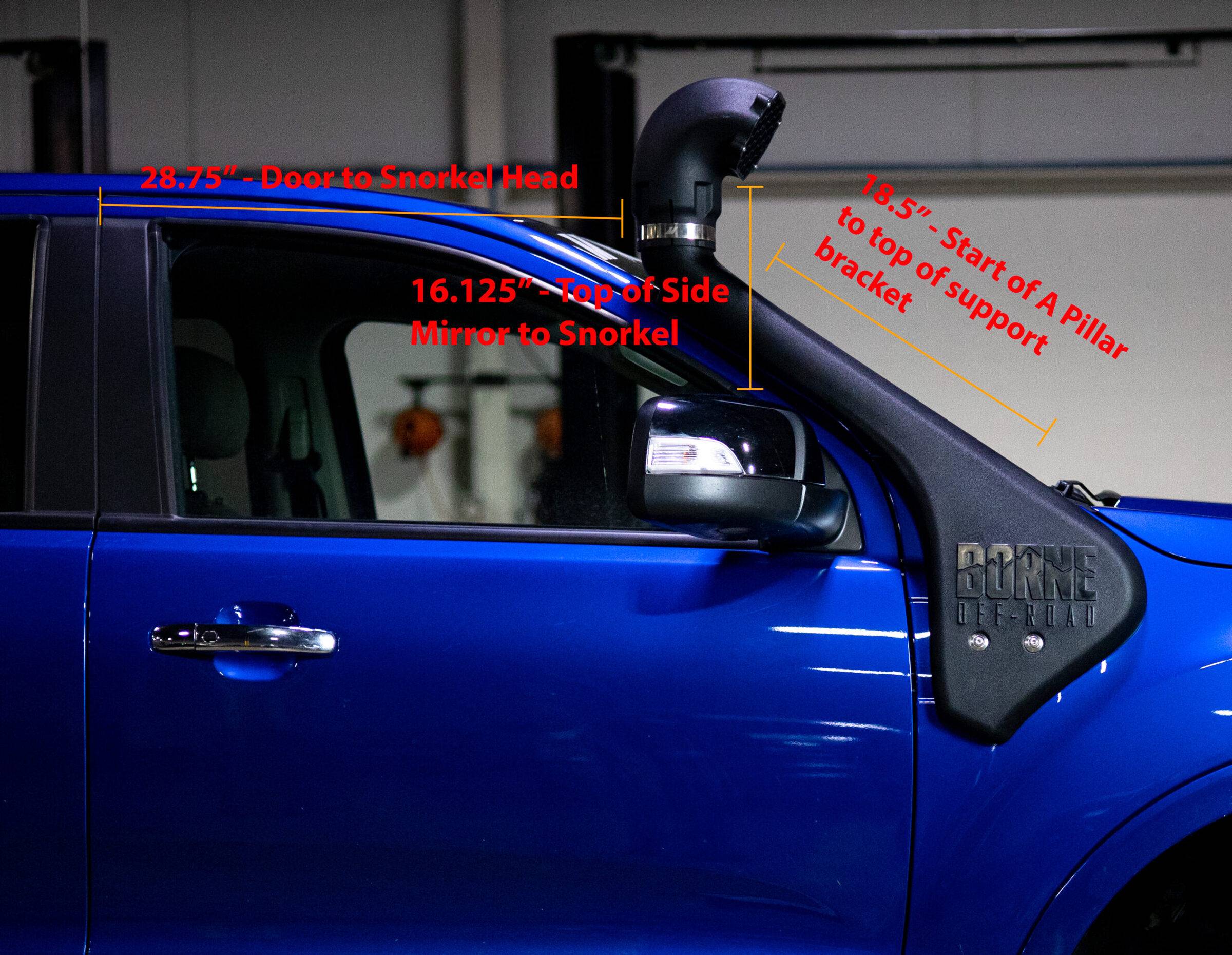

Damn, I've got it sitting in my cart ready to buy, but I am a little concerned about clearance with my rack...
If you can spare a moment can I get some sort of measurement on the snorkel distance from the roof line? (towards the windshield). I just can't tell from the photos if the end plates on my rack will clear it.

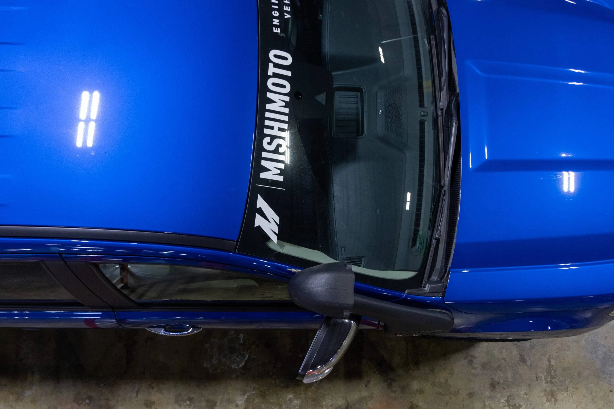

From the look of your photos you should be ok, but if you want to double check, I popped out to our truck and took some measurements for you:
As well as an overhead view for a little better perspective. The head of the snorkel is about 3.5" offset from the black roof trim:

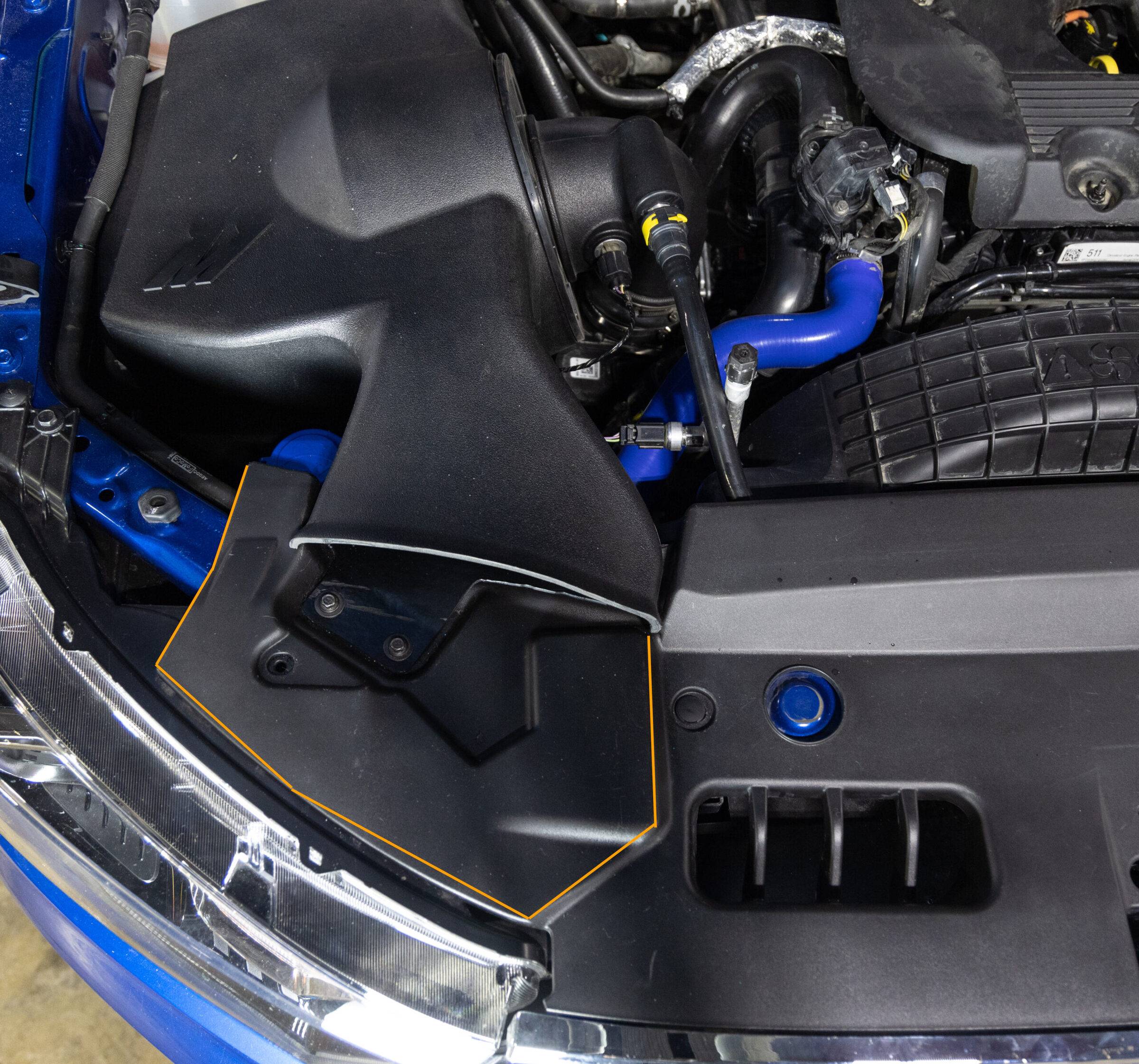

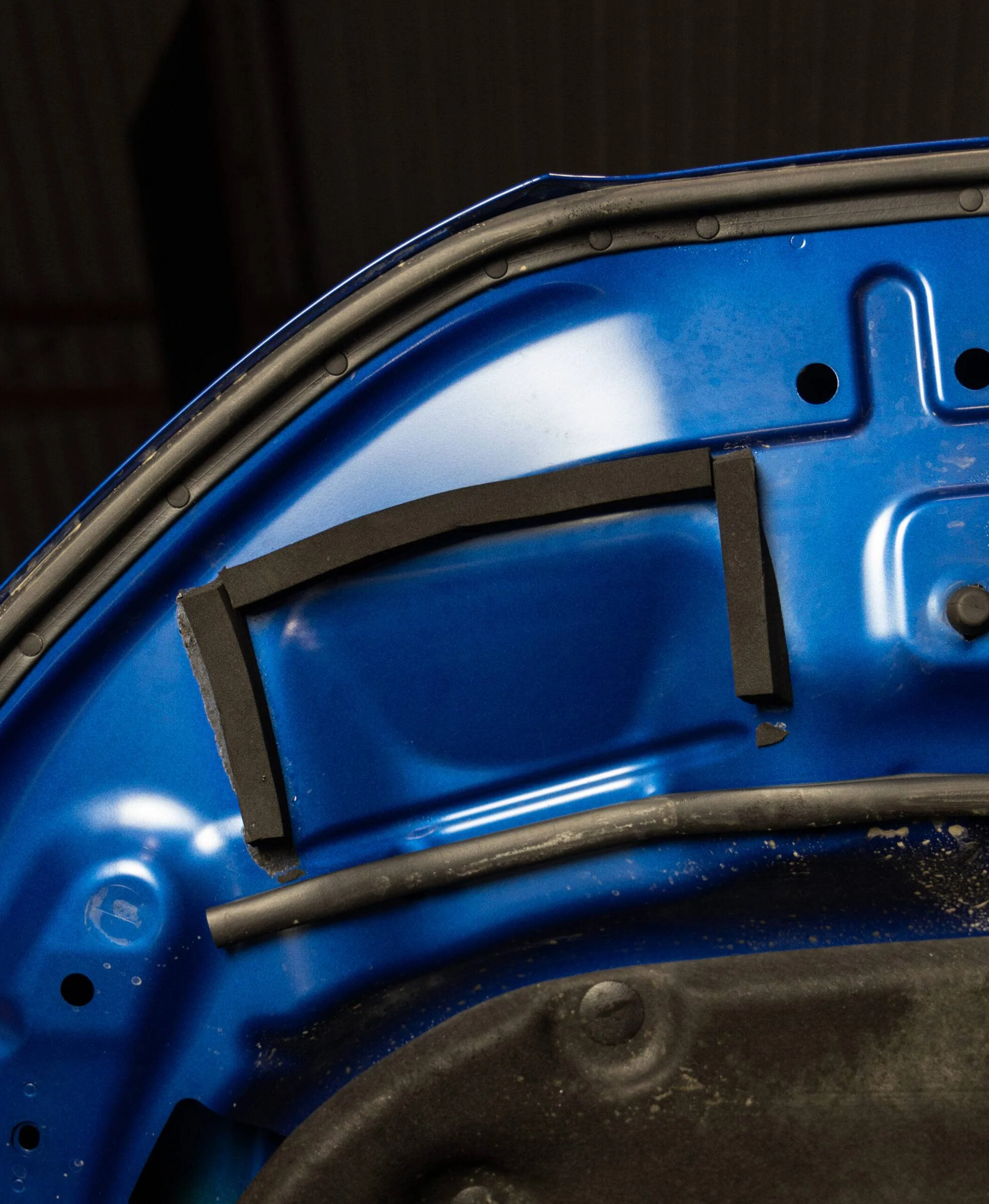

Glad that its finally released!! Just one question though.... What is done about the factory intake snorkel?
Great question!
We wanted to make sure that your airbox seal was best suited for your truck, and who knows your trucks/rigs better than you guys! With that, we do have two suggestions to block off your airbox no matter which kit you're running.
First - Weathing stripping the factory inlet. We suggest a 1" expanding foam weatherstrip with a crush depth of 1/4" to avoid a lop-sided hood when installed. This method will require less fabrication but is much simpler to install. You can fix the stripping to the hood directly or mount the weatherstrip on the upper radiator support:
The second option is to use sheet steel as a plug and seal the box using a polyurethane adhesive that's suitable for your environment, ideally -25-185°F.
