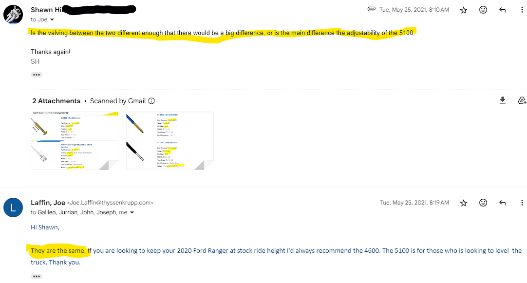

4600s are valved alittle softer than 5100s, still digressive obviously, but tuned for a stock height configuration.
5100’s are tuned alittle firmer to account for increased ride height and a larger tire.
i called bilsten a while back and they explained it in detail, but that’s the gist of it.
costs are not much different between the two.
That's not the message I got from Bilstein when asked. They told me they are valved the same. Only difference (According to Bilstein) is the fronts that are grooved for different ride heights.
Also the 4600's in the rear can not accept higher ride height in the rear. The 5100 can take up to a 1inch lift in the rear. But on their own will be stock height.
weird. can’t even get a straight answer anymore on what’s what, so who knows.
at this point- all i know is one is zinc, one is yellow.
