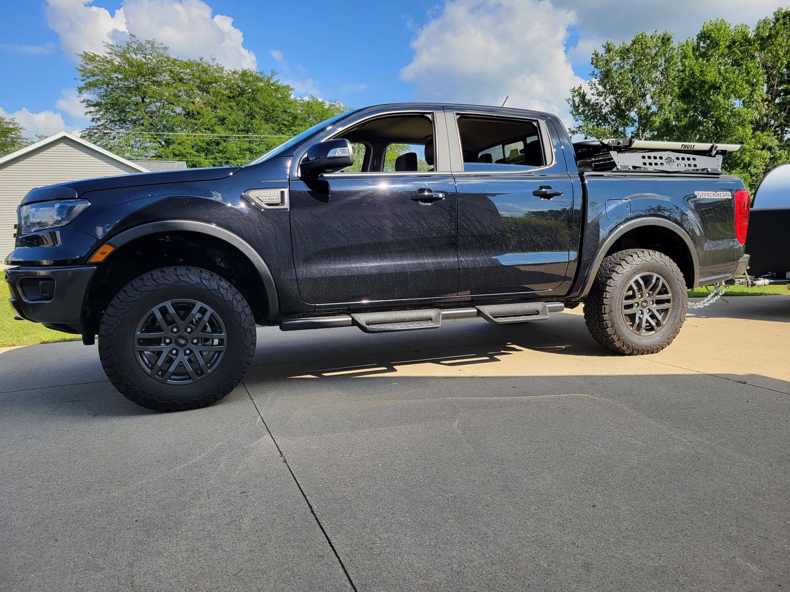

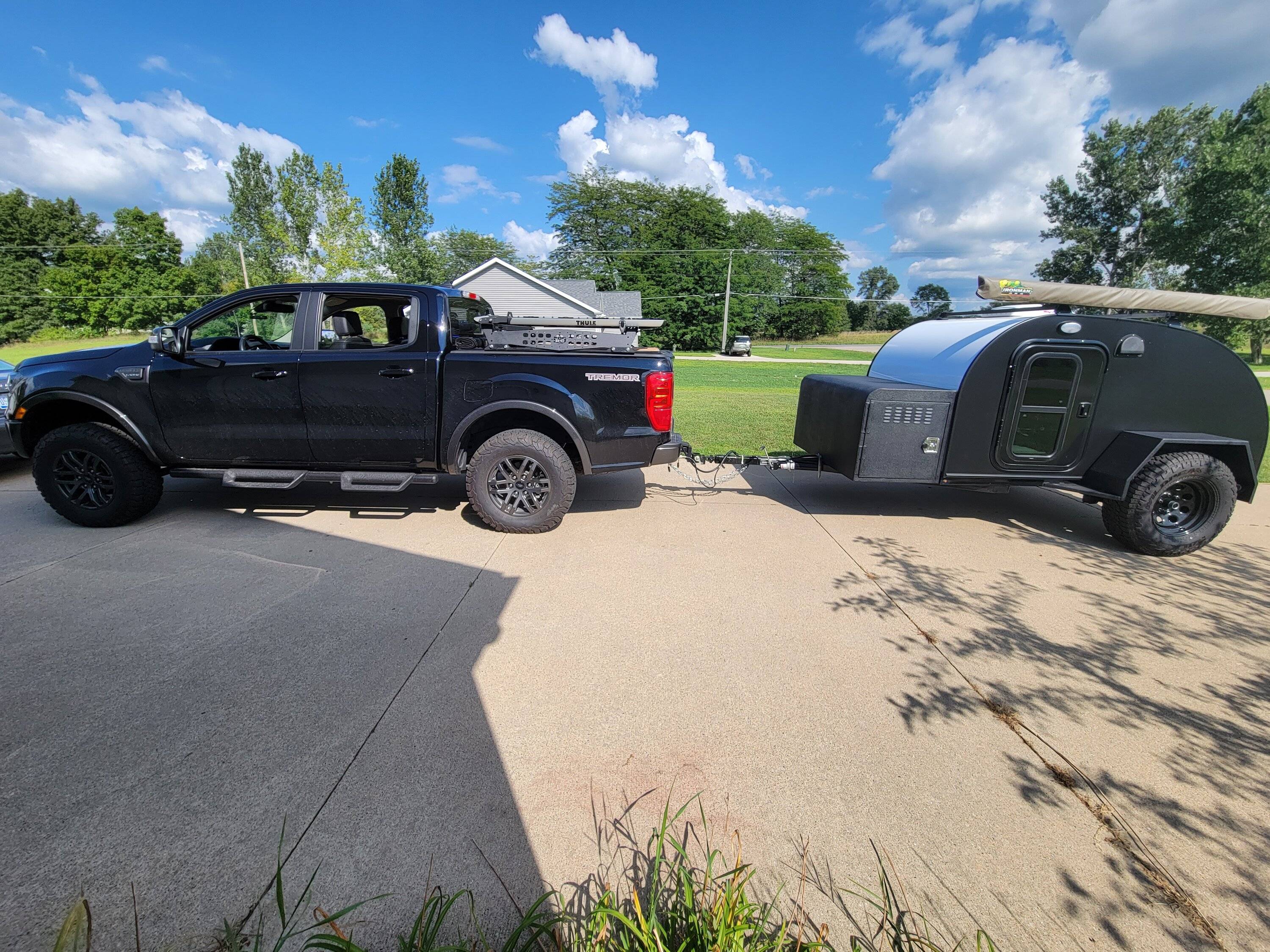

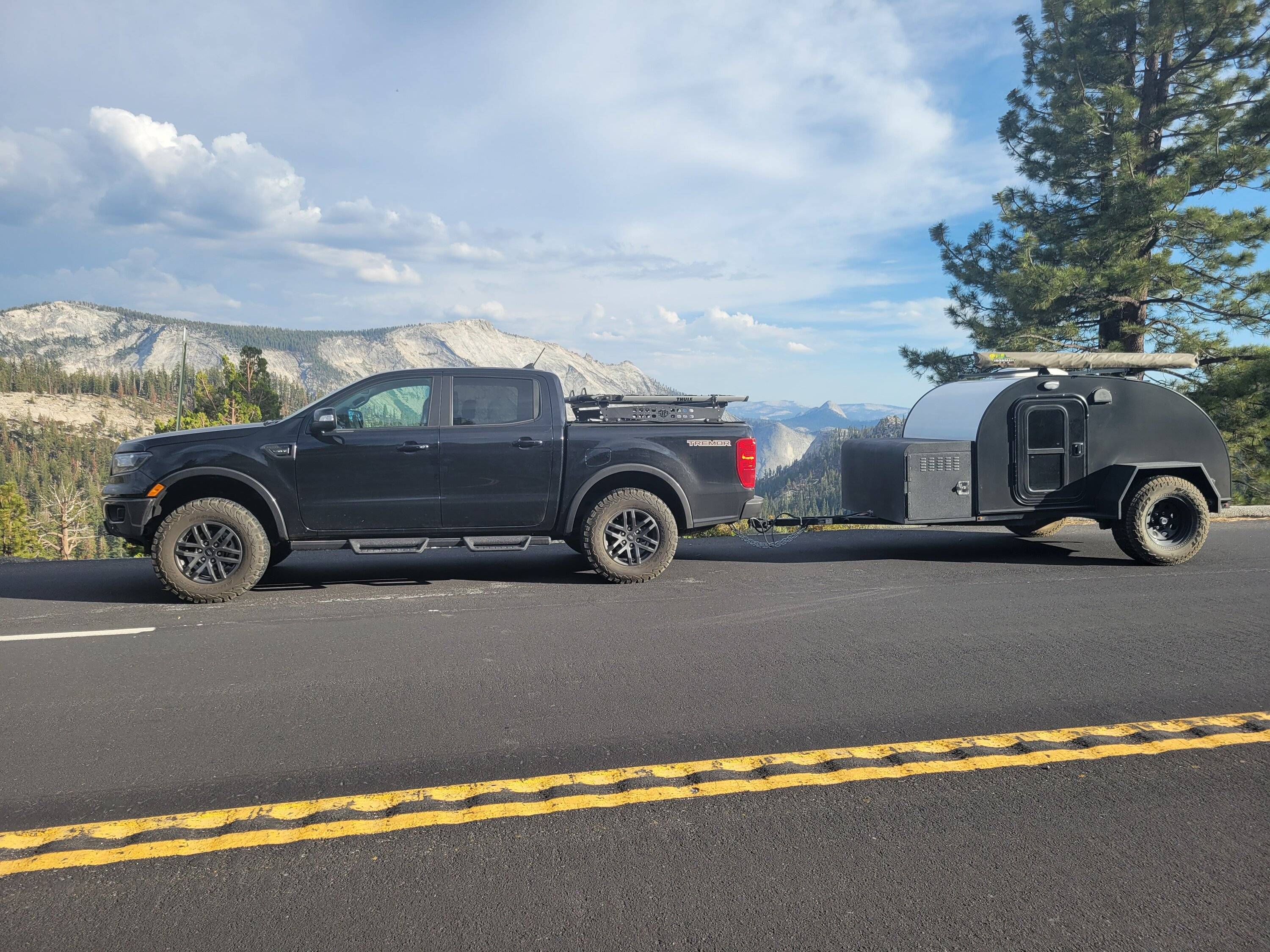

Apologies that I did not come back with an update. Yes, we made the trip just great! The truck rode REALLY well, and did not sag substantially under the tongue weight of the trailer. When I've hauled something heavy like this in the past it was obvious that the truck was essentially just sitting on the bump stops. Now it feels much more ... "planted"? Less harsh? There is still obviously more range of motion in the rear suspension. The ride was comfortable and predictable.
Here are a few pictures from the trip:
