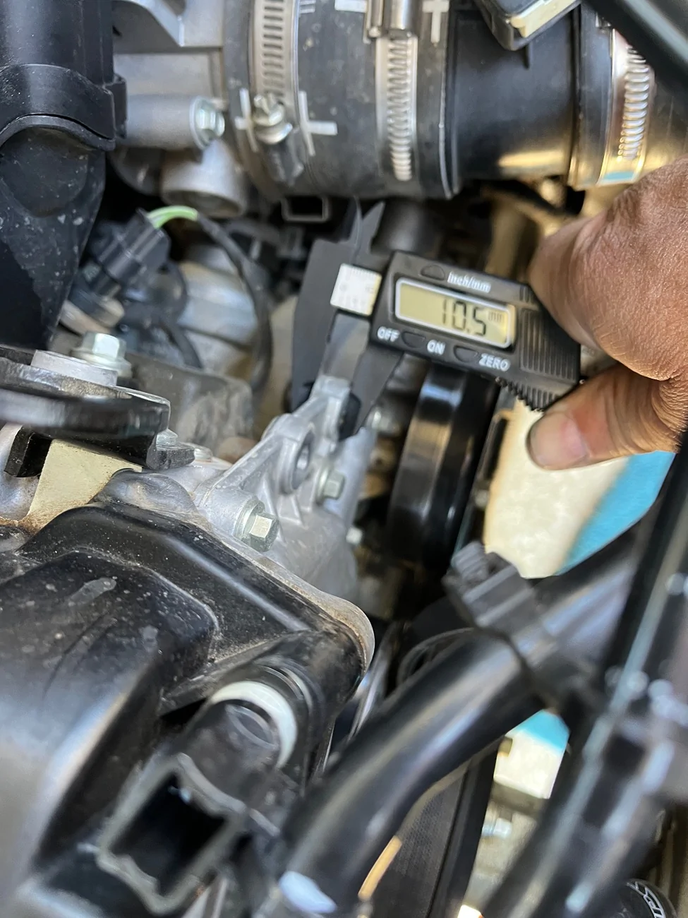

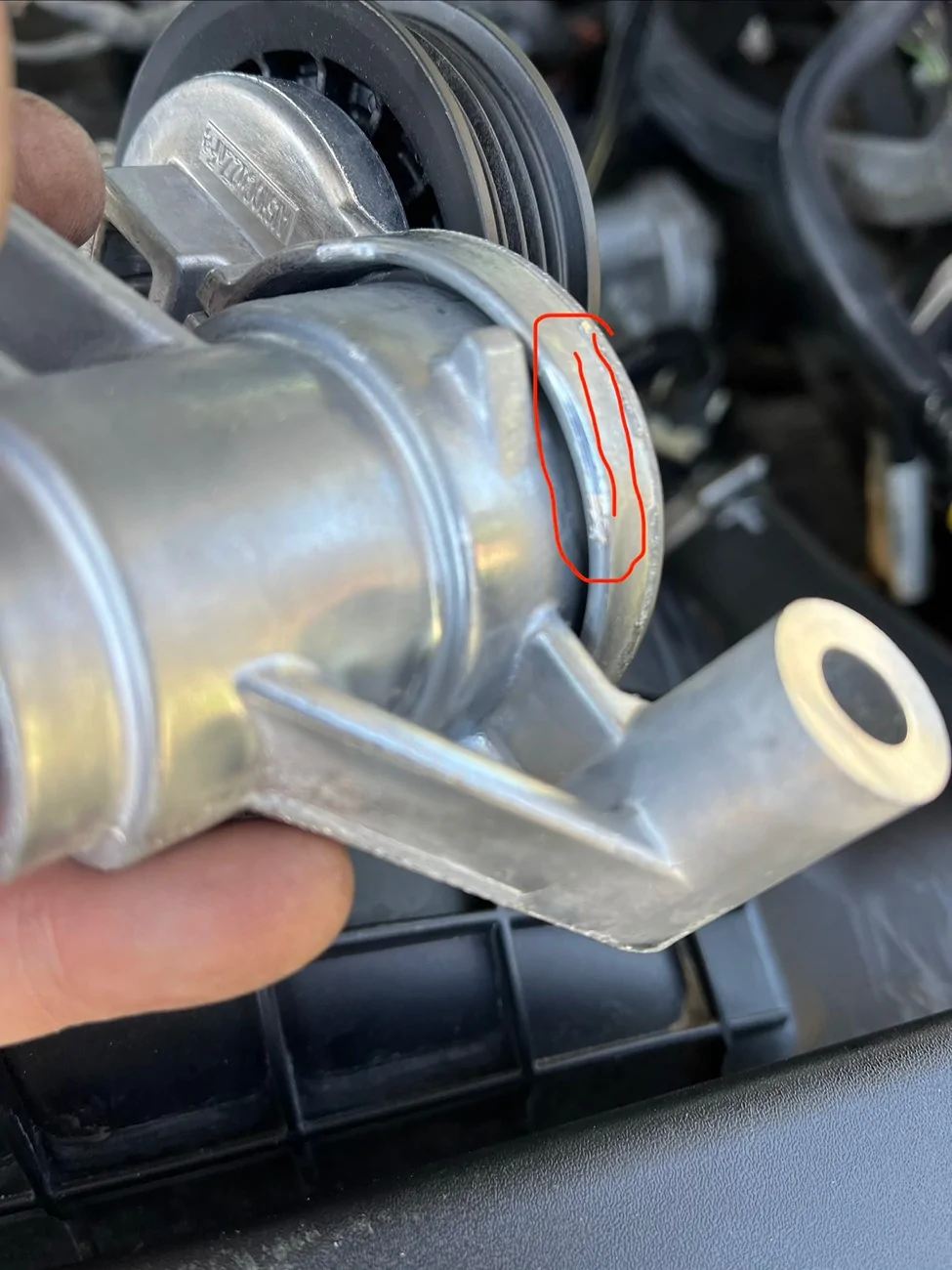

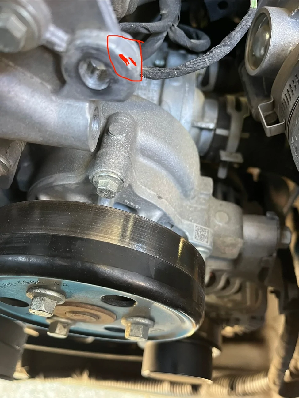

So got my bolts and my Motorcraft BT114. Went to install and ran into a snag on my 2022. It mounted up ok to the block. But when I went to untension it to install the belt the was no tension. Where ever I moved the tensioner it stayed and wouldn’t spring back. Thought the tensioner was defective and removed it. Once I got it off I found this. The back of the housing on the tensioner was making contact with the lower mounting boss for the original tensioner. Not very much but enough to create a drag. I’m thinking that my 2022 may have the “beefed” up cover? Add a picture showing the thickness of the mounting boss. Put the original back on and deciding whether to do a bit of grinding on the new tensioner or the mounting boss. But I don’t really want to grind on the boss because you know how Ford can be. Interested in if you run into this when you do yours.

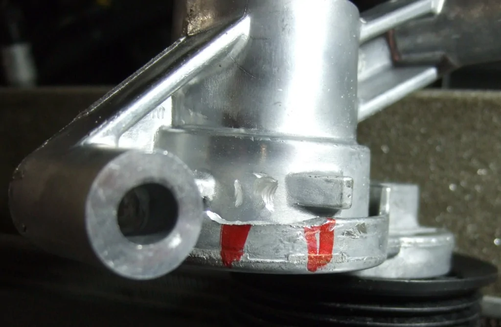

The pulley geometry and belt alignment is identical to the Ranger part. But I did I have the same binding issue as Stevedbvik1. I resolved it with a dremel tool in about 5 minutes.
I chose to only remove enough length to give it ~2"- 3" of free movement. I left enough to assist me installing the belt by leaving a small section that still binds at the closest point of range. This allows me to move the tensioner fully counterclockwise, and basically park it while I install the belt, then pull it back clockwise into position where it functions normally.
