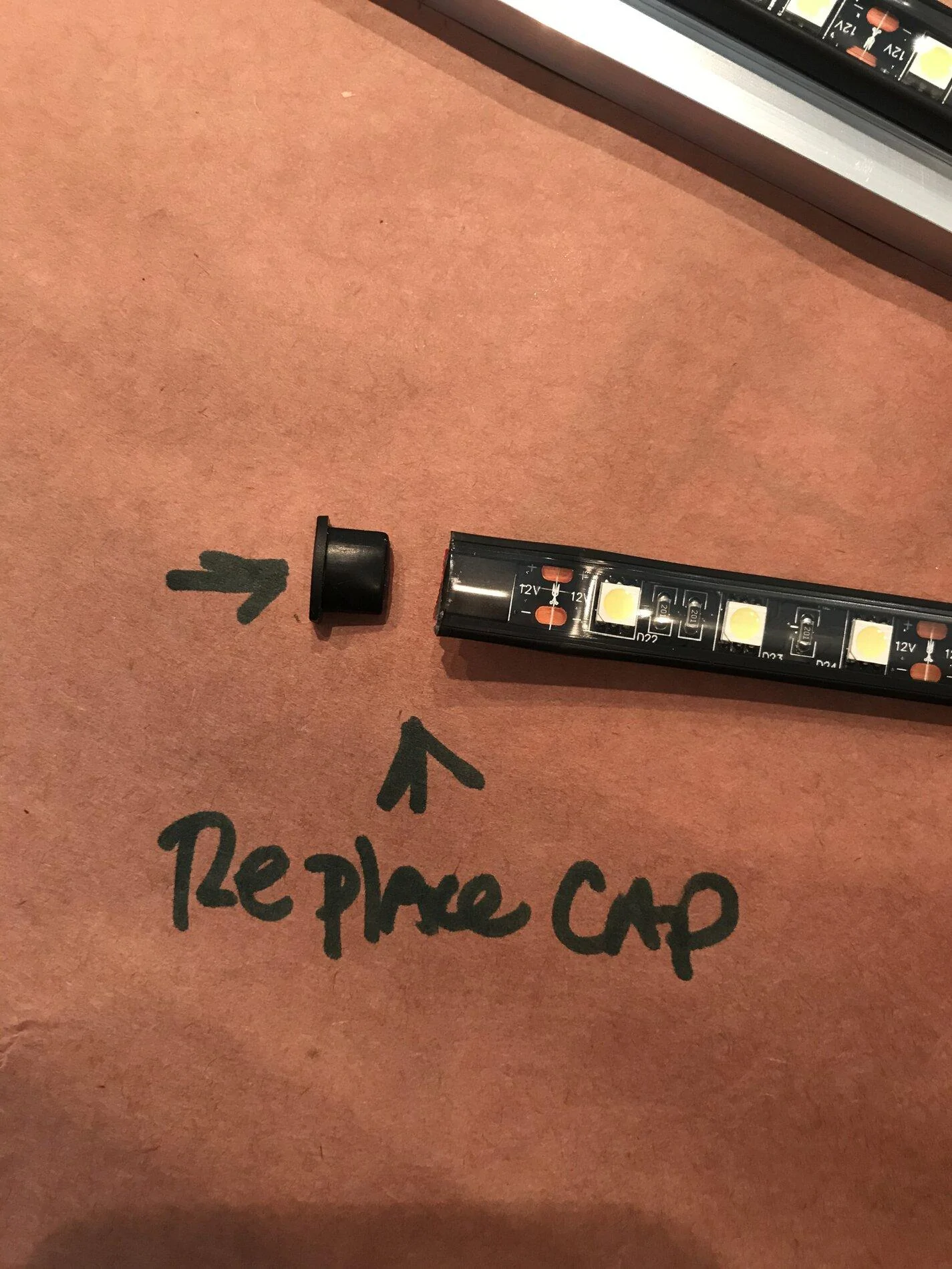

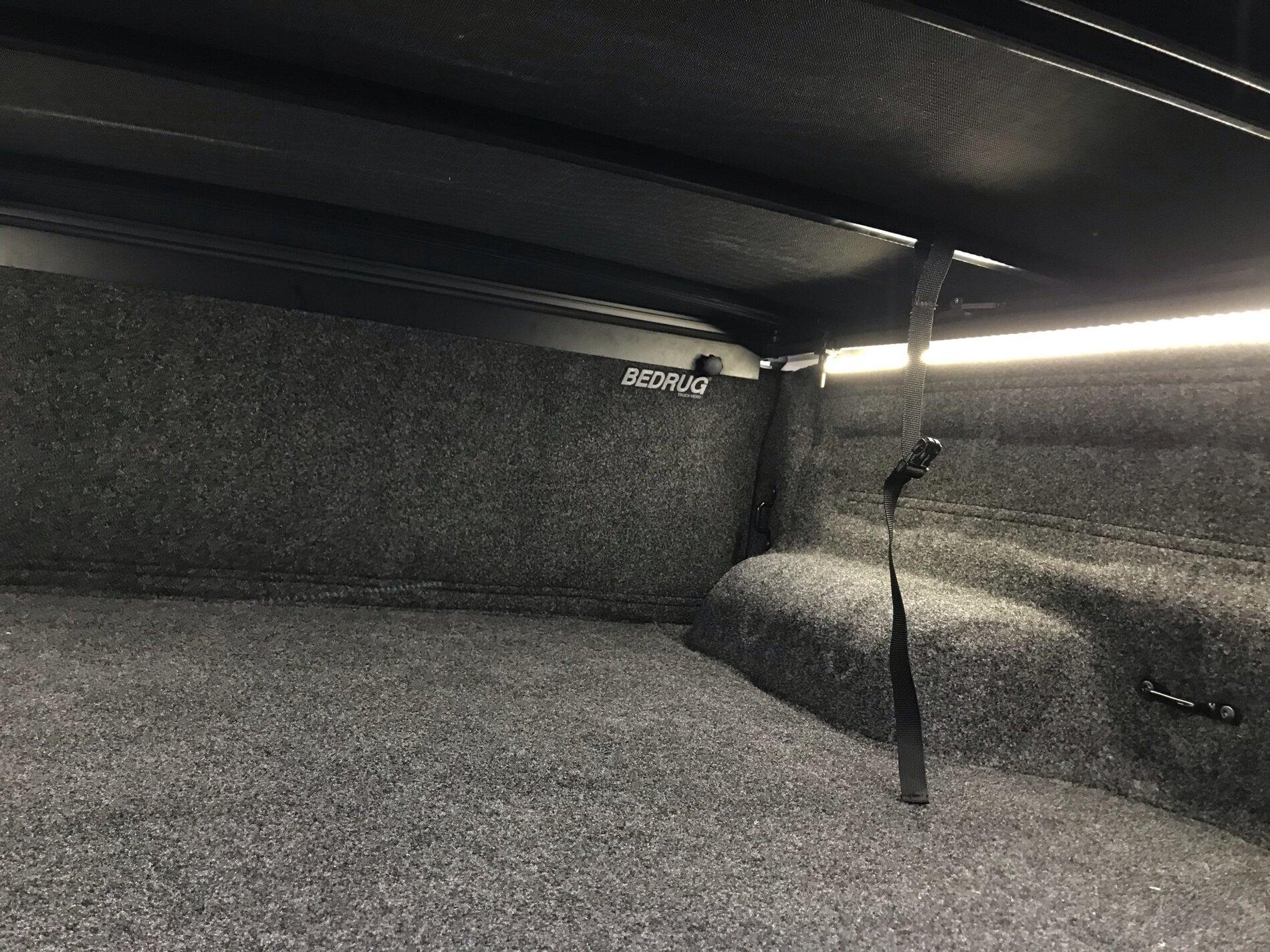

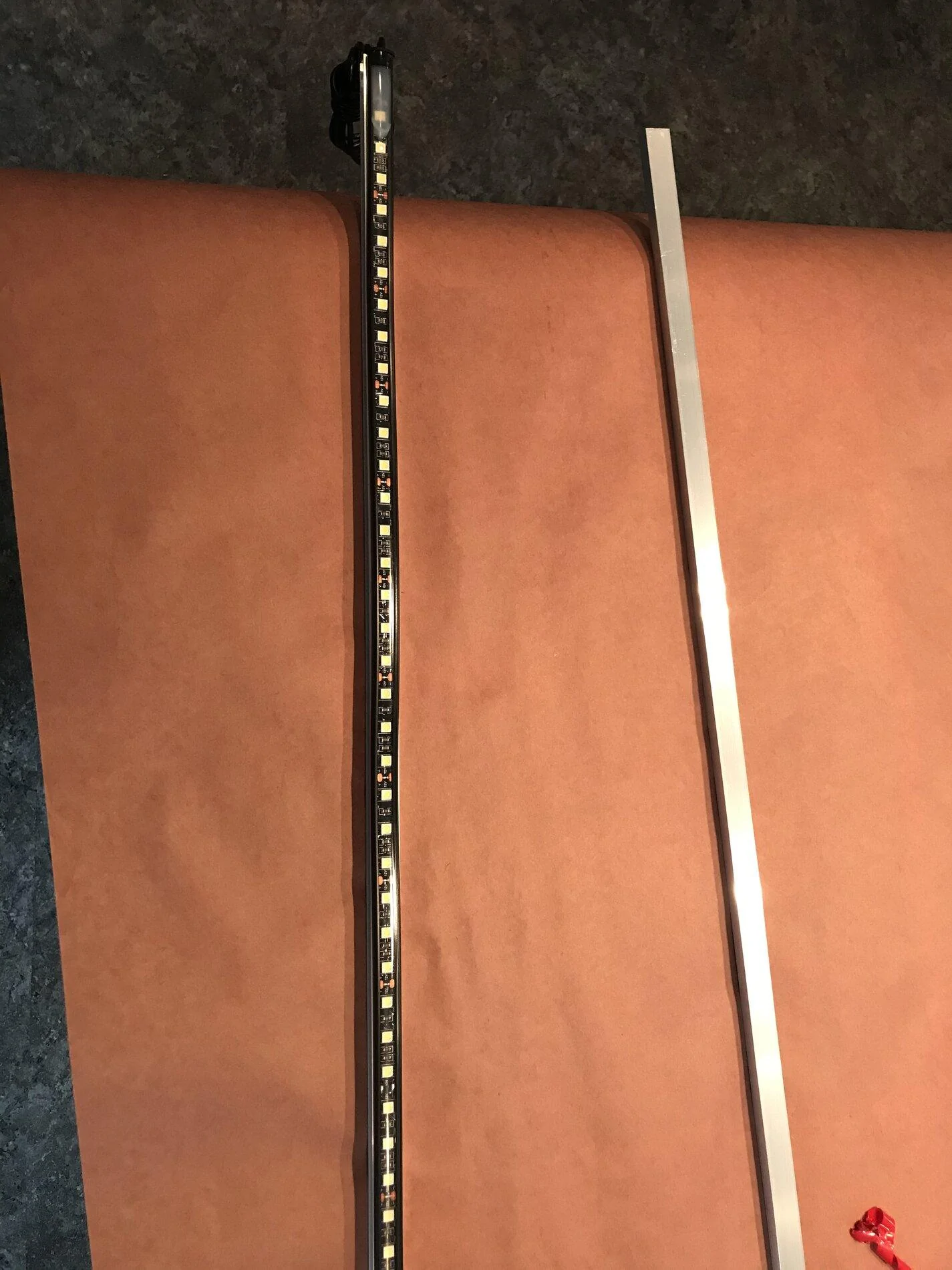

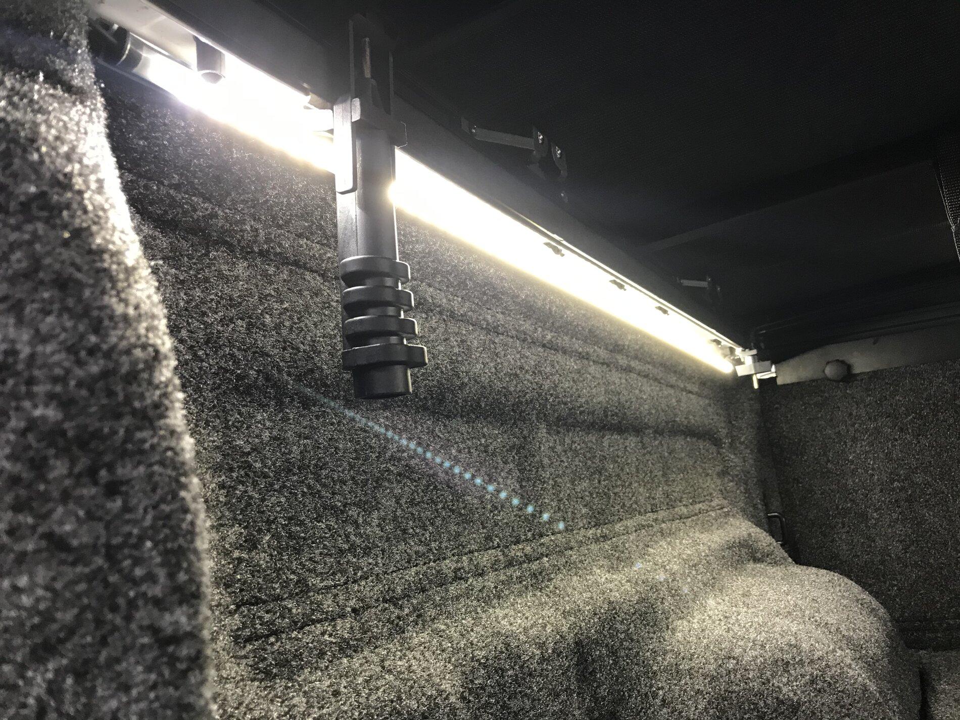

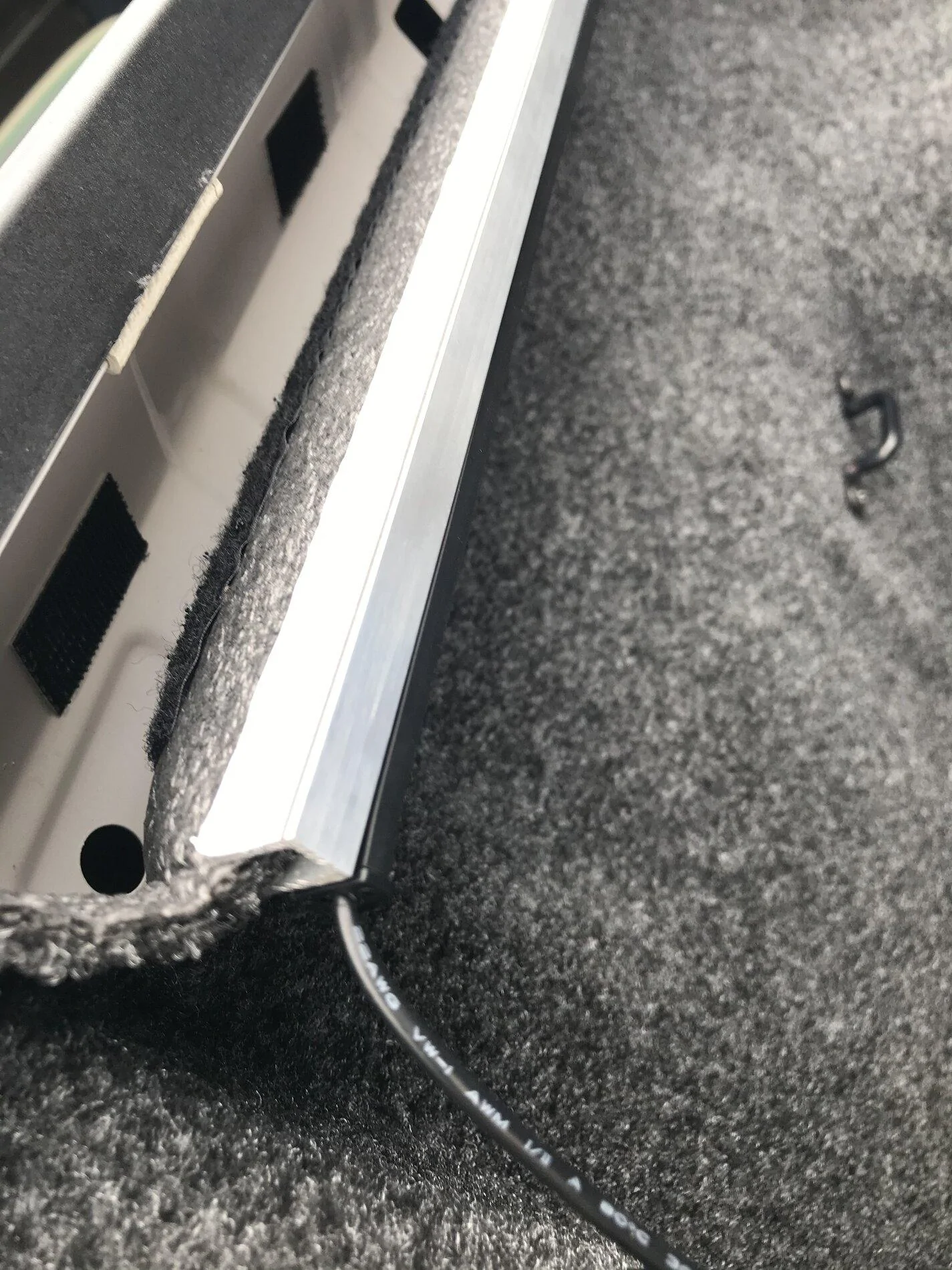

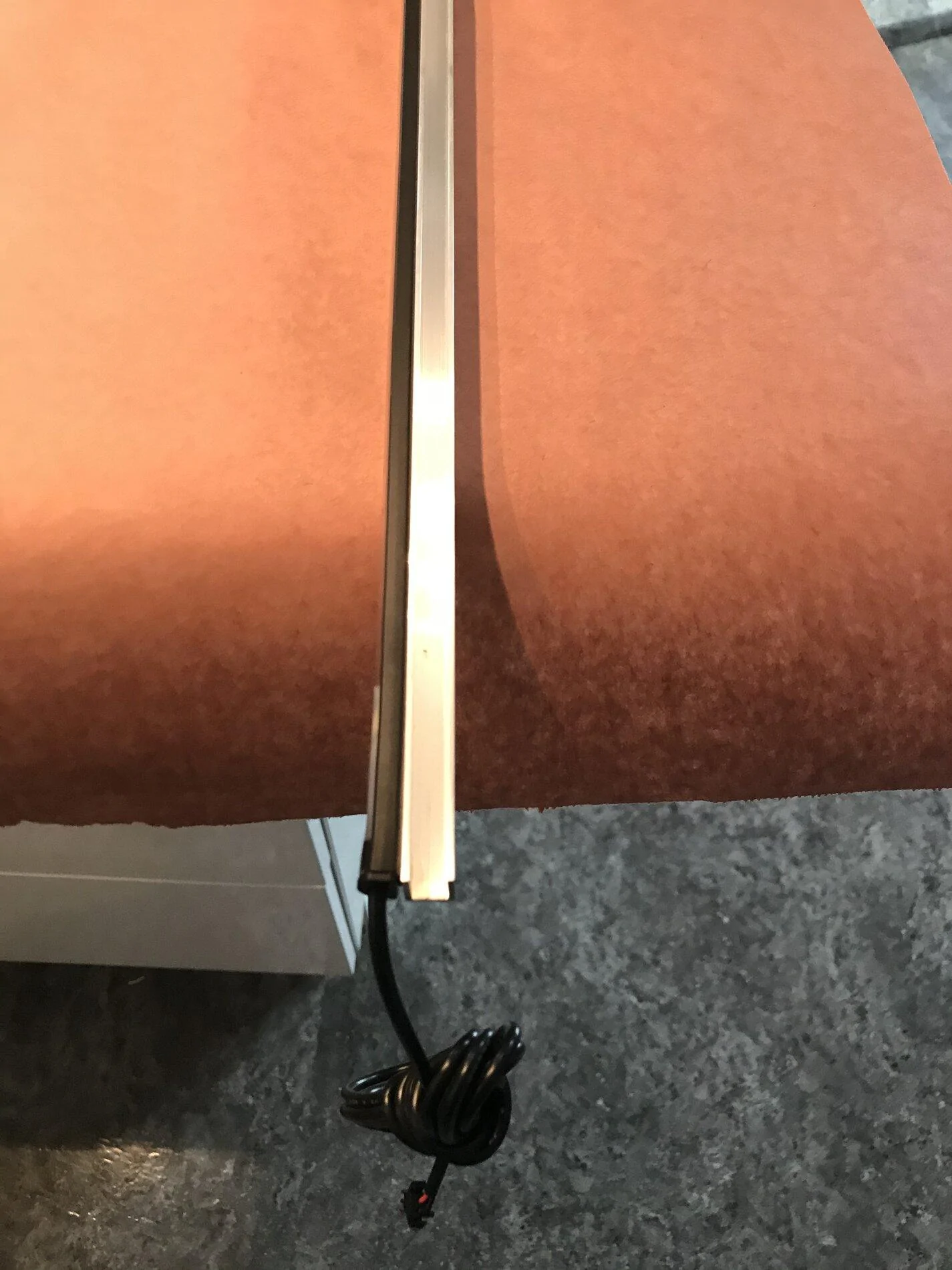

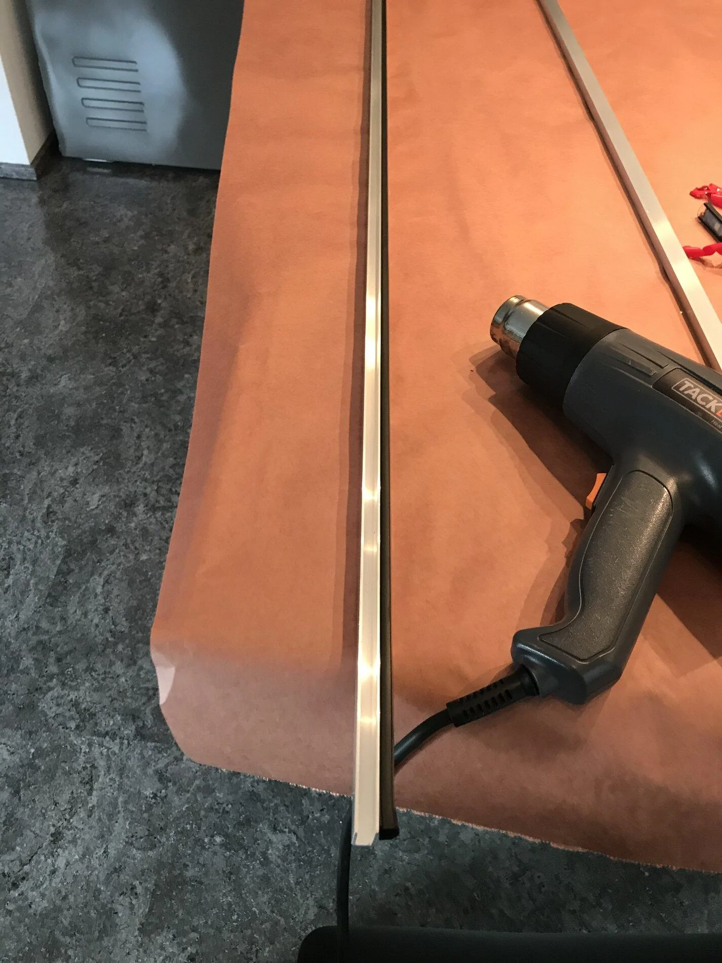

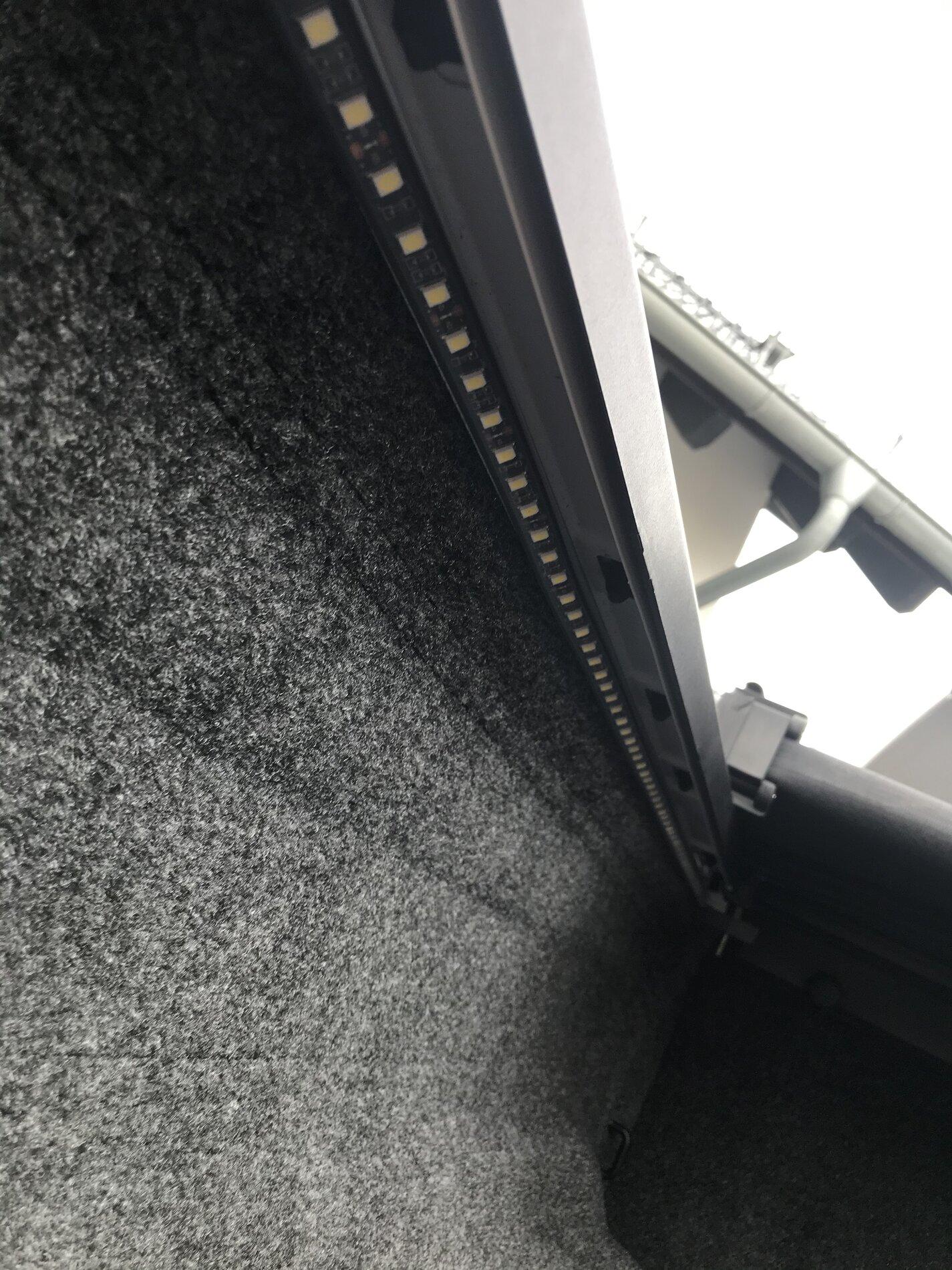

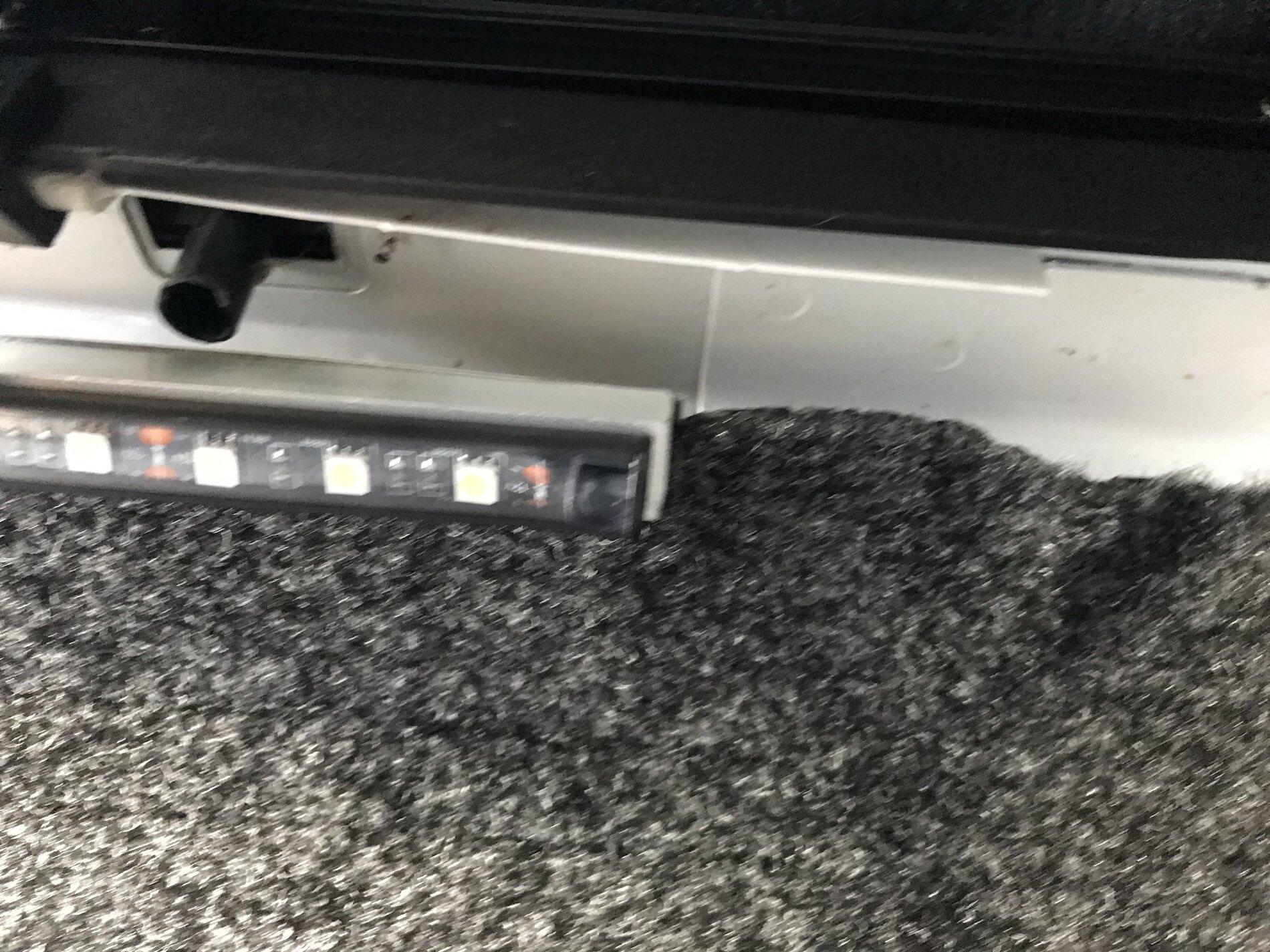

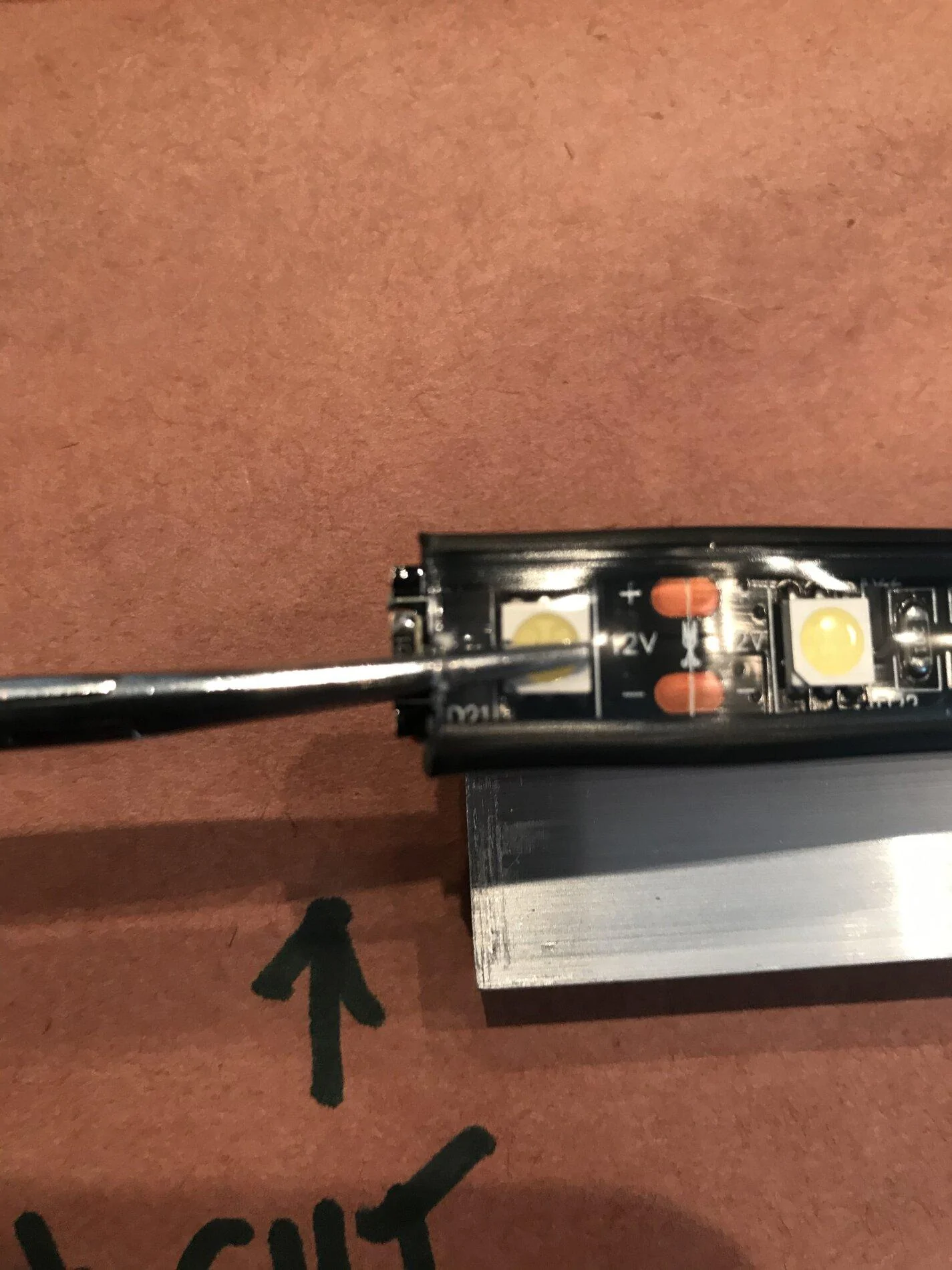

Here is what I did, I used aluminum channel, a set of NiLight LED strips and good quality 3M tape. I have a BedRug and the aluminum profile fit right over the edge of the BedRug and lays perfectly along the flat angle of the upper inner bed wall. I used the switch that came with them and mounted it up under the rail.
I tied into the power at the plug under the bedside.

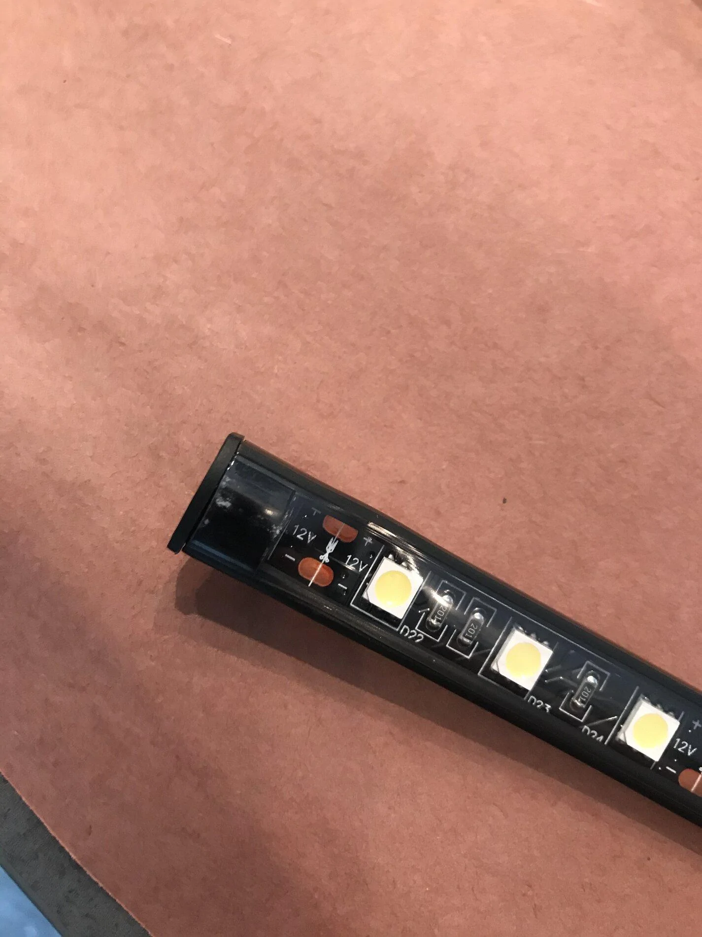

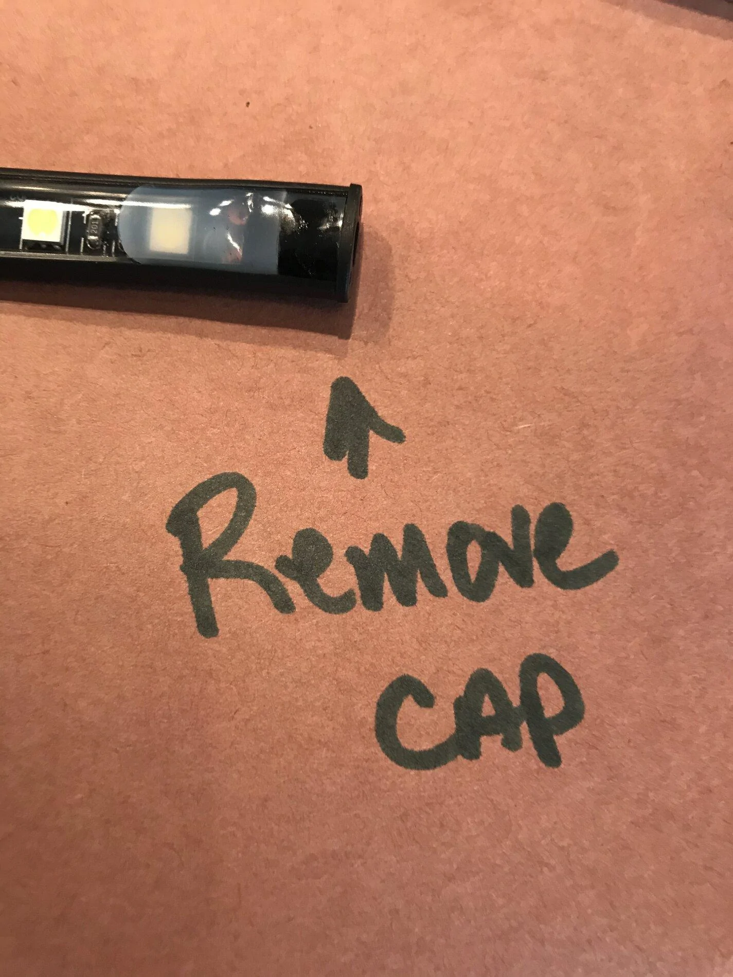

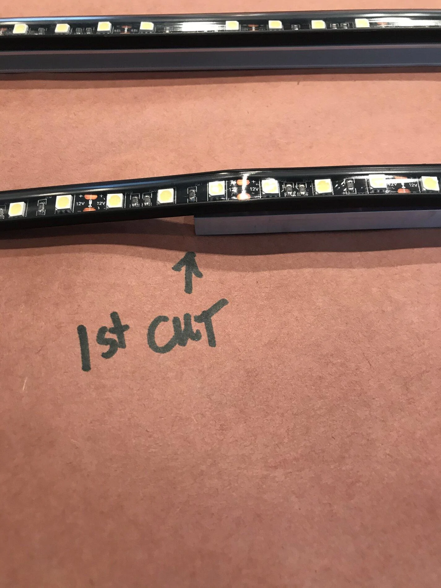

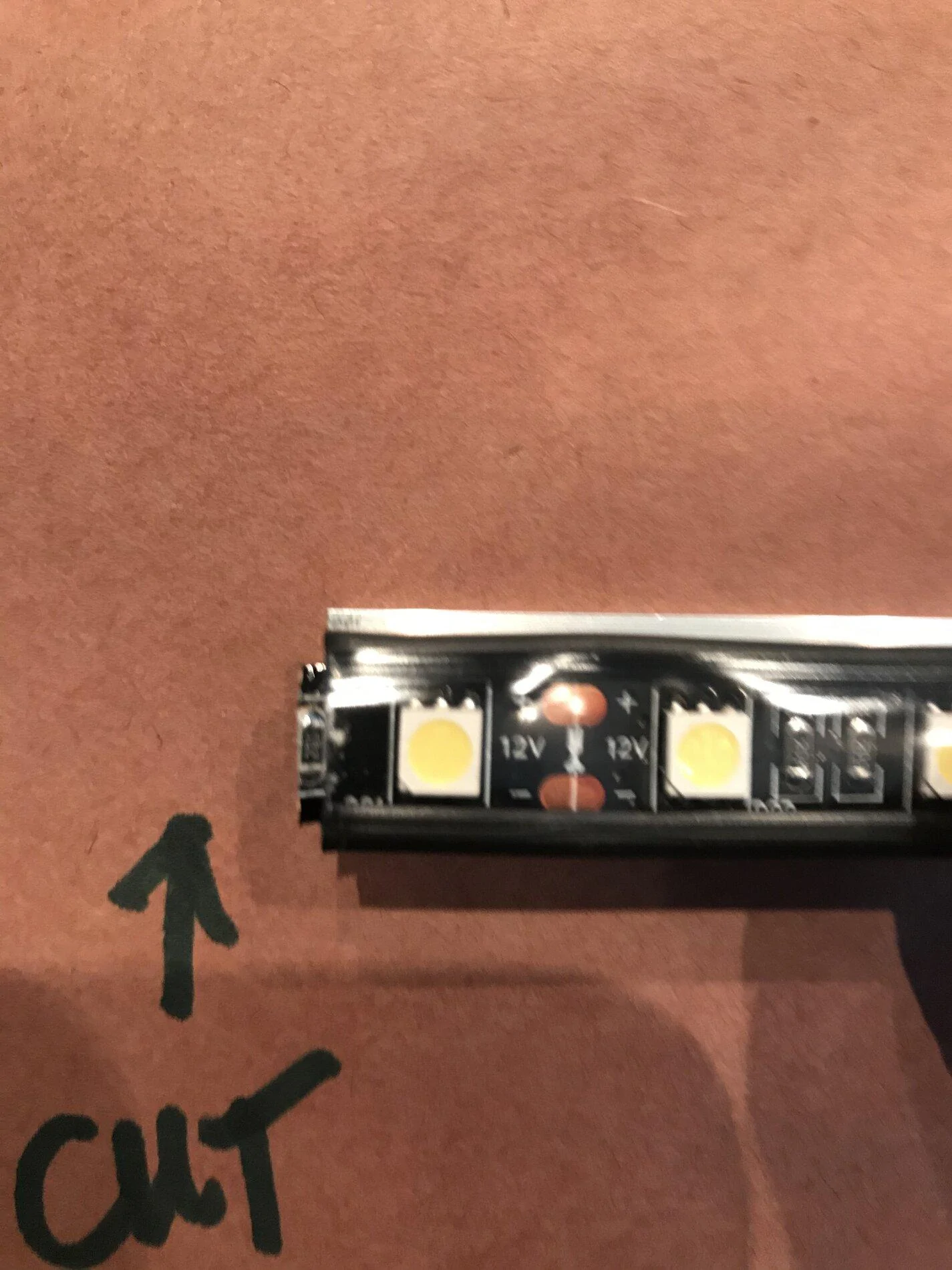

Just an FYI, pic #3 is me using hemostats to pull the LED strip down a bit in the casing to cut it close to the ✂ mark to cut it. You can pull it out enough to do this.
Really nice job - I used the same LEDs and it did not even dawn on me to cut the LED strip! Really well thought thru Dana!

Thanks, I had the lights for a month hemming and hawing over the best way to install them. I think attaching them to some aluminum profile whether flat, angle or channel is the best way. I am OCD so if they aren’t straight and perfect it would kill me.
Good quality 3M tape and prep is the key.
