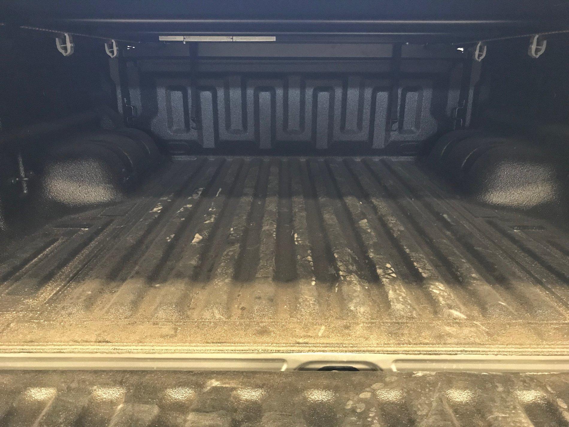

Ok, got the ACCESS 39" ones in and had a buddy at work help me wire them into the 12V Outlet Bed feed that I'll never install, power always on so just have to be careful not to leave them on. UPDATE: actually the power to that 12V outlet turns off. Same as the 2 - 12V ports in the dash so my cellphone booster can be left on and I don't have to worry about battery drain.

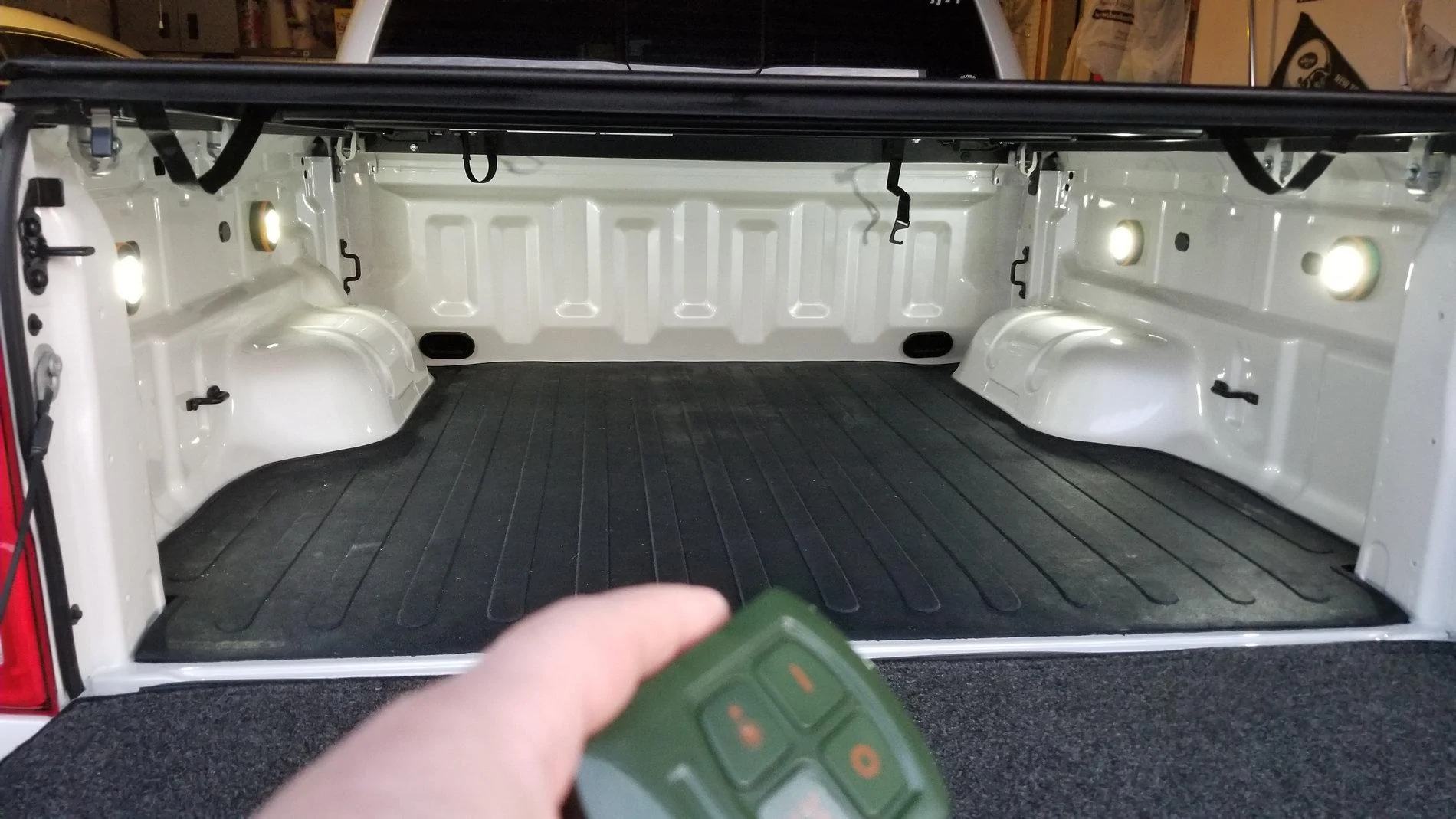

Just put them in today...Excellent bargain and as an option one or all can be removed to light up anything as they attach magnetically. Best $12 I ever spent. Some of us don't need permanent setups for bed lighting. Just keep it simple.

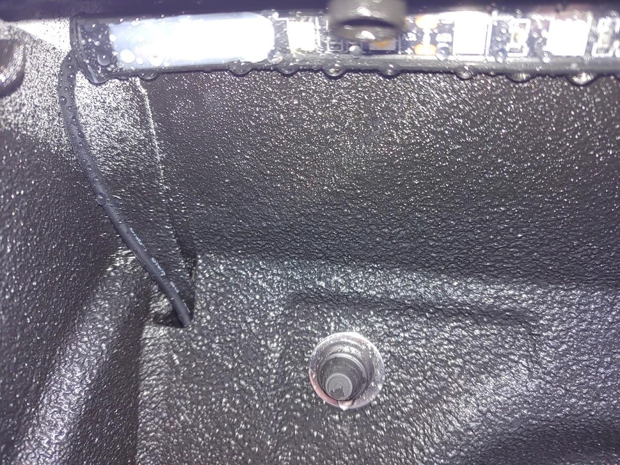

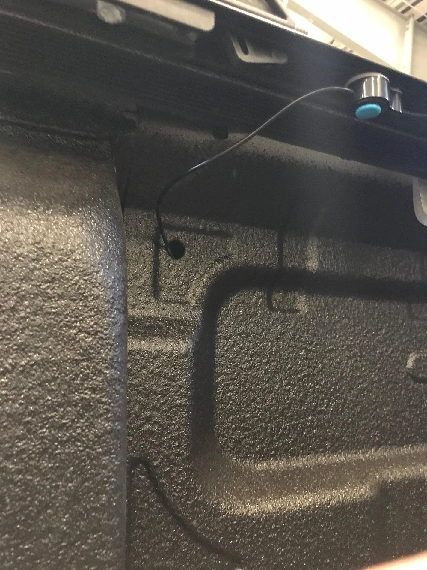

Kept all the wires out of the bed.

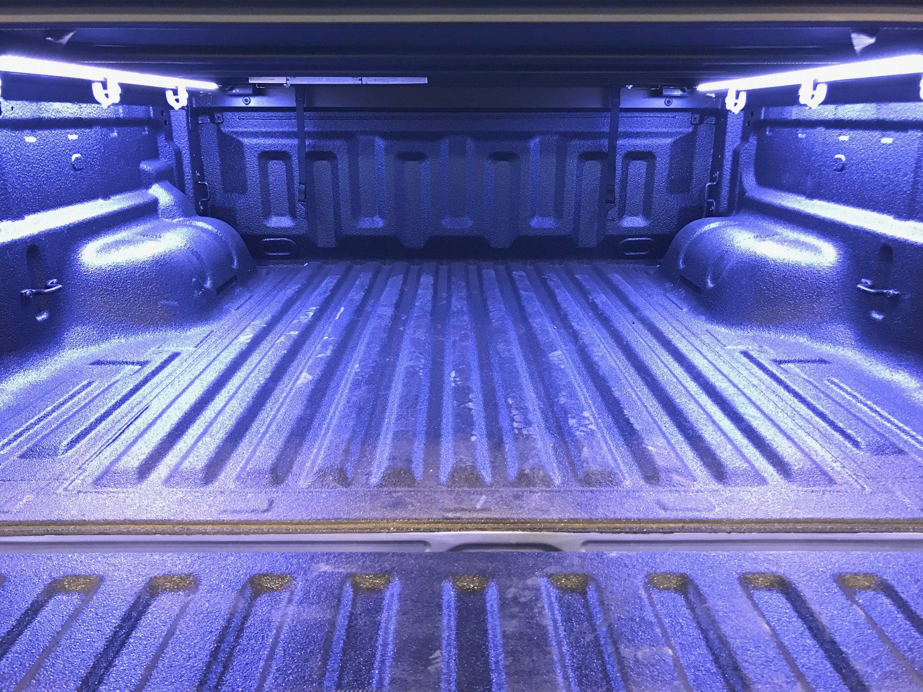

Routed the power thru a sheet metal opening. The connector just fit!

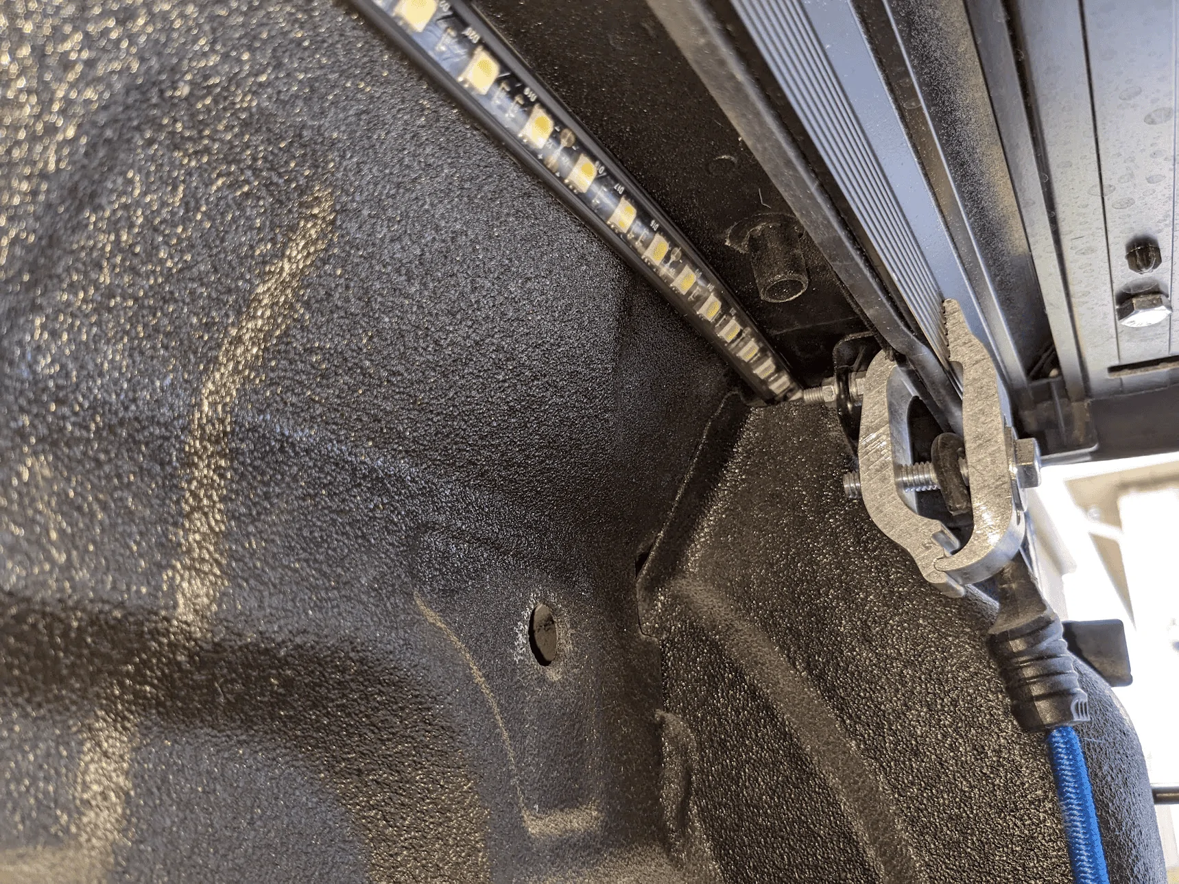

I just installed the same LED strips but wasn't able to fit the connector down that hole, and the strips were too long unless cut, but I ended up finding a different path to run them that helped with both problems. I removed the taillights and fed the strips up through a crack at the top behind the tail lights:
The excess strip is hidden behind the tail light and the wiring drops down into the same place that the tail light wiring goes. No visible wires and no cutting of the strips.
The most difficult part of the project was connecting the splitter to the Wolf Haus pigtail. I ended up cutting the inline fuse off of the splitter so that I could feed it into the round hole from within the bed, leaving the button in the bed and everything else hidden. Also had to add extra wire between the splitter and the Wolf Haus pigtail in order to connect them together from under the truck, as I couldn't reach up high enough to connect them to each other at the shorter lengths that they were.

Installed with 3M tape ? Does that stick well to spray-in liner ?
3M make a adhesive primer. I used that on the bed liner and mine are still in place

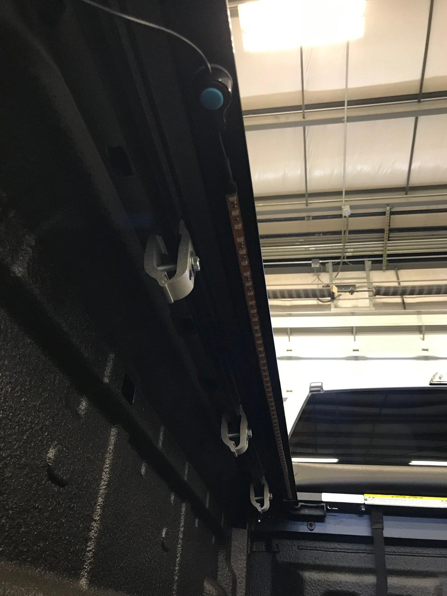

Looks like the ideal location so the lights don't shine in your face.
Some light strips can be cut to desired length.
These can be cut down but there's silcone or something in the end to help keep the water out which I would have to replace and didn't feel like getting into.
I used whatever adhesive tape was on the lights. I'll be surprised if it holds onto the spray-in liner for long.
I've had mines in for over 2 years now and they're still as stuck as the first day. I'm actually impressed because I was ready to drill and screw some mounting tabs as it starts to fall off. I got my spray in liner done at a shop so I can't speak for oem.
I have a tonneau cover but since the lights are tucked beneath the rails it shouldn't get direct sunlight or much water without one.

Well that's good news. Hopefully mine sticks to the OEM liner just as well. I wiped it down with alcohol first, and it was pretty clean before even that.
