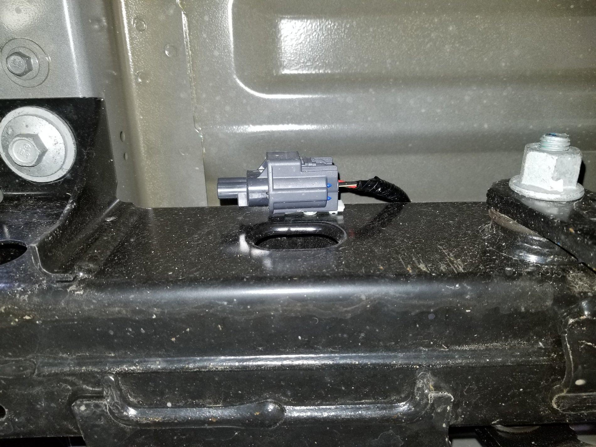

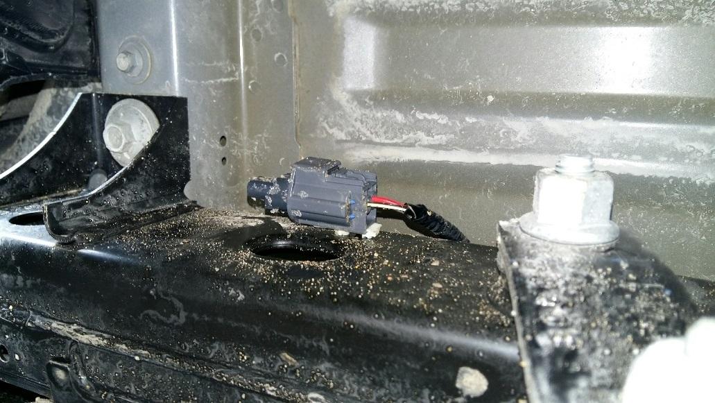

Was crawling around and discovered an unused plug on the bottom of the frame right in front of the taillight area.. maybe this is it?
Should test it for power and see when and what it has available.
That's actually for the 12v power outlet option in the bed.
Thats funny, I was under there today as well, but i was looking for the bed power plug. I was gonna test it but laying in the snow got old quick. Might think about running my own bed power from it.
