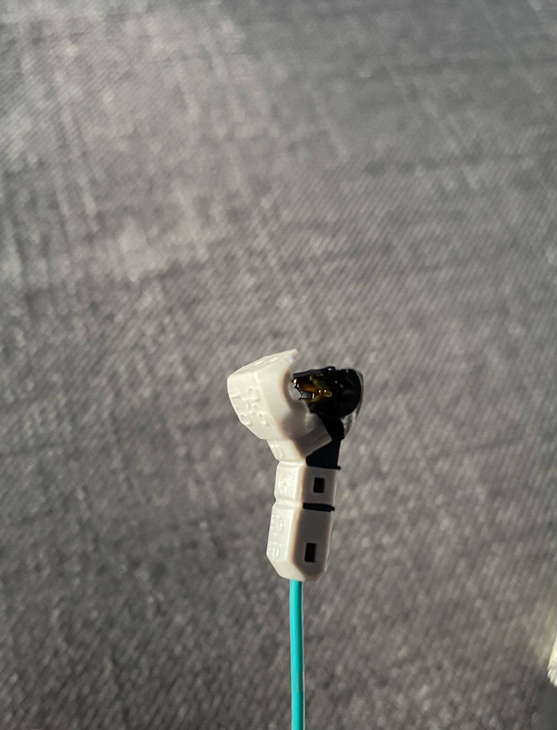

Have you seen the BAMF connector that RedTek includes? Apparently you cannot solder in a vehicle anymore. So I’m not sure this is altogether a terrible alternative. No, I would not use this if exposed to the elements.
That's just a glorified t-tap. Throw it in the garbage.
