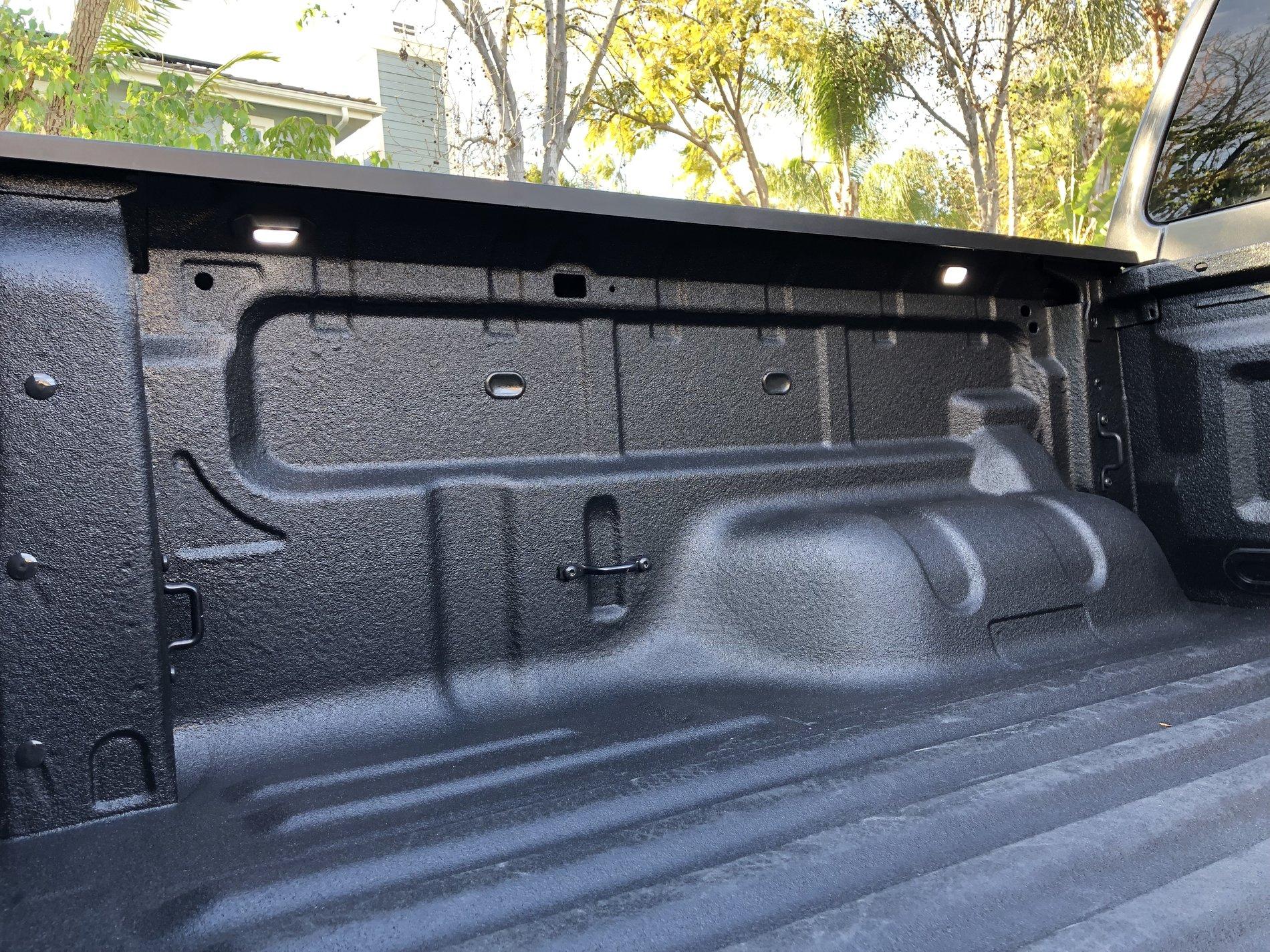

19 Ranger Lariat FX4 Crew Magnetic
Installed the Ford Touchlink LED bed lighting today. They are wired completely independent of any other lighting (basically the long harness it comes with ties to the battery). All 4 lights are switched on and off simultaneously by pressing and holding any of the 4 light lenses. I opted to find my own mounting locations up under the rail lip on the 45 degree plane. The recomended locations are too exposed and im sure they would get busted up by cargo in no time. BTW there is drilling and hole hogging involved. If your the type that cringes at the thought of drilling into your new truck then this kit is not for you.

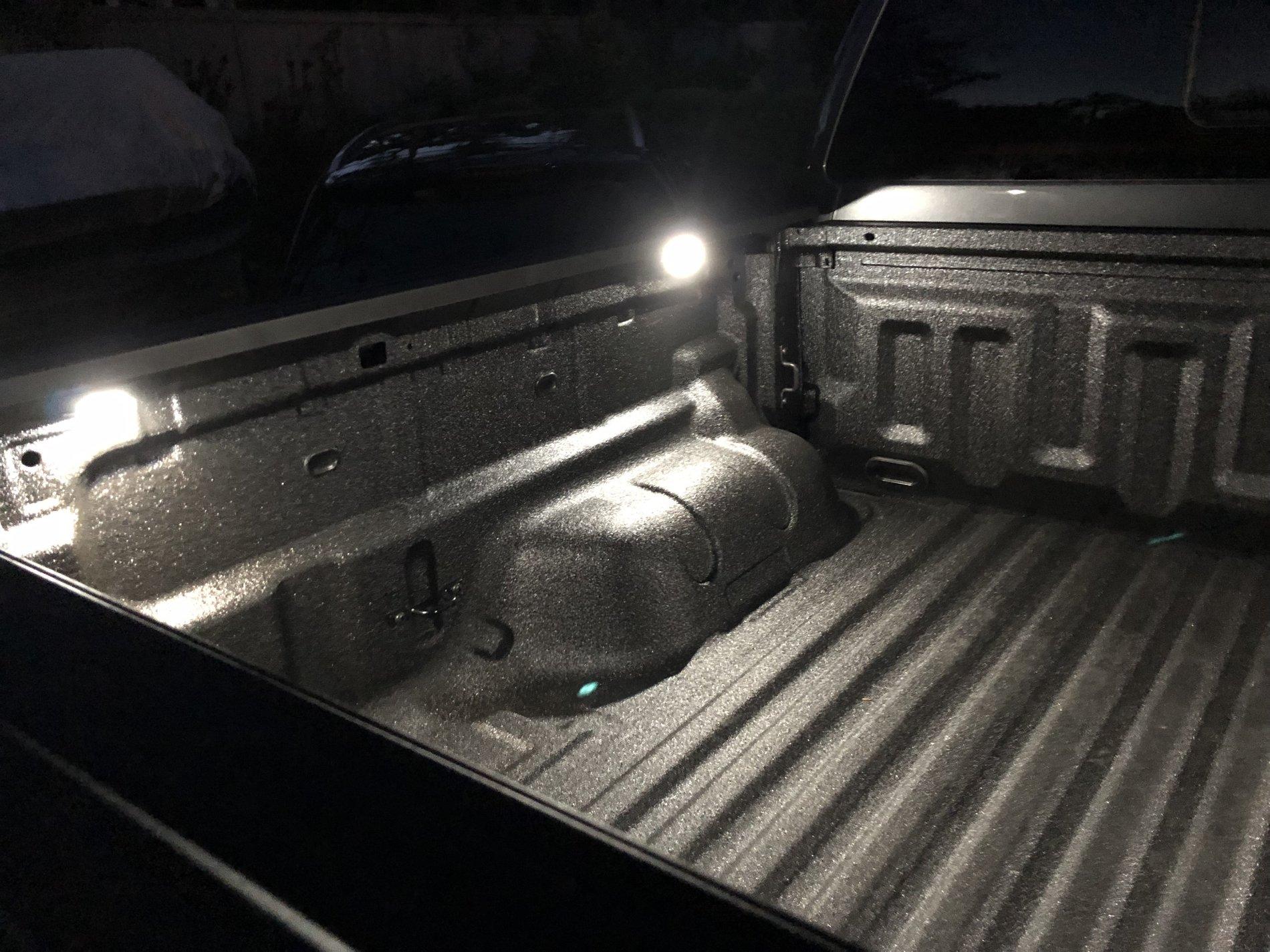

I'll find out for sure when summer comes to Texas. At worse, I'm out $30. I ended up buying this one https://www.amazon.com/gp/product/B013EGCP7M/ref=ppx_yo_dt_b_asin_title_o01_s00?ie=UTF8&psc=1
I installed it earlier today. It works OK. If it holds up, I'll probably get another one for the other side. The sensor doesn't always "see' motion, but a swipe of my hand past it lights it up. Some of the negative reviews were about the tape not sticking well. I used the tape that came with it and it it doesn't hold up, I'll use some good 3M double sticky. Here are some pics I took tonight...
