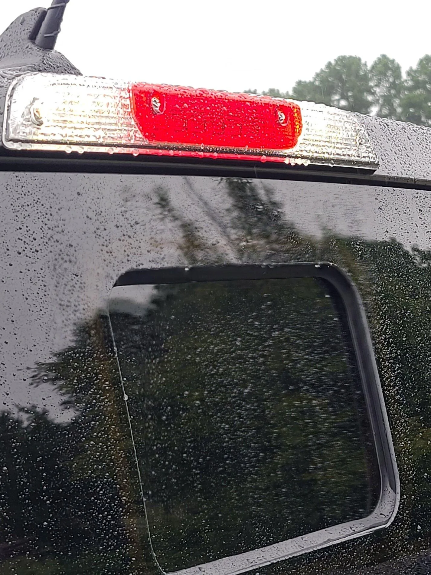

it turns on the light over the bed, the third brake light/bed light.
Mine does nothing. You would think it illuminate on the dash when you push the button like when the headlights are on.

Can you post a picture of the lights you are referring to?
Ford offers an option for bed lights you turn on by touching. I think we are talking about two different things though.
Yeah, are we talking the white lights on either side of the high mounted brake light or lights in the actual bed of the truck. The ones by the brake light are the ones controlled by the button on the dash. I took the bulbs out of mine because I didn't like them coming on every time the doors were opened and needing to time out when you closed them. Kind of annoying in a campground. The ones in the bed are the optional ones. I don't have them on mine so I can't help there.
If it's the ones by the brake light it could be bad bulbs or a fuse. The other question would be was the Ford Trailer brake Controller installed? If so were the connections done correctly at the CHMSL and is the brake light and controller working properly? Could possibly be a loose connector at the light also.

So the button does nothing?
The button commands the white lights in your third(high mount) brake light to turn on. If it isnt turning on what so ever then you need to go to the dealer.
So I guess in this picture the 2 spots at the bottom are where the optional bed light would go? Which option pa
The lights come on when I open the door but the button does nothing. If I push it the lights are still on. Btw what option package is the inside bed lights if it is infact an option?
The lights for inside the bed themselves are an additional option accessory from Ford. I myself have added it to my truck and be aware you have to drill holes in the bed to make it work
