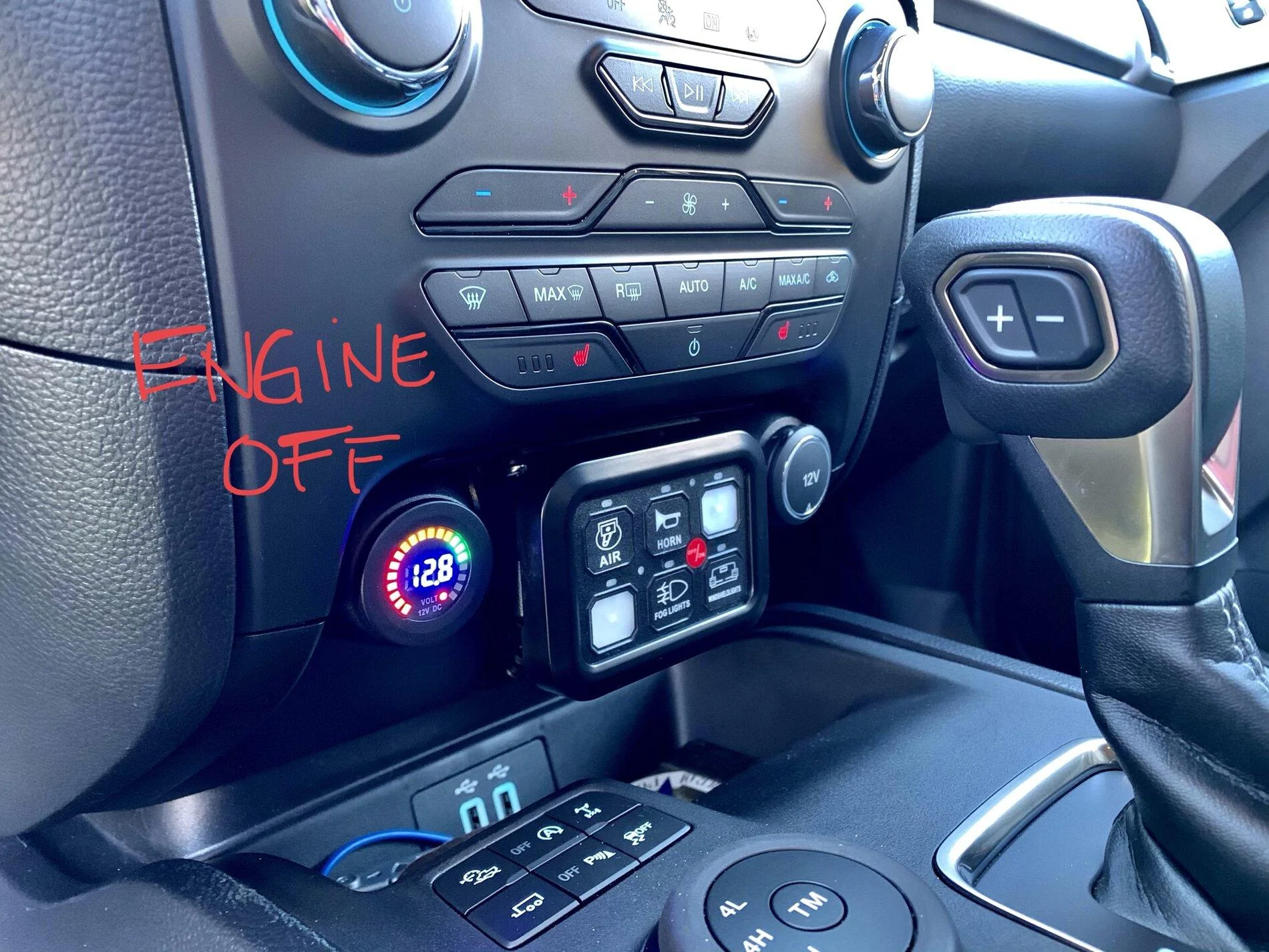

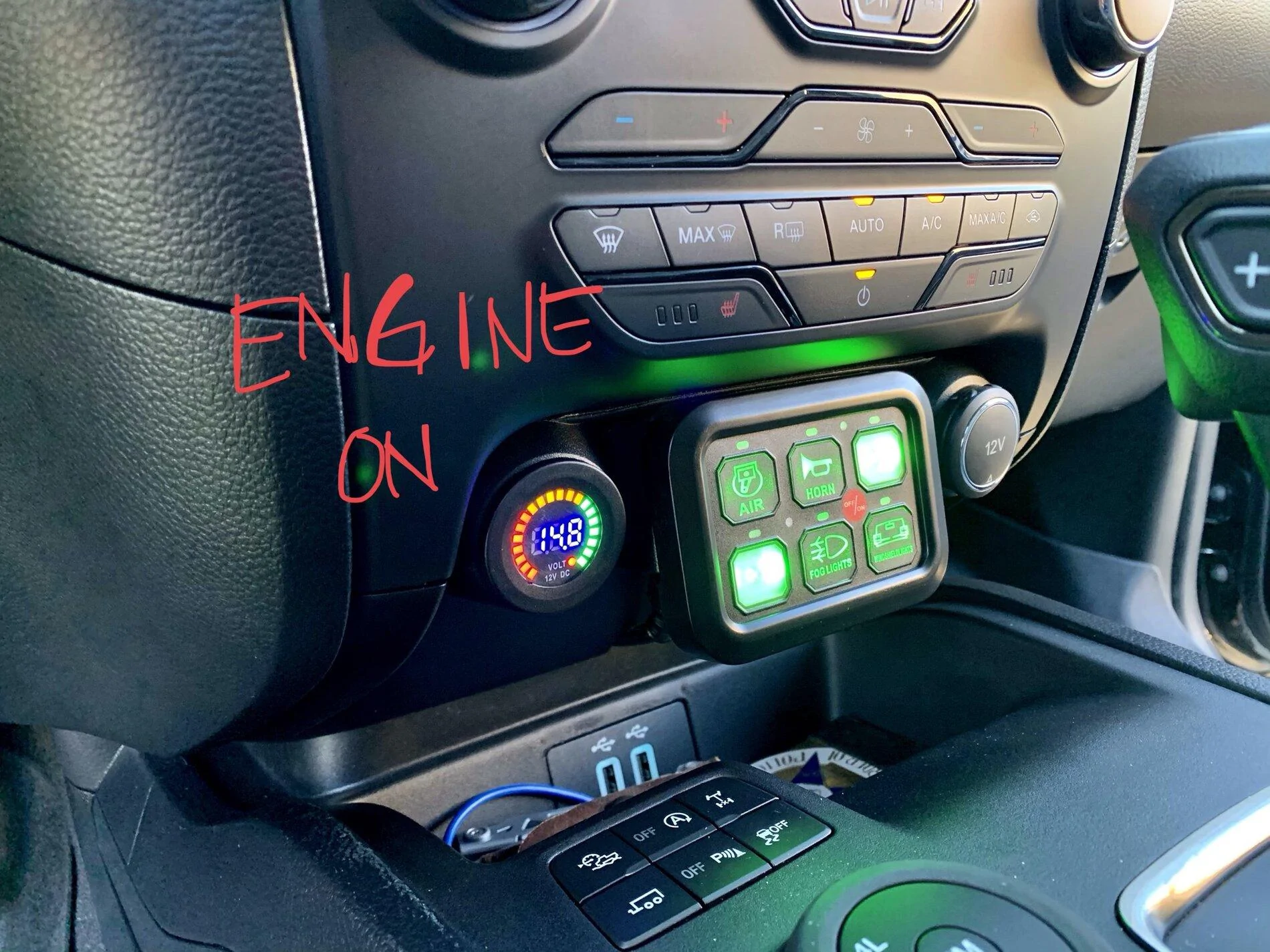

I also installed a voltmeter (replaced one of the 12v power port)
At startup (for a few seconds, but less than a minute) it will
blink and read 15.6 volts.
Then after that, with engine running it shows between 13.8 to 14.8 v
(driving around and depending on auxliary lights/12v accessories I have on)
When I shut off the engine, it reads between 12.6-12.8 volts.
I’m pretty sure the alternator is working as it should, and this little Voltmeter lets me keep an eye on the battery.

I’m happy with mine. I like how the color around it also corresponds to the Voltage, ( red, yellow, green)
Just to let you know...at start up, the voltmeter would blink and display higher voltage(around 15+ volts). Then go to normal mode after a few seconds.
I believe this is when the Rangers battery is getting an initial dose of the charge current from the Alternator.
Also, when you shut down your engine, the voltmeter stays On for a few more minutes. (its led so it doesn‘t consume much battery power)
This is normal and will shut down on its own. I think its because it’s tied to the Accessory setting.
